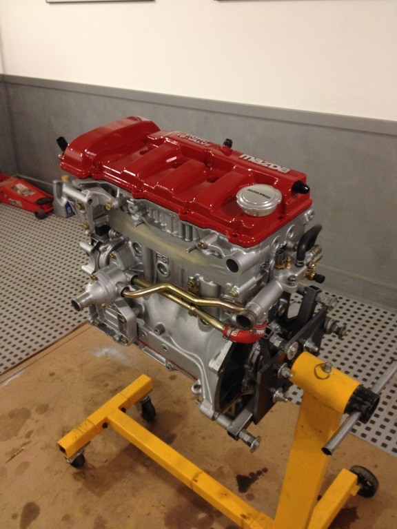

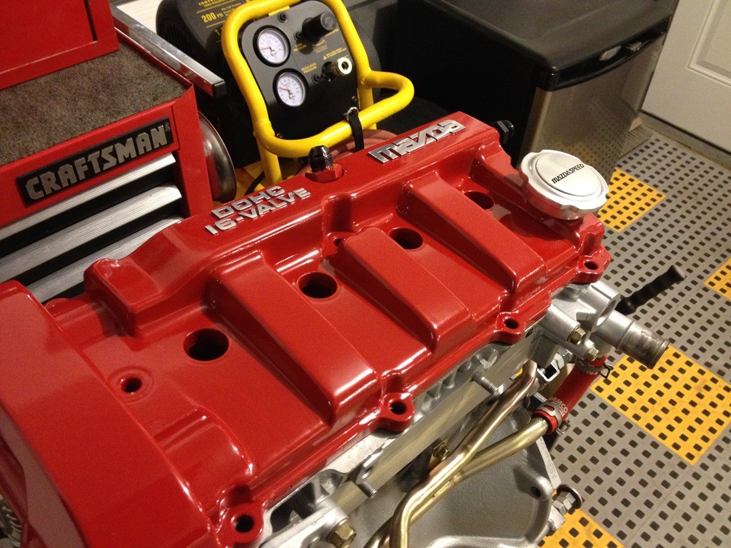

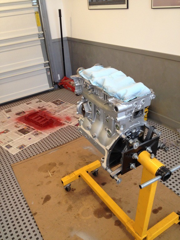

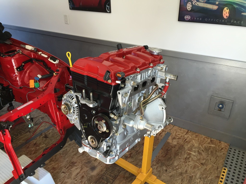

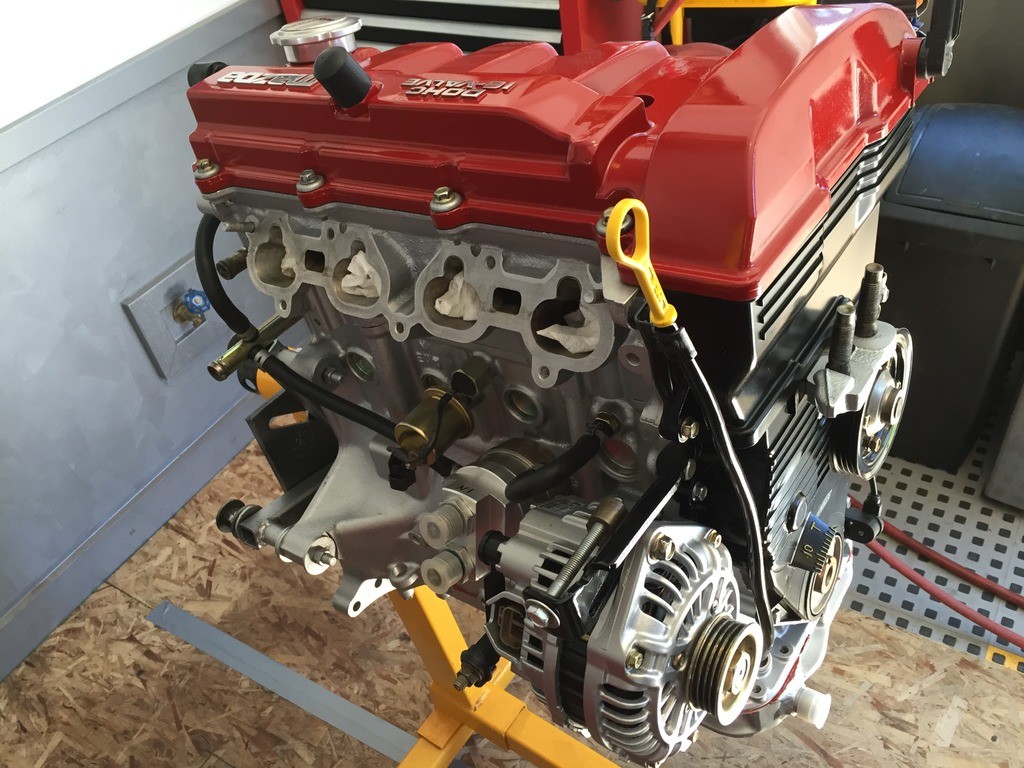

The engine was fine, and barely has 3000Km on it since rebuild. CP 8.5:1 forged pistons, Pauter forged rods, balanced, blueprinted, ARP studs throughout, custom coated oil pump with external PRV, built head with Integral stage 3 turbo cams, Supertech 1mm oversized valves, etc. Thought she could use a fresh coat of paint while it was out, so cleaned, scuffed, and sprayed.

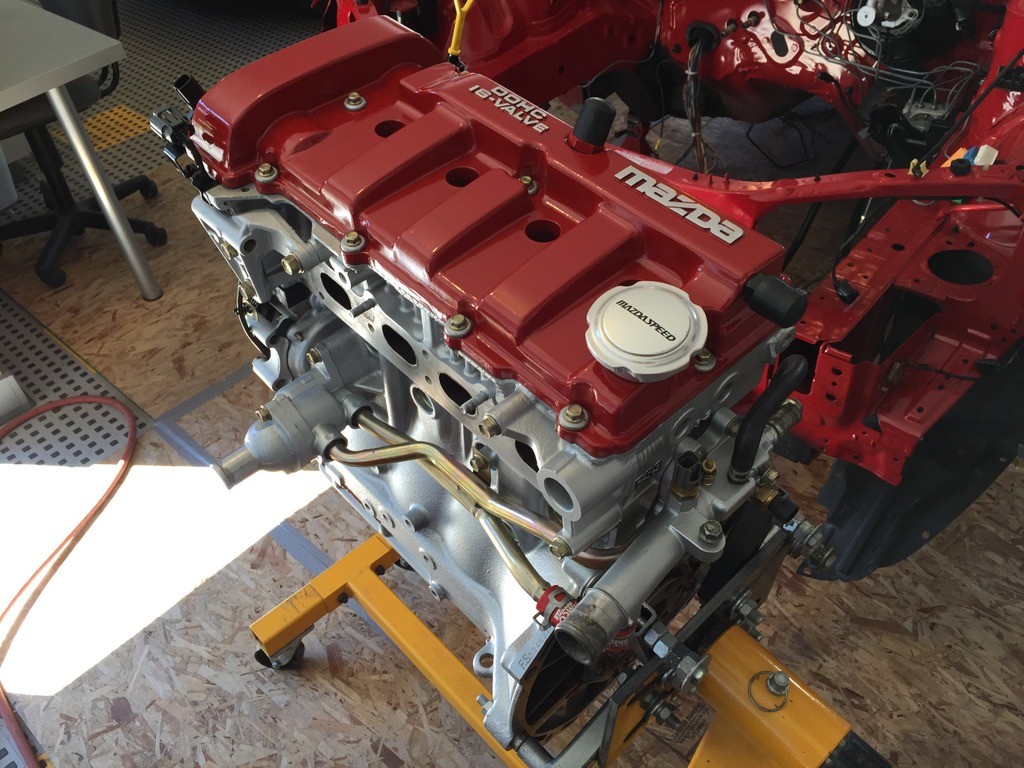

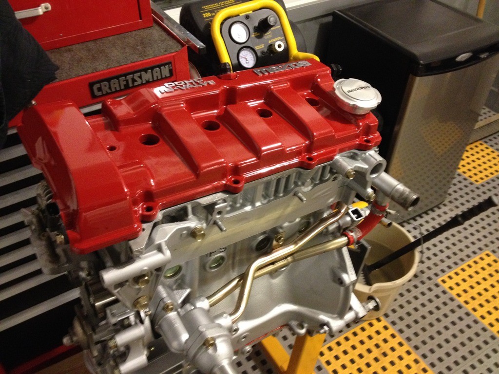

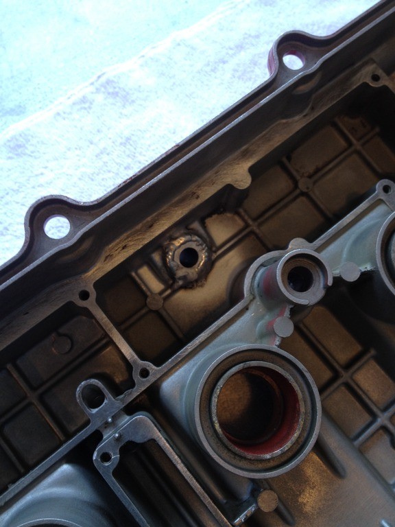

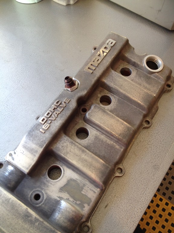

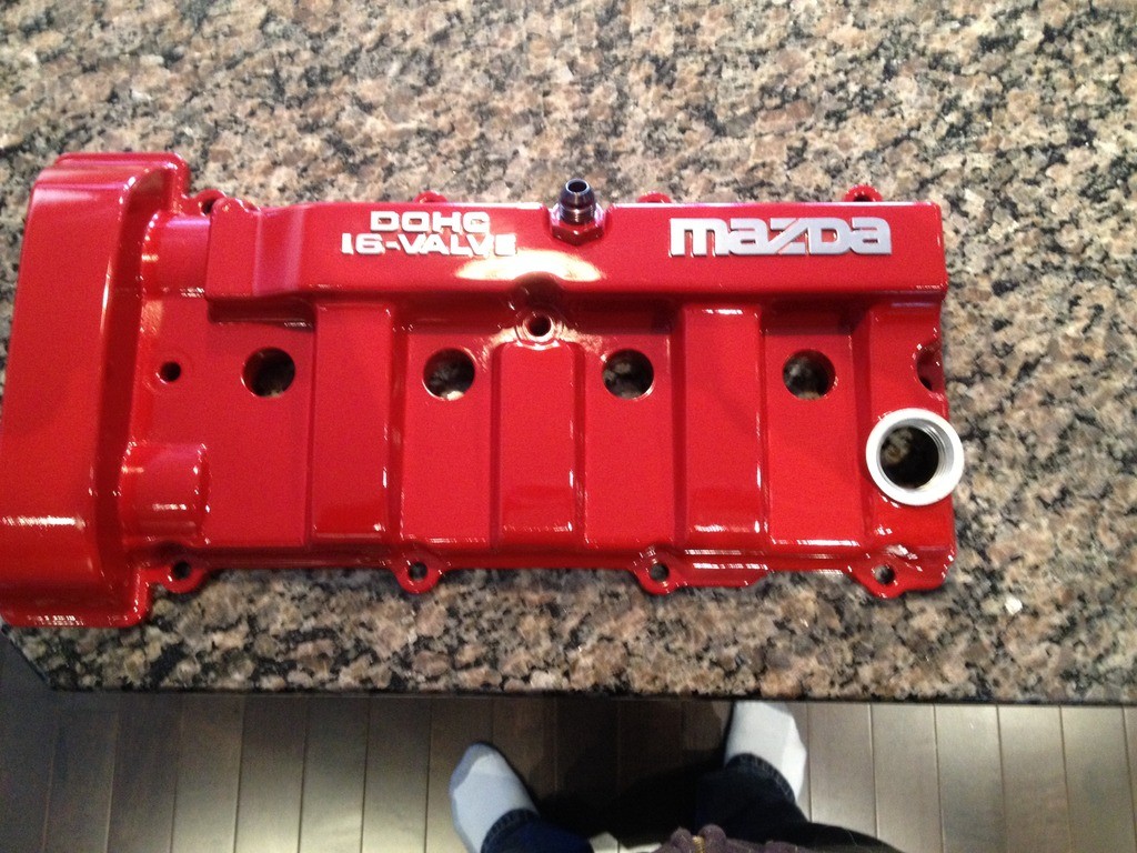

626 Valve cover. Had legendboy weld in the fittings for my custom dual can PCV system.

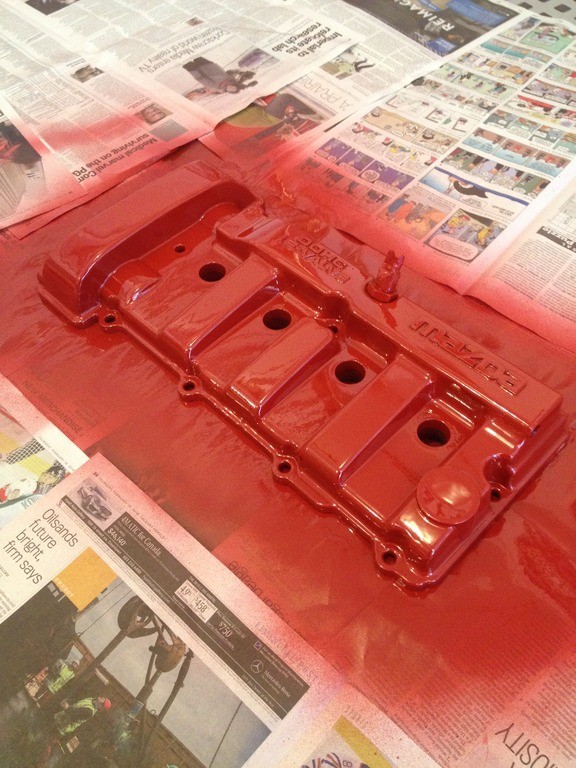

Painted up with 3 coats of color and two coats of clear (engine enamel.)

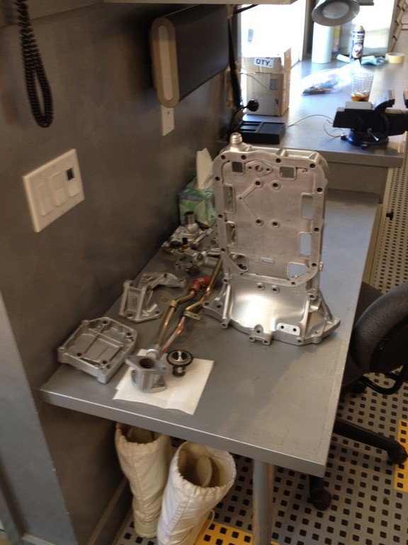

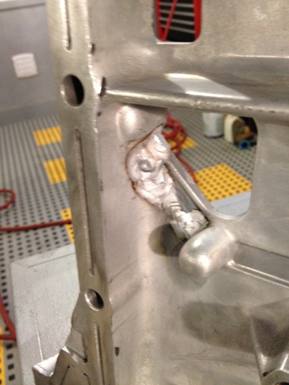

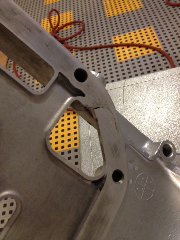

Had legendboy also weld up a crack in my modified windage tray. Oil return for external PRV can be seen.

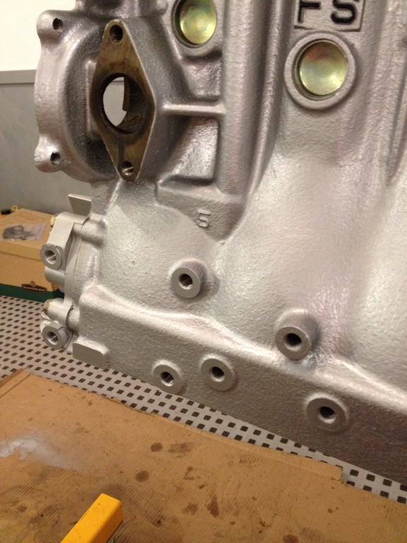

After the block was dry, all threaded holes were re-tapped to remove any paint.

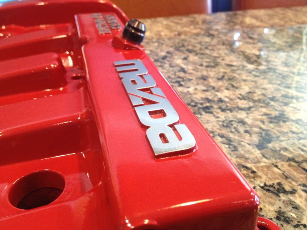

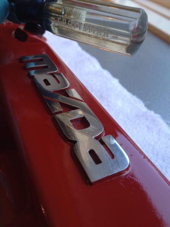

Valve cover lettering sanded and polished.

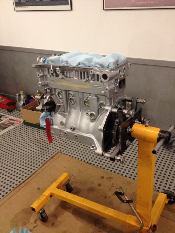

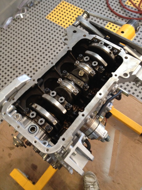

Shot of the bottom end. Nothing to see here.
Valve cover dry fit and misc. hardware bolted back up.

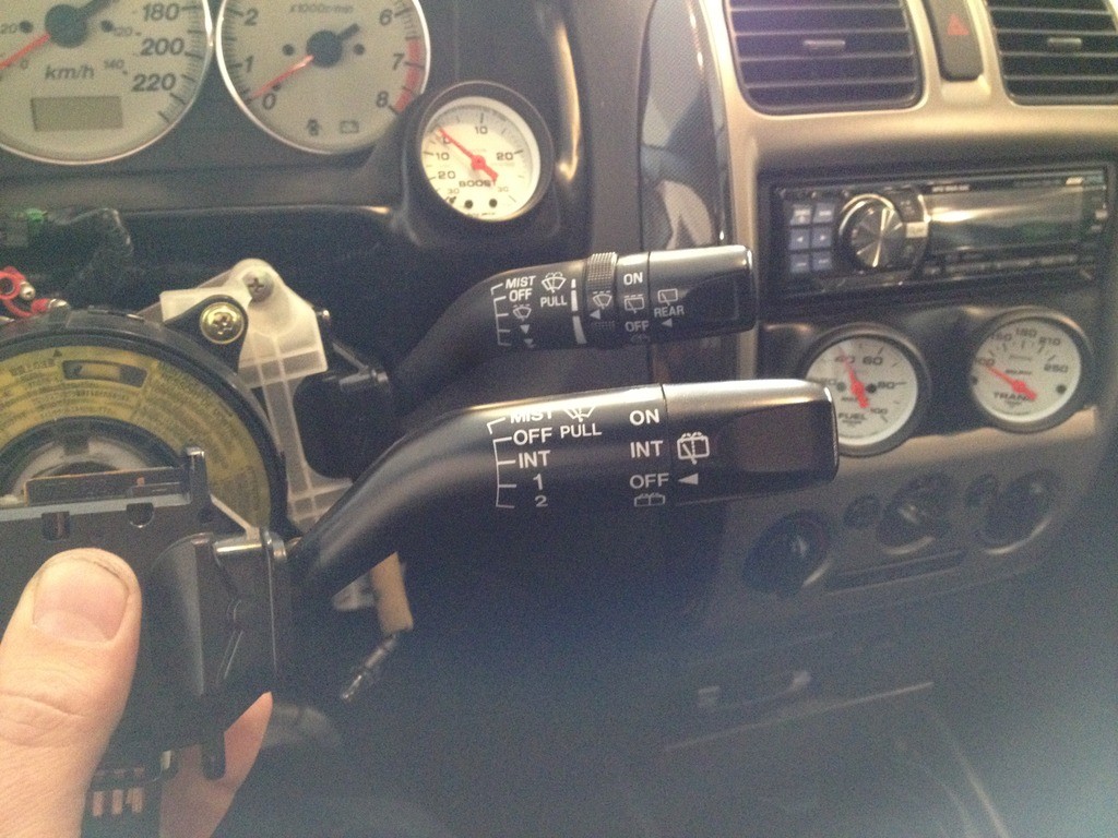

Wiper stalk replaced with one from a Ford Escape to add intermittent function. (Not that this car ever sees rain anyways...)

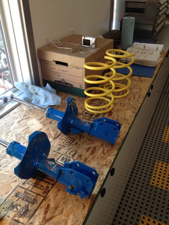

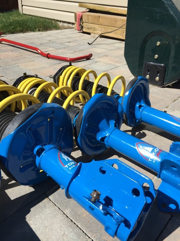

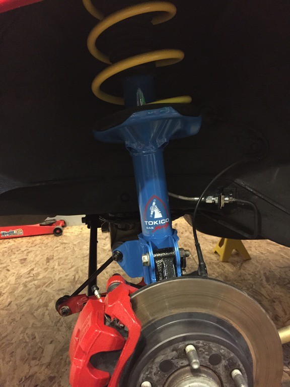

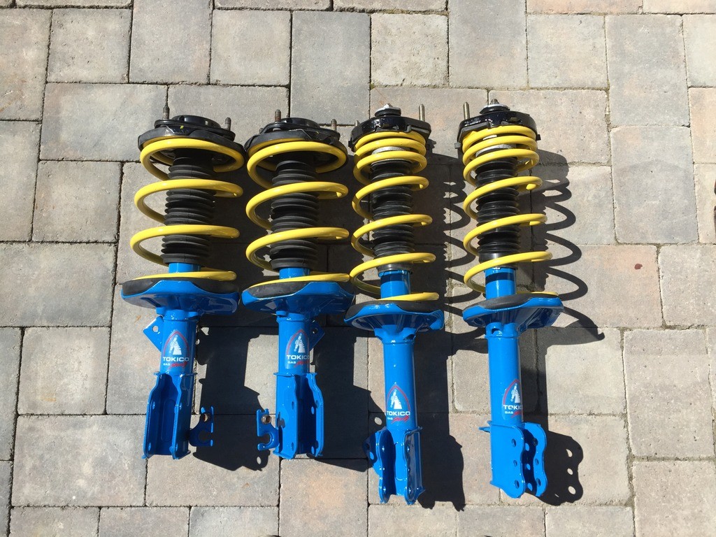

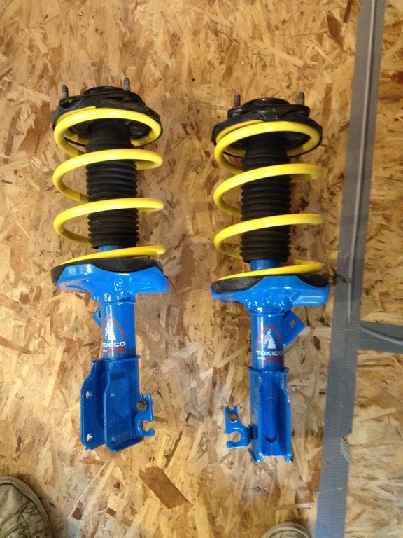

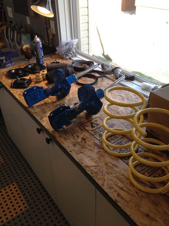

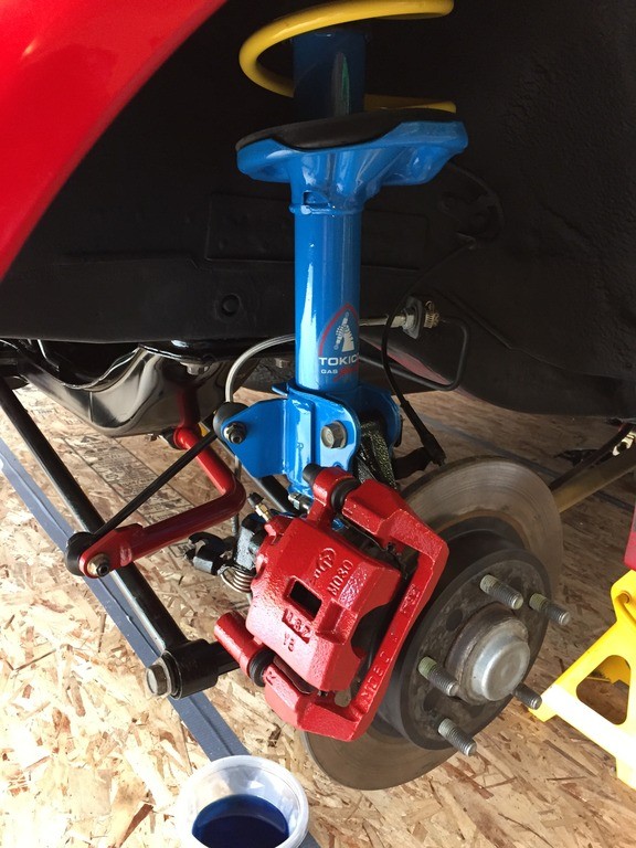

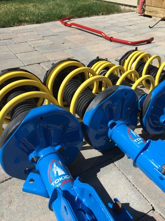

Got some new Tokico HP struts, and had my iON race spec springs powdercoated as they were looking a little dull. Also threw some OSB down on the bench for good measure!
Looking shiny! (Also sweedish I just realized...)

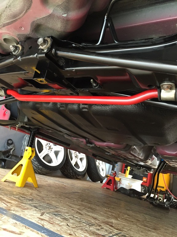

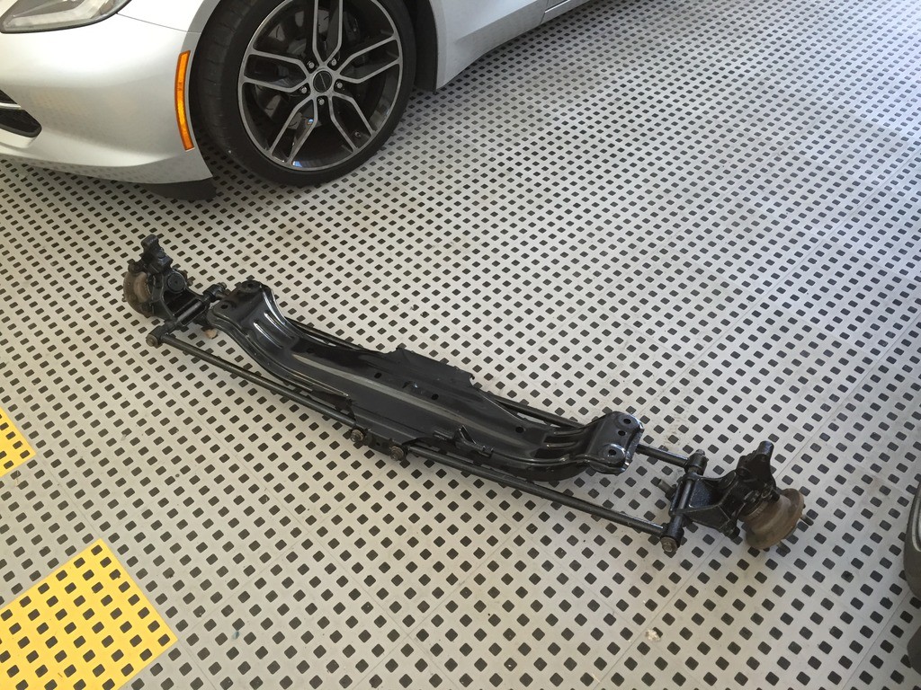

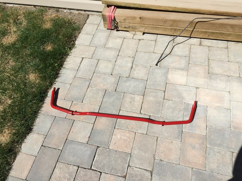

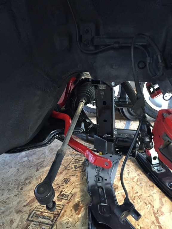

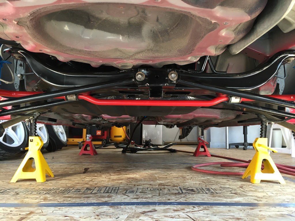

Removed the entire rear subframe, had it powdercoated, installed new bushings, and re-assembled. Also had the sway bars and front subframe powdercoated as well. Here the front is seen "dry-fit" back together.

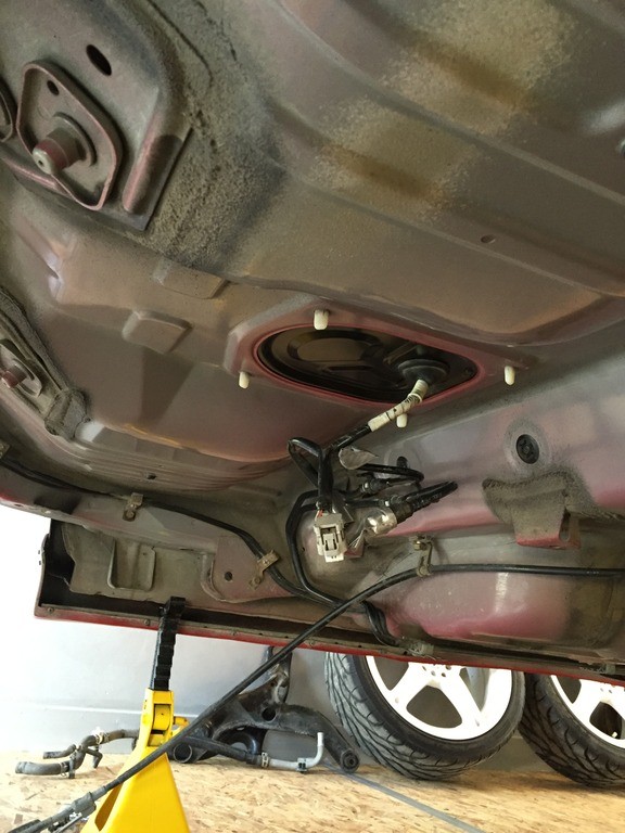

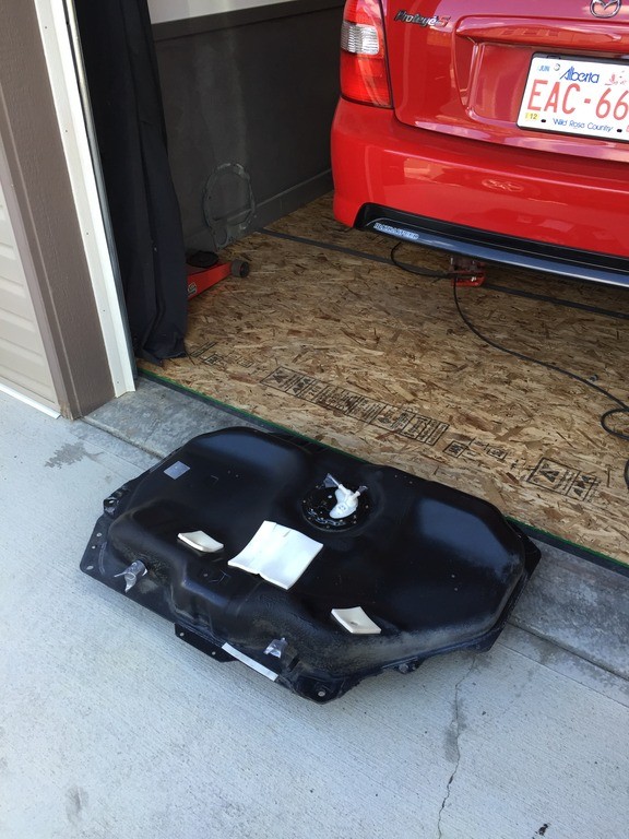

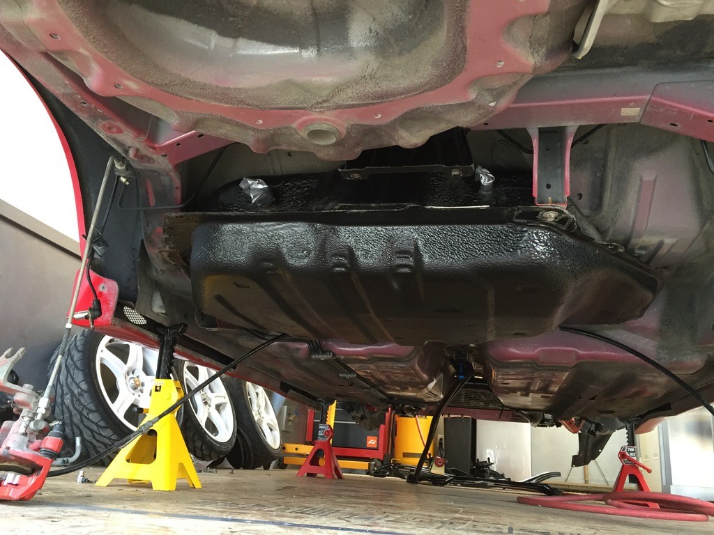

Dropped the gas tank. Drained it, cleaned it, and re-installed. Note that ANYTHING emissions related has been removed for some time.
After the tank was re-installed, the entire rear subframe and all suspension components were installed and torqued to spec along with my AWR trailing links.

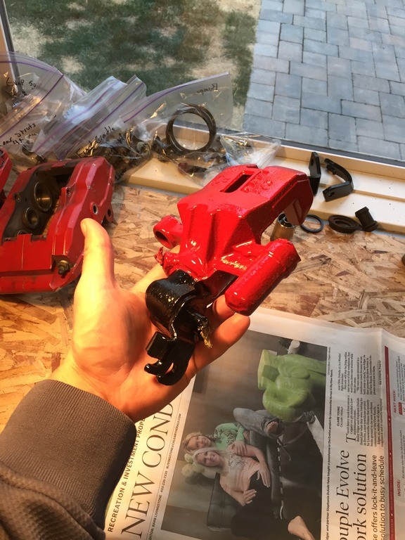

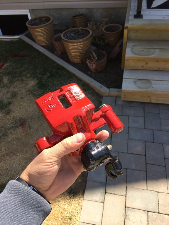

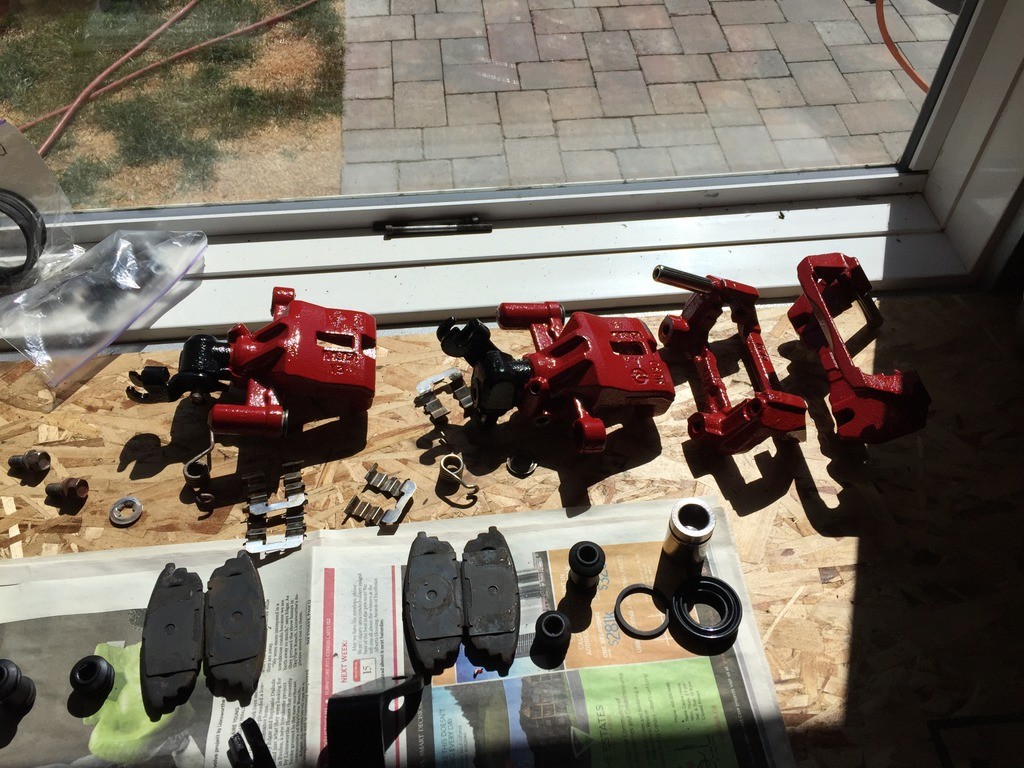

Went to work stripping, rebuilding, and properly painting the rear calipers.
A better shot of the underside:

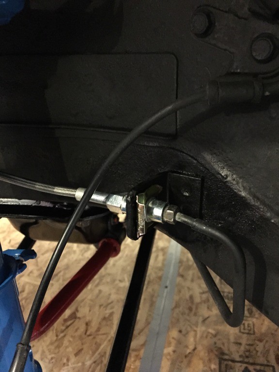

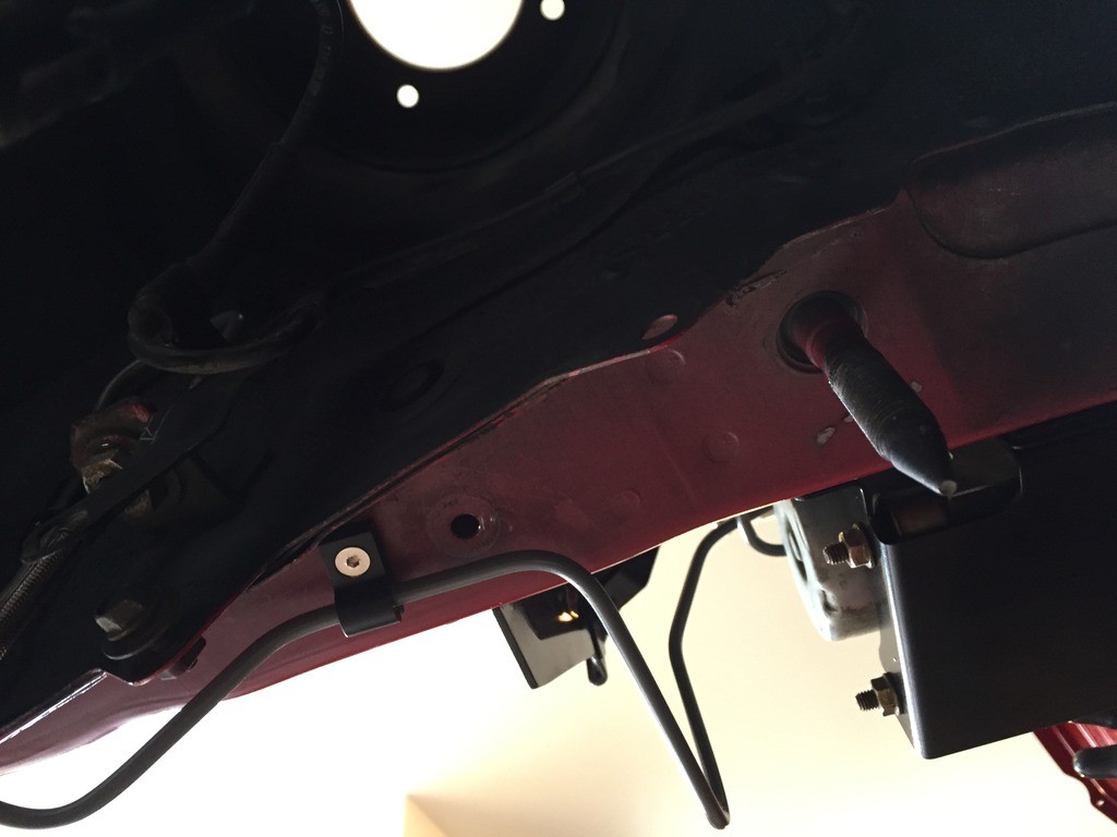

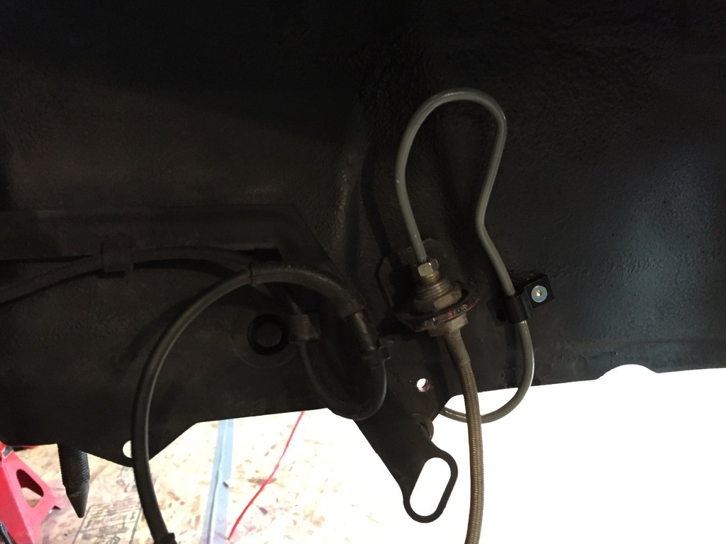

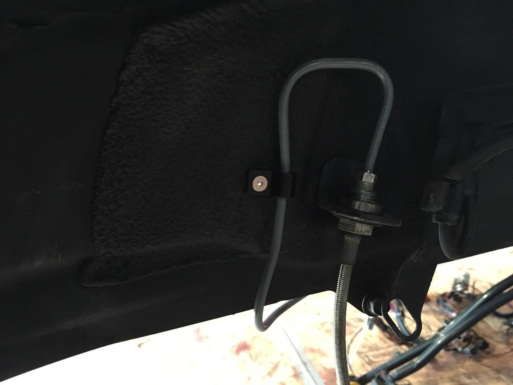

Wasn't happy with how I had the brake line brackets before, so fabbed up and welded in some new ones using all new hardware.

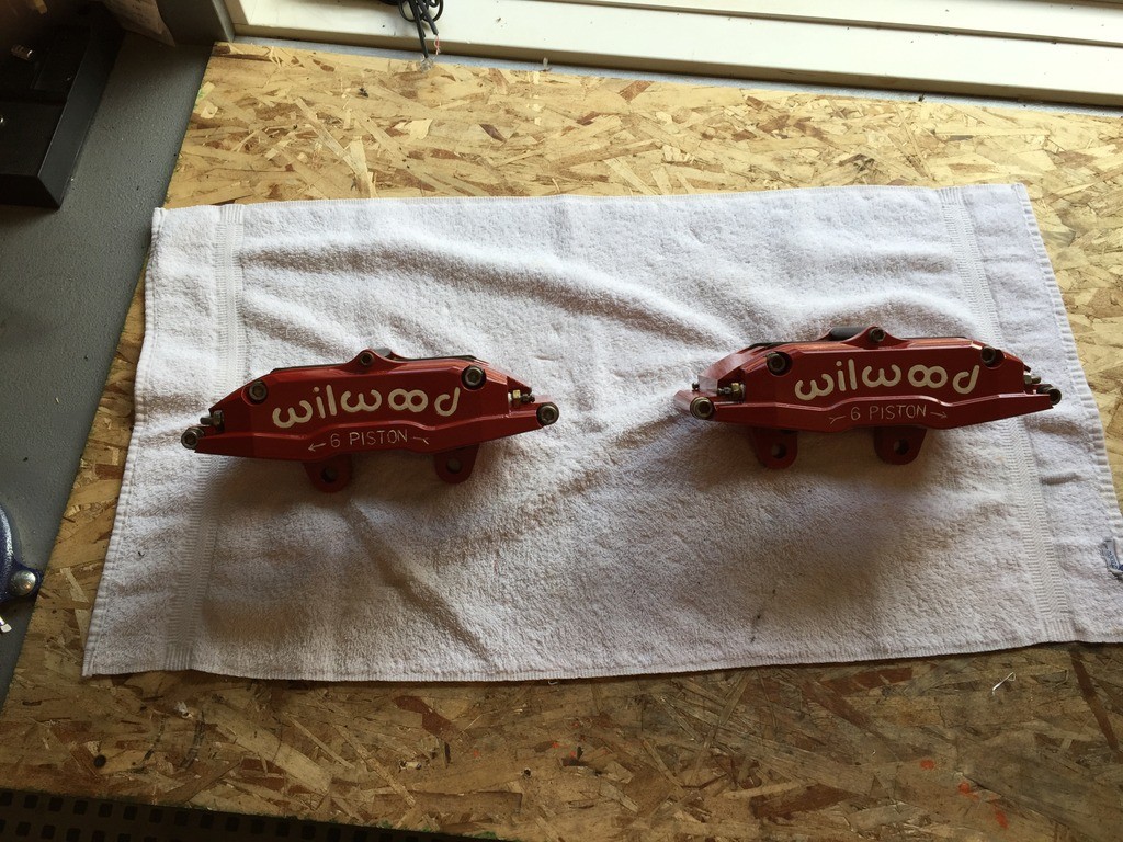

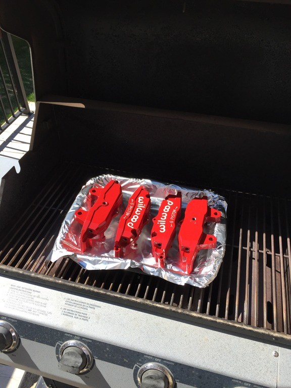

Repainted the front Wilwood blocks. I had to hand do the white lettering. :eek: Baked them well to ensure a hard long-lasting coating with the high-temp DupliColor.

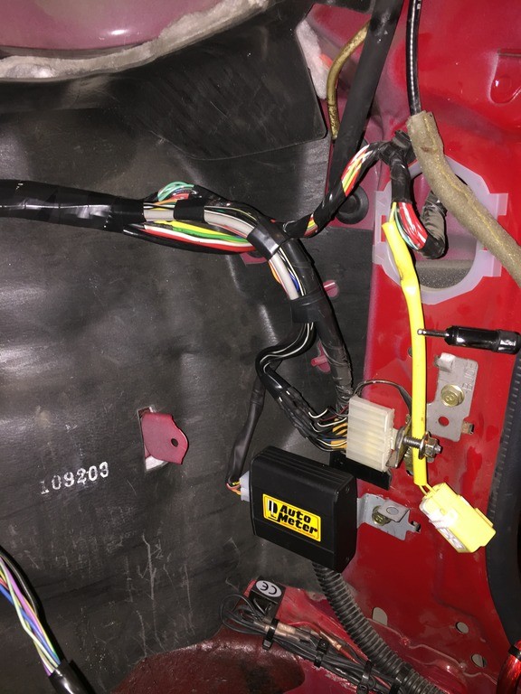

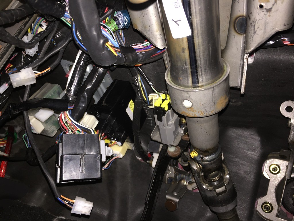

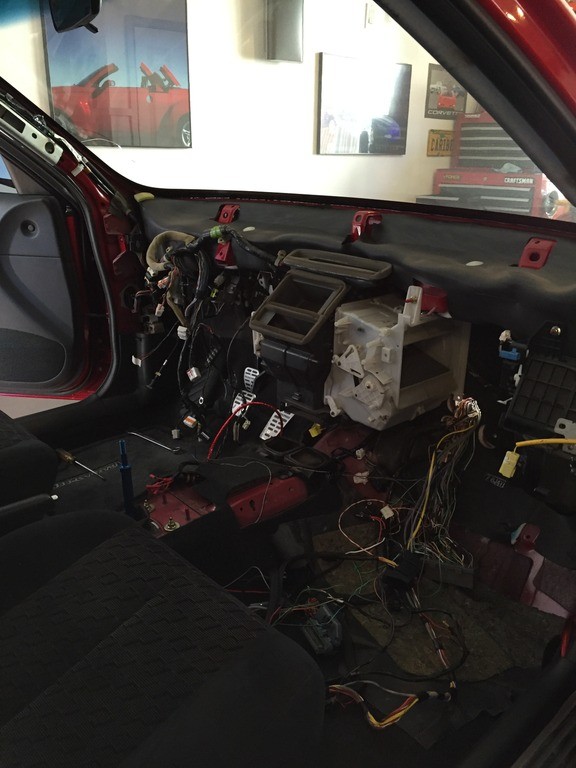

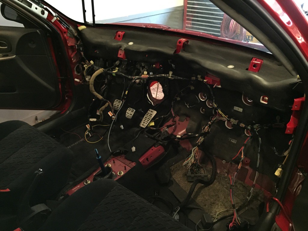

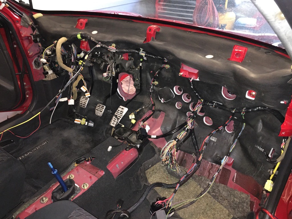

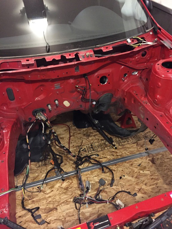

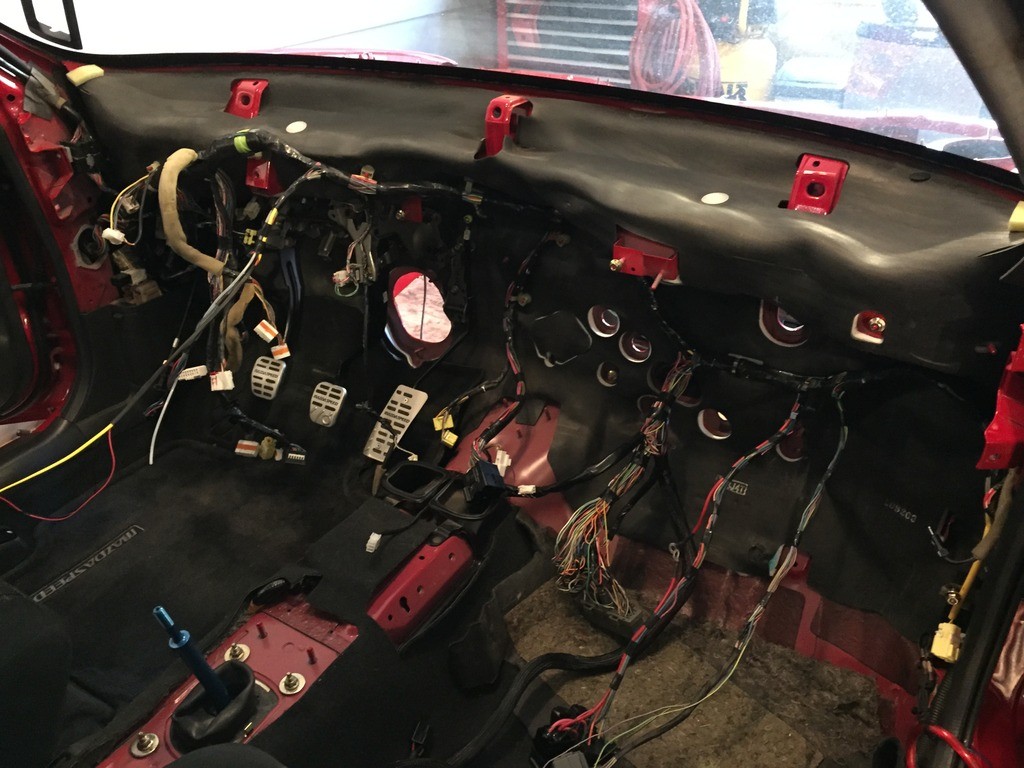

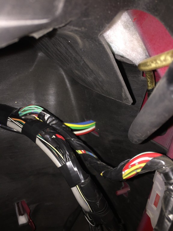

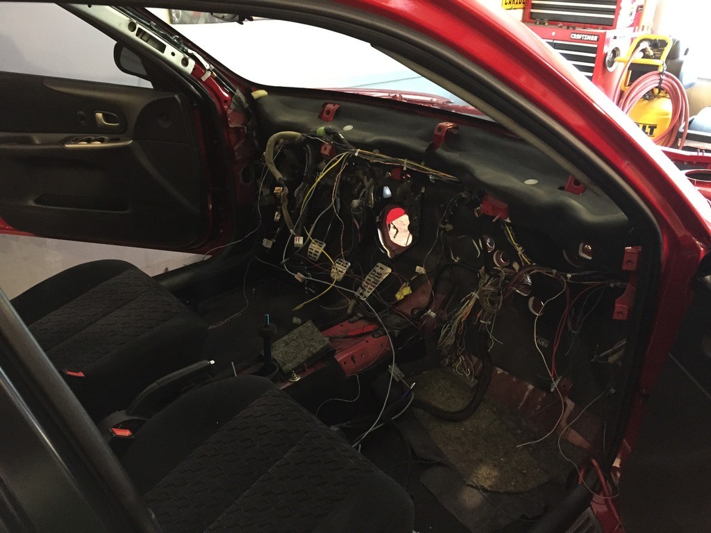

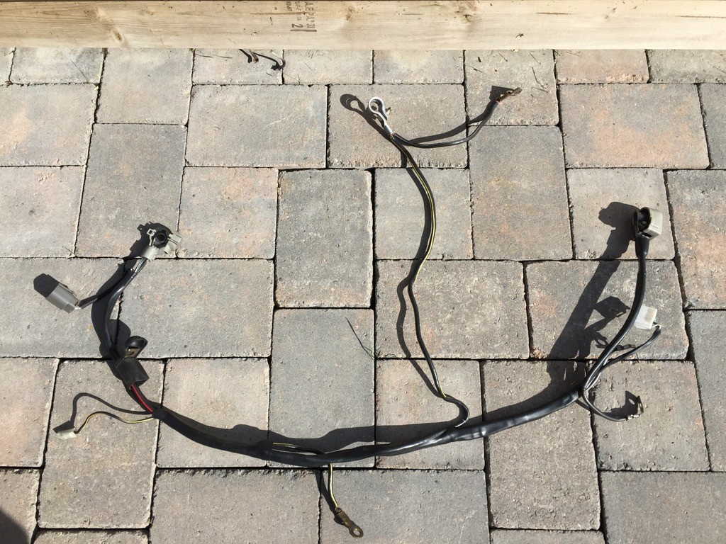

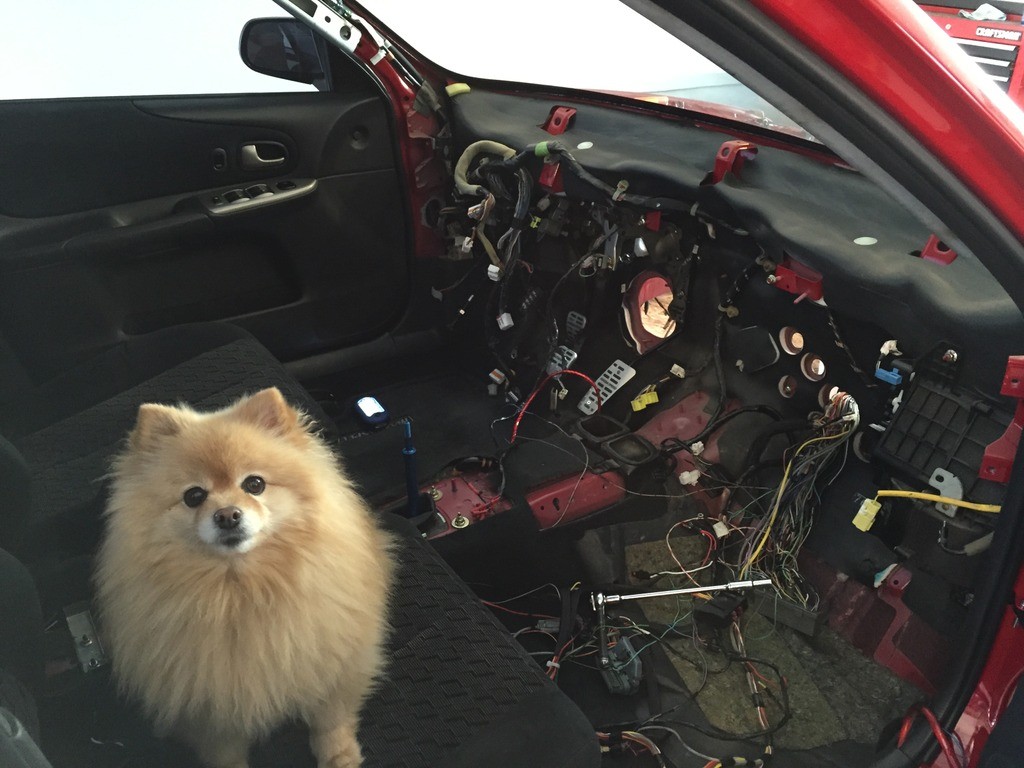

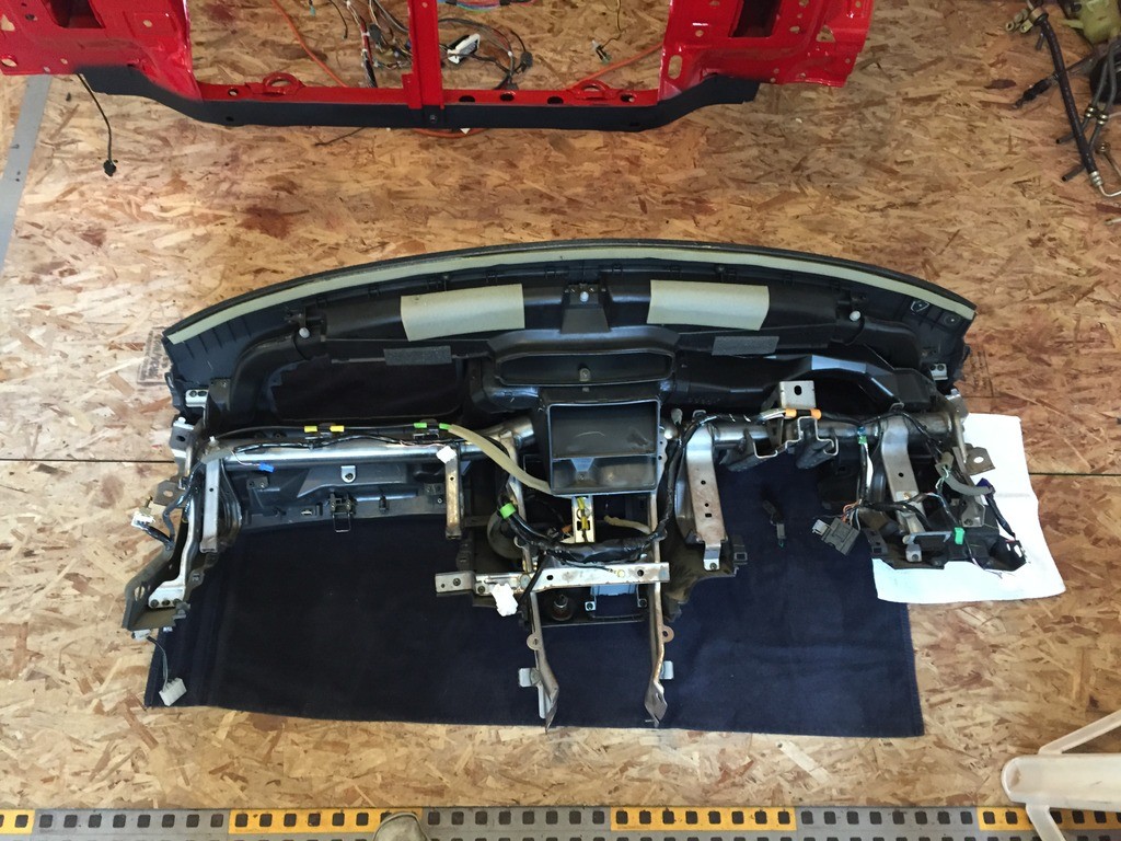

For a long time, the wiring in this car has always bothered me. I decided to redo it, along with a mild tuck. There is hardly anything factory left in this vehicle anymore. As a testament to my previous work, removing everything I had done was a TOTAL PAIN IN THE ASS I'll spare you the details, but suffice it to say it took a long ass time. To begin, stripped all loom from the wiring, keeping in mind where it needed to run. Pulled the dash, and heater core / fan assembly. Had my shop helper too!

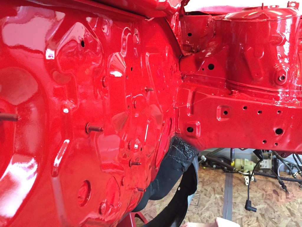

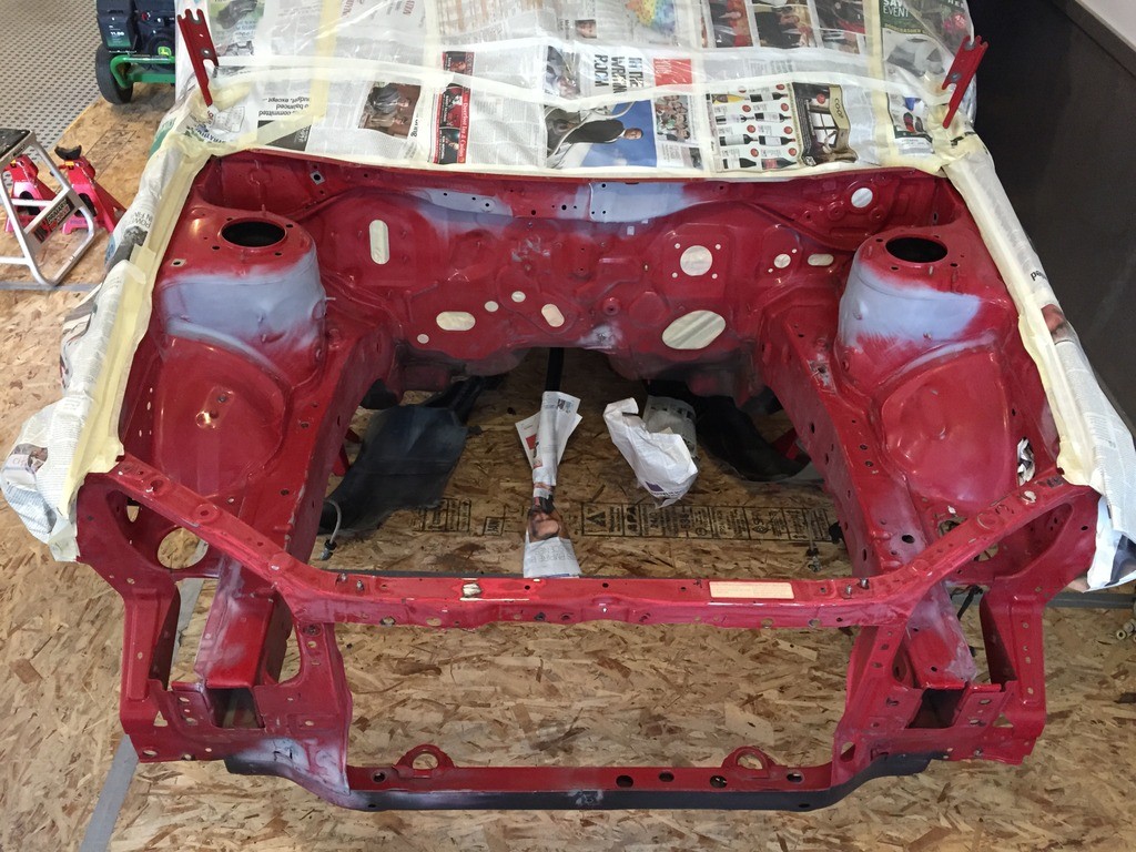

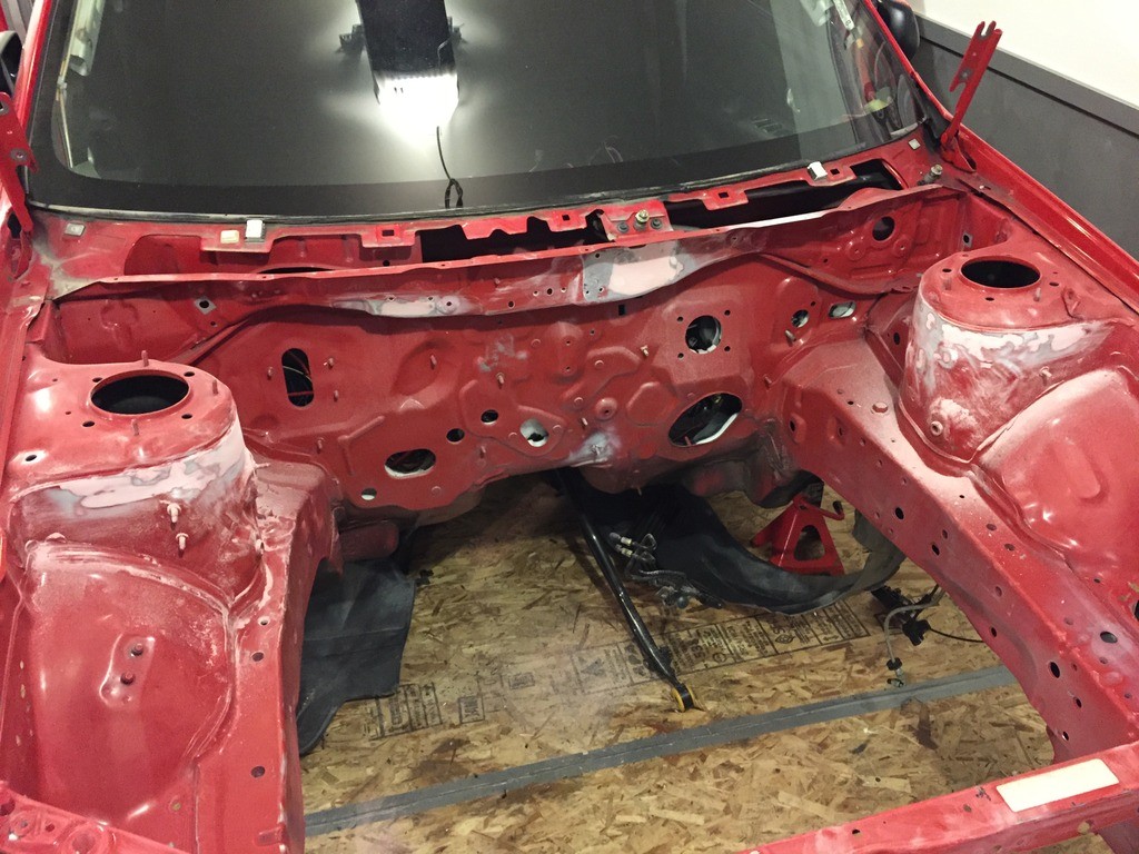

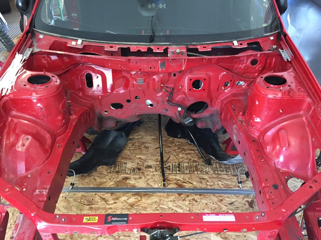

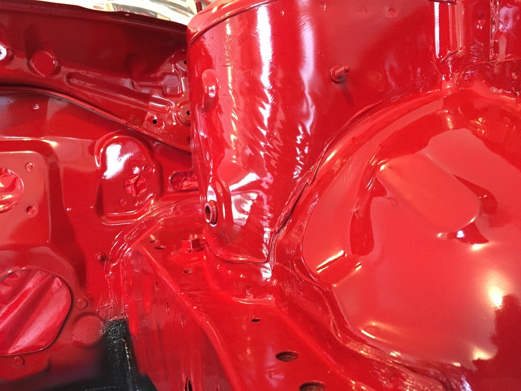

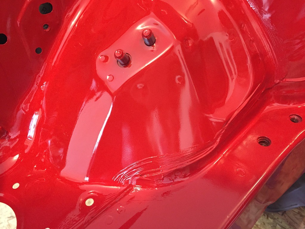

Stripped everything from the engine bay in preparation for welding and paint.

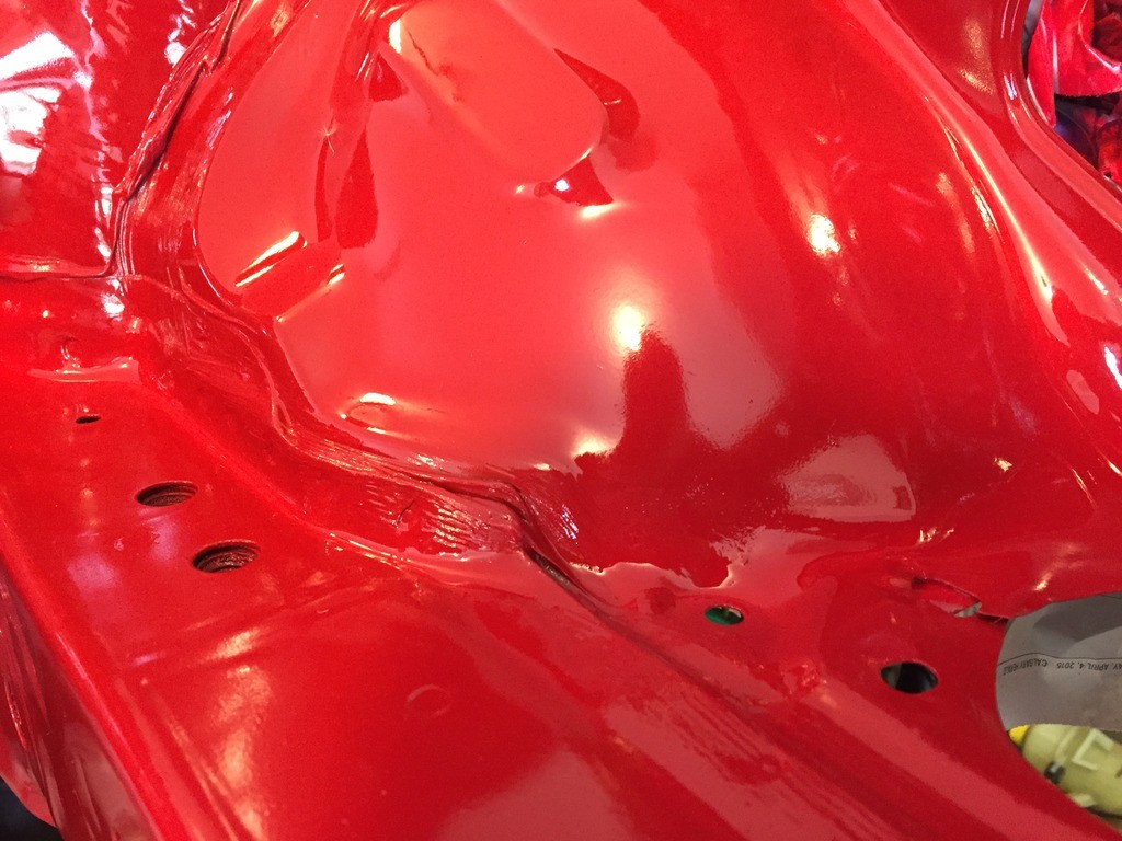

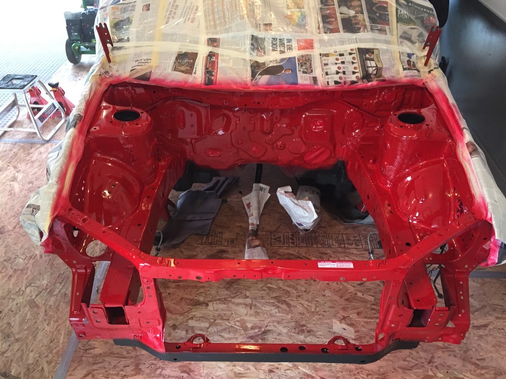

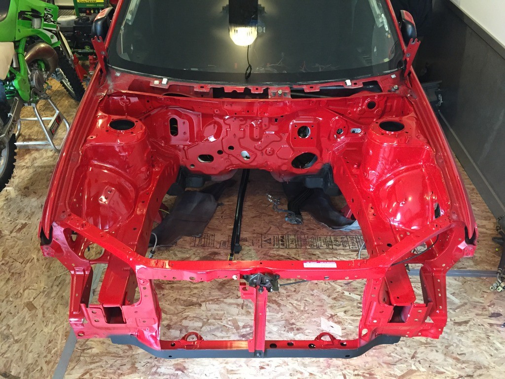

With the bay stripped, I was able to remove any standoffs that I wouldn't be using anymore, and weld up any holes that I would no longer be using. Then, the whole bay was prepped, primed, cleaned, and painted by yours truly. I'm happy with how it turned out.

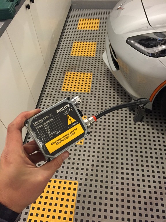

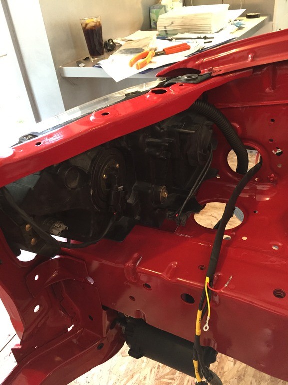

With the bay painted, I could move on to the wiring again. For the headlights (I have a PROPER Philips D2R retrofit) I decided to remount the ballast to the light itself for a much cleaner look.
I wanted to make all the wiring "modular" meaning where I needed a connection, I would build an actual connector. Mini-molex type on all interior connections (no weatherproofing required) and Delphi Weatherpak connectors on anything exterior. Here you can see some progress on where I integrated everything into the dash harness (look closely!) Can't see it? Good. That's the idea. Make it look stock.
Also made some progress of the layout on the inside.

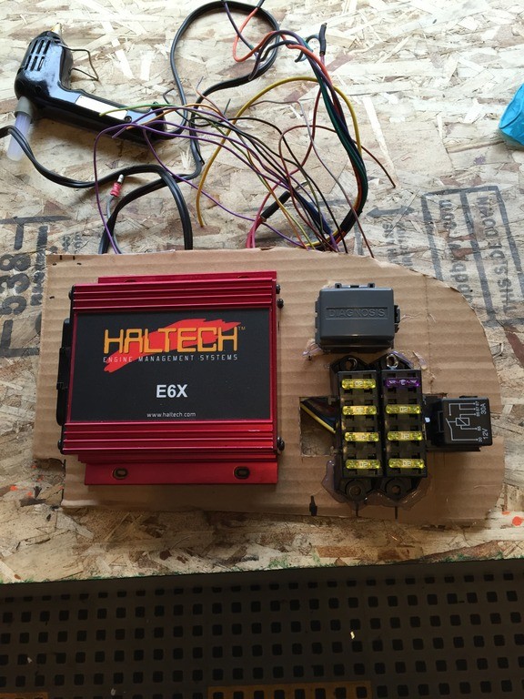

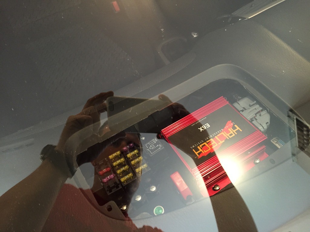

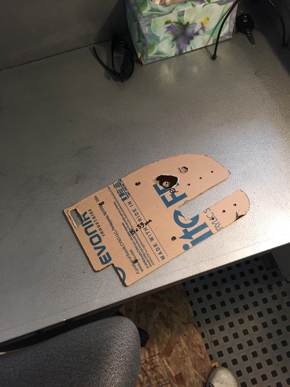

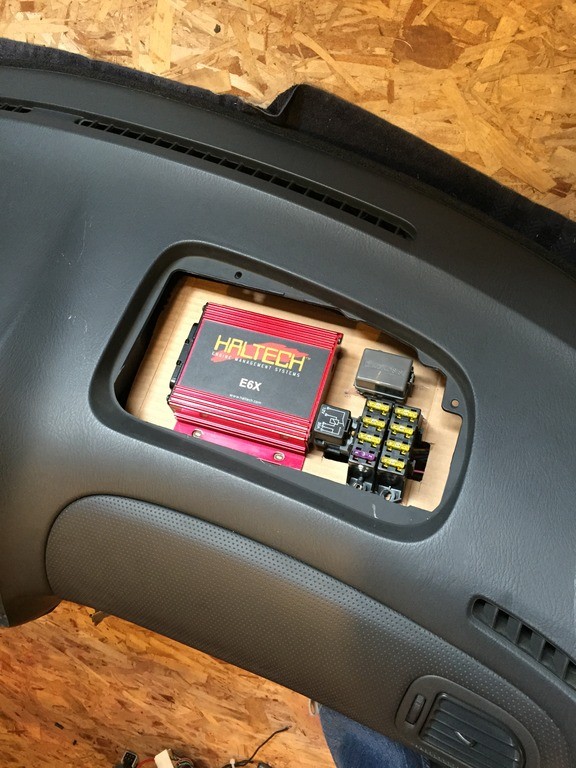

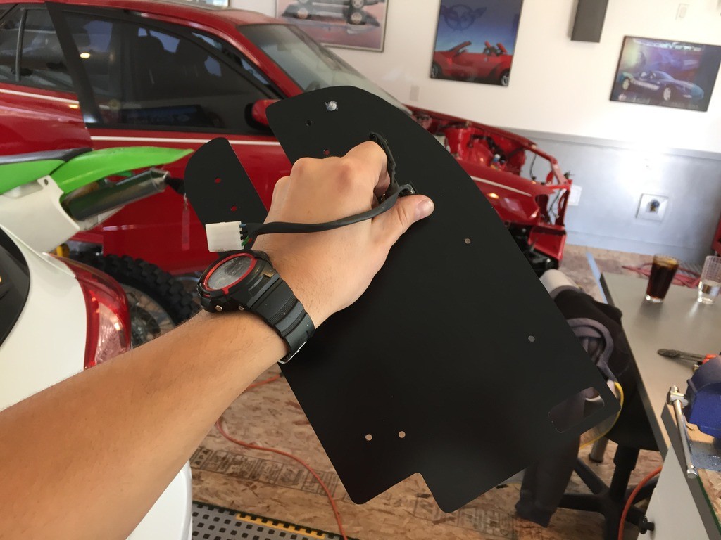

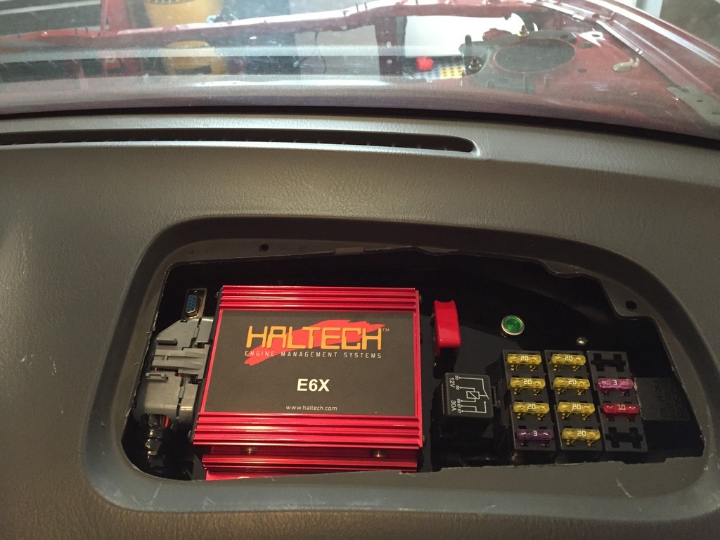

Decided I wanted to do something "cool" with how I mounted some stuff. I have a complete standalone fuse box for gauges, methanol pump, HID's, you name it. Keeps everything neat and tidy. Wanted to mount it somewhere accesable and that I could show off if need be, along with the Haltech. Decided to fab up a plate where the passenger airbag used to be. Cardboard mock-up.

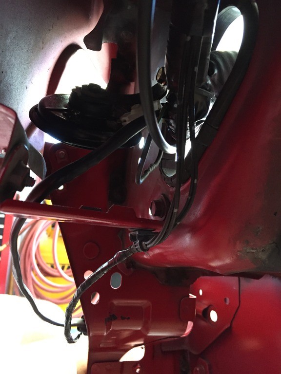

Various progress pics of the interior wiring. Had a schematic drawn up of what went where, along with the factory wiring diagram. Mounted the Haltech RA-10 (with the Autometer sticker on it for s****) in the passenger footwell as you can see, and as part of the wire tuck ran everything for the right side of the car out through a grommet I made in the passenger side fender well. These wires were all run one by one, and mocked up with zip ties and tape until I had everything where I wanted it. Words can not describe how time intensive this process can be. Take your time, and do it right the first time.

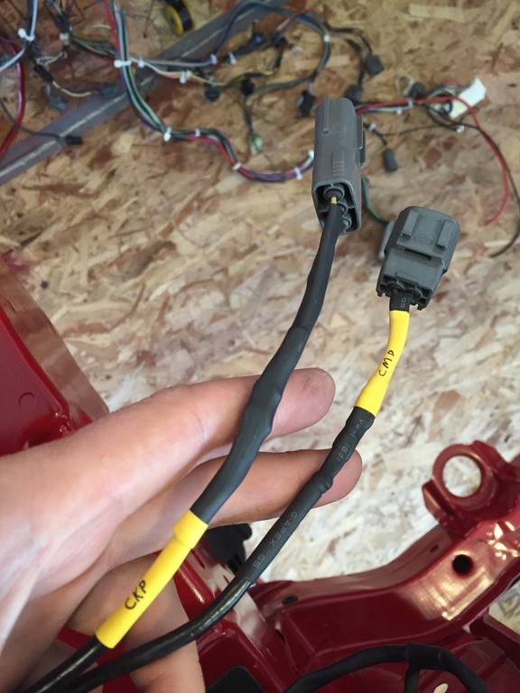

When deciding how to finish off the wires, I was debating different styles of loom. Corrugated looks like s***, but is easy to work with. The mesh style is alright, but I've used it before and I'm kind of bored of it to be honest. Decided to do a "RyWire" style heat shrink loom, with labels on the connectors. Did up a quick sample on the Cam and crank sensor plugs.

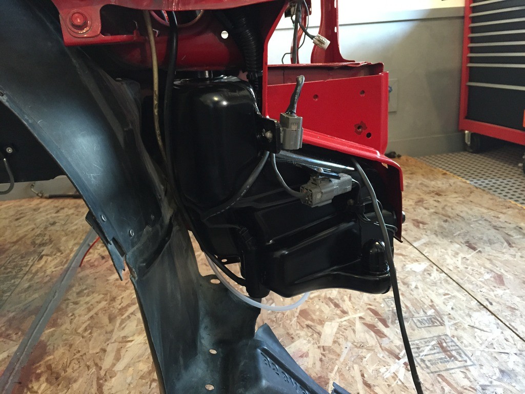

Stealthed my methanol pump install. Notice the rubber grommet I added to the left of the pump. The hose will pass through here and travel up to the intake within the rad support, so you won't see it.

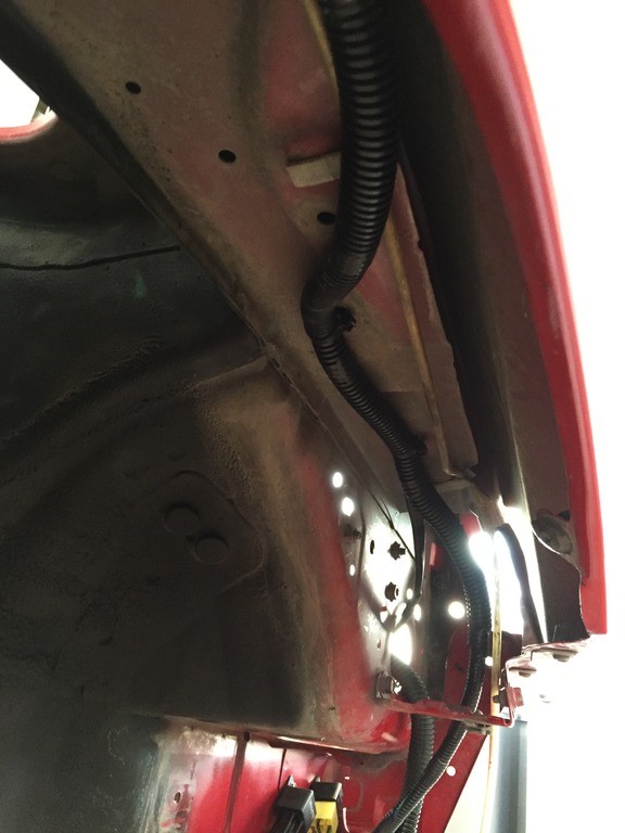

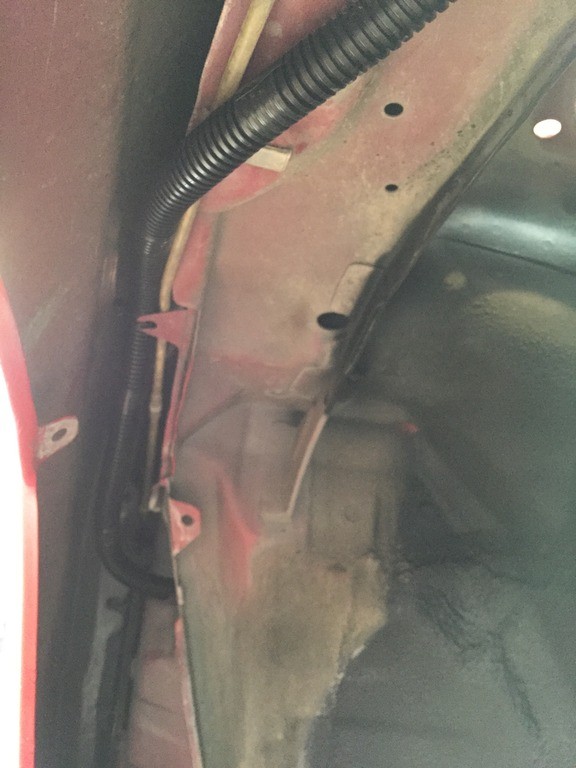

Finished up the wire tuck through the passenger side fender. Used corrugated loom as you won't see it, and this will provide abrasion resistance.

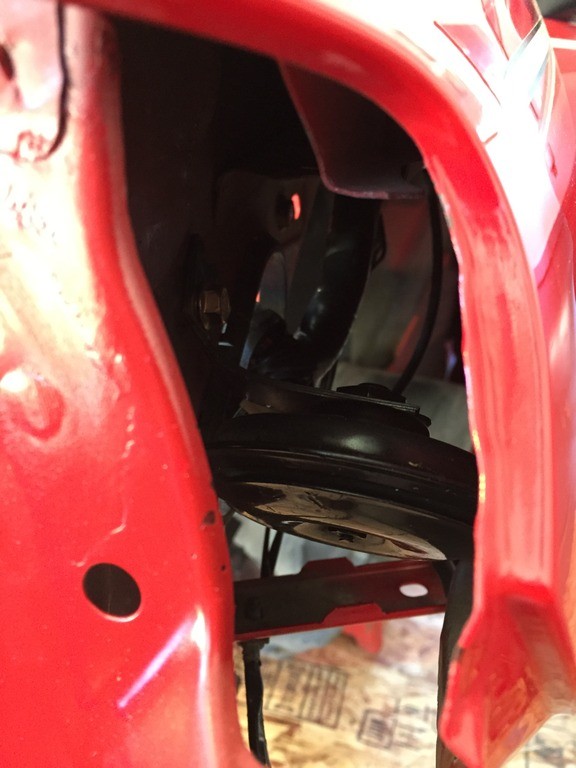

Horn relocated from grille to fender. It's s*** like this that probably nobody will ever notice, but it contributes to the look of a clean bay as a whole. It's all in the details.

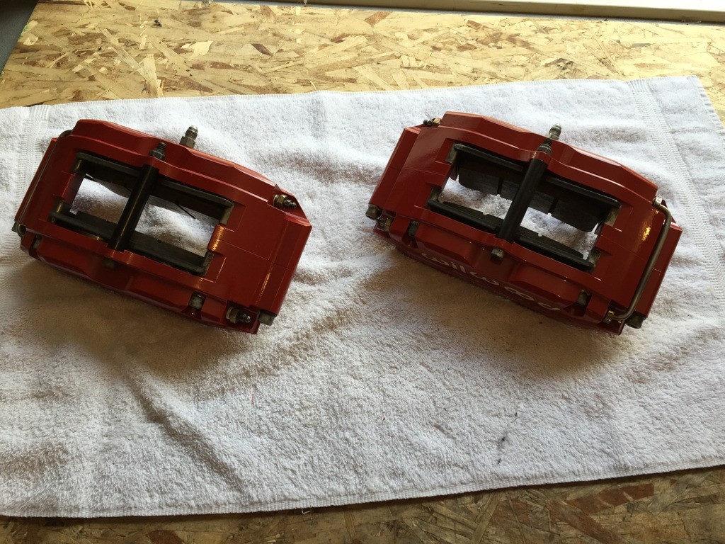

Got the front calipers assembled. Hand for scale. And yes, they are amazing.

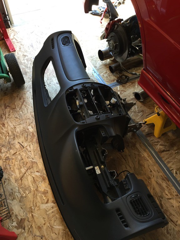

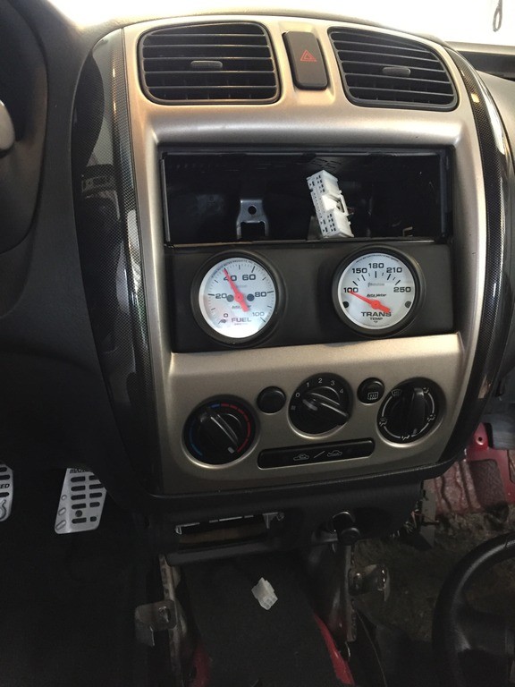

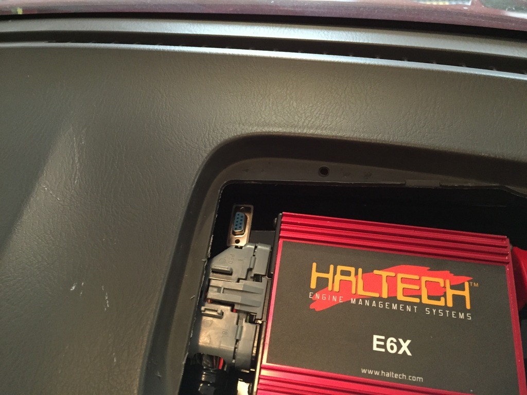

Dash was reinstalled and wires ran. Take a second to look at the second pic. While I didn't have any of the wires mounted in their final locations, notice all of the plugs I built so that everything is modular. The entire dash can be unplugged and removed in about 15 minutes. Was this necessary? Absolutely not. I could have easily hardwired everything in permanently. Those damn pins take an ETERNITY to do, and every wire was soldered and heat shrinked on top of that. I don't accept anything less than perfection, so I always do it the best I possibly can. Once all those plugs were connected (I made sure to use different ones so there were no chances of mix up) they were loomed aside with the factory wiring to complete the factory look. Below the gauges in the center stack you can see a plug I built for the turbo timer as a prime example.

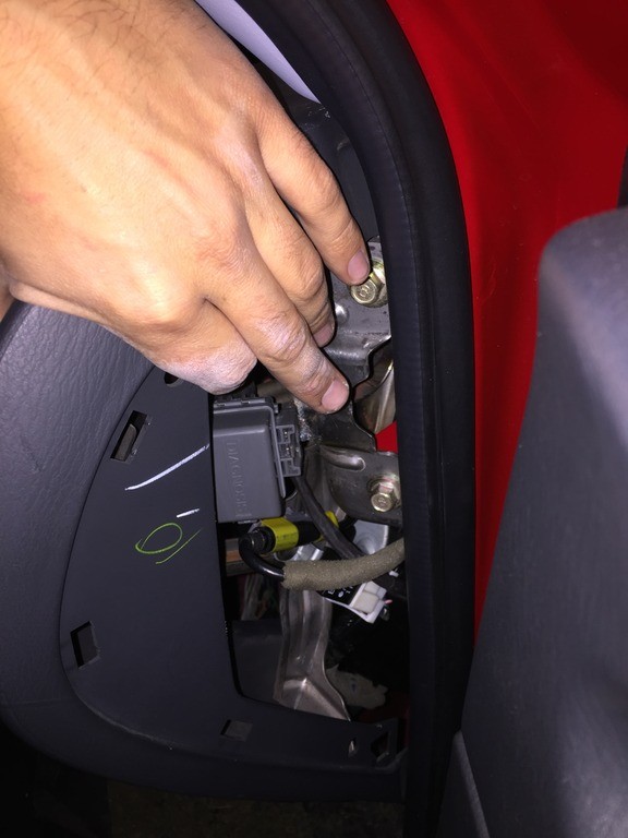

I originally wanted to mount the diagnostic port in my cool airbag panel, but there simply wasn't room. So, while the dash was out, I welded a bracket to the dash frame for it, and it's easily accessible behind that trim panel. Why keep the diagnostic port on a vehicle with no stock ECU? I will explain this later. I have a trick up my sleeve. :D

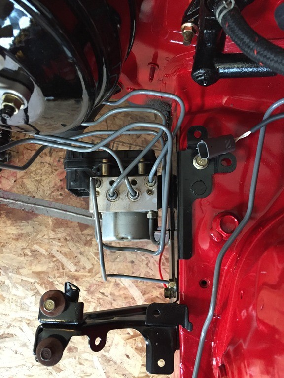

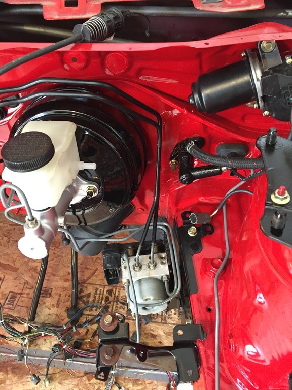

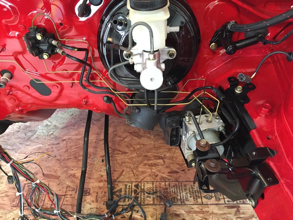

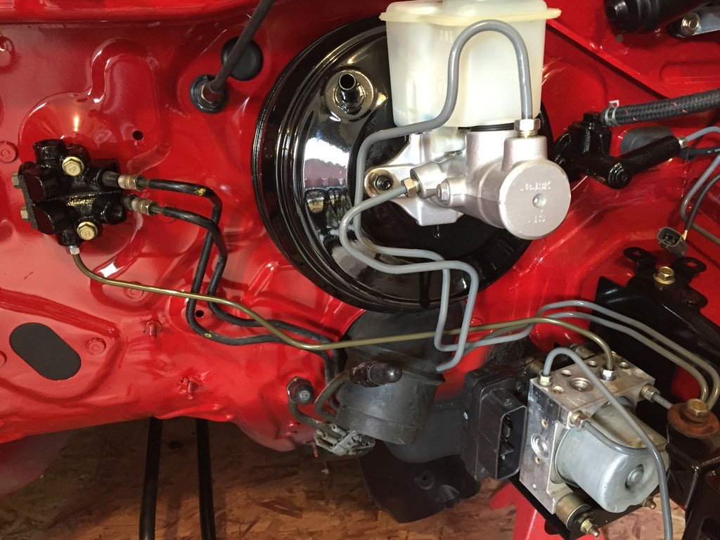

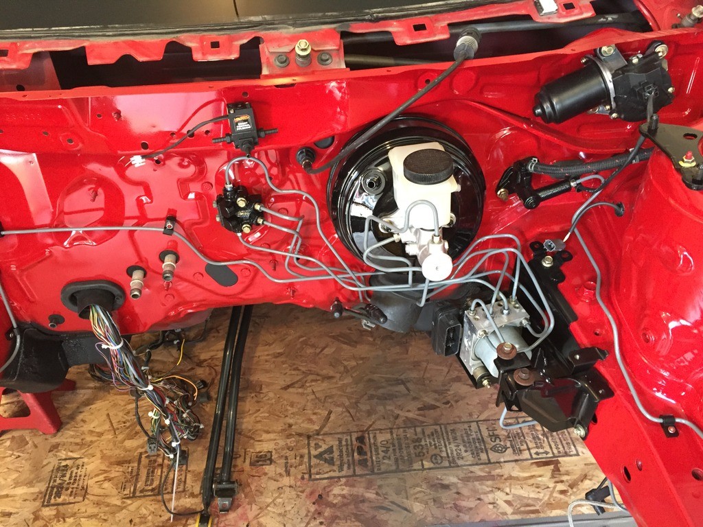

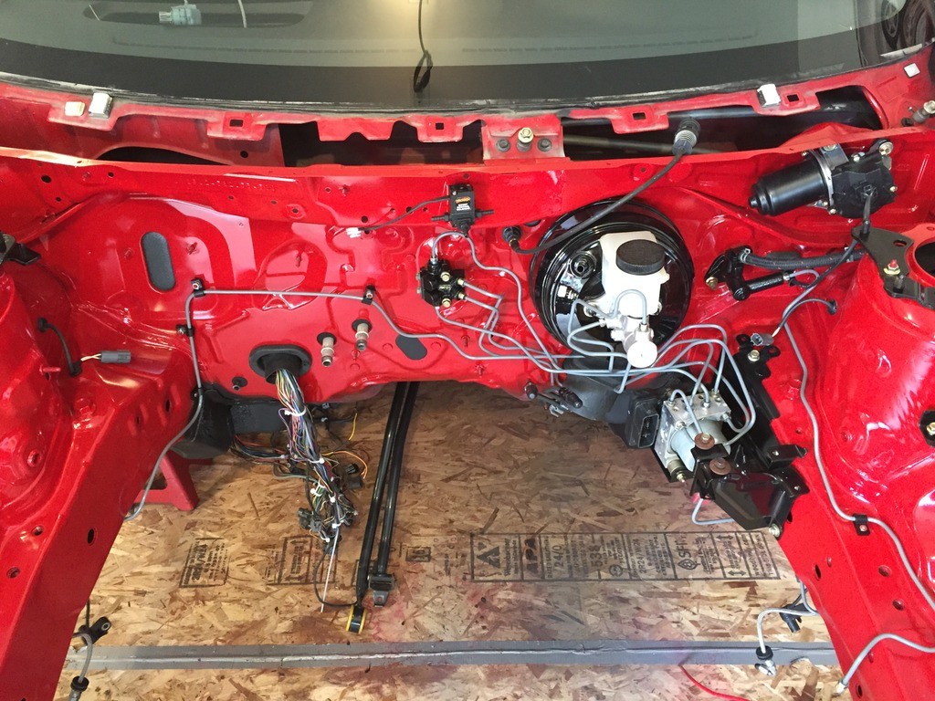

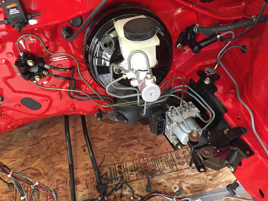

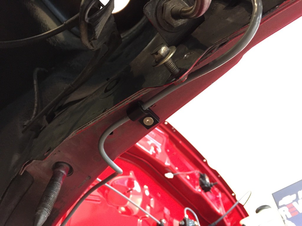

The factory brake lines come out of the ABS controller, go up OVER the brake booster, and down into the distribution block. I wanted to keep ABS for two reasons. The car comes equipped with electronic brake force distribution, which sends max braking power to the wheels with the most grip, and second, with those giant 13.5" front brakes and the Mazda 929 master cylinder, it is unbelievably easy to lock up the brakes without ABS.

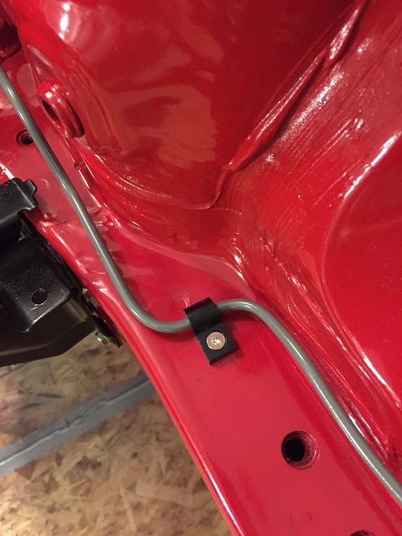

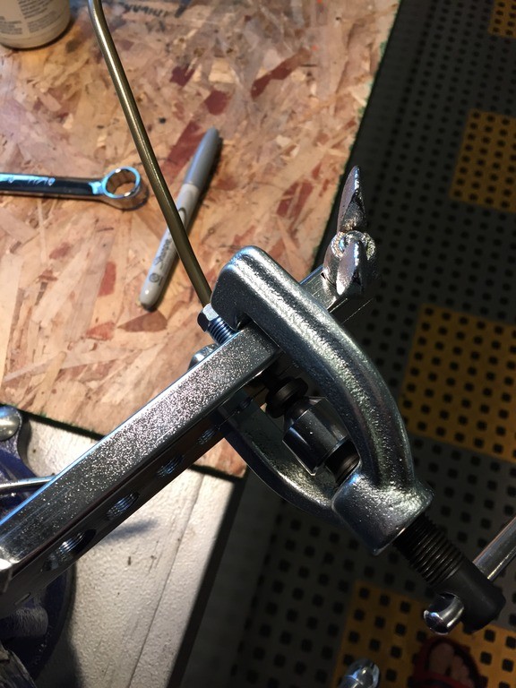

As such, I decided to make my own brake lines that went under the brake booster and will be completely hidden once the engine is in place. I began by making mock ups with coat hangar, to make sure nothing would interfere, then I cut, bent, and flared my own lines.
After I had them made and fitted, I had them powdercoated aircraft grey. Because I needed new brackets, I picked some up at Mopac and drilled and tapped the body for the #6 machine screws, and the finished product looks quite slick if I do say so!

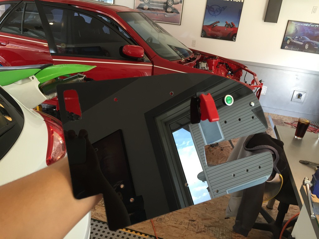

After countless hours of ptototyping, I FINALLY decided amongst other materials to make my airbag plate out of acrylic. Had to cut it out, drill and tap mounting holes, and even build another plug for the switch and light. Tapping holes in acrylic is NOT fun! Beware cracking!
And, with lots of ******* around, everything mounted. The switch will arm/disarm my anti-lag, the light indicated when methanol is being sprayed by the Haltech, the fuses and relays are easily accessible, and the Haltech date port for tuning is located top left.
I can pop this cover off for car shows / tuning, and for street driving the stock airbag cover snaps into place and nobody is the wiser!

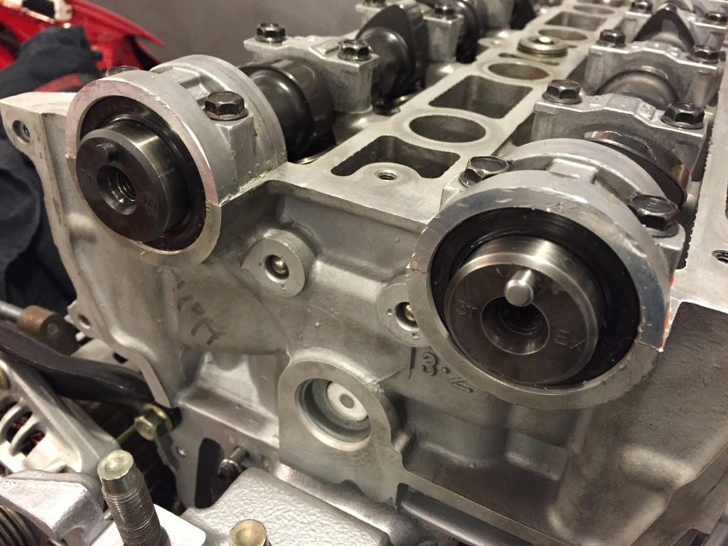

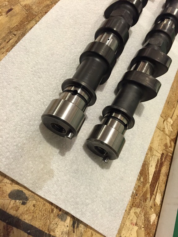

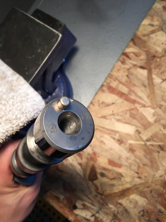

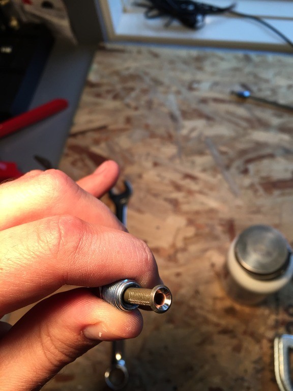

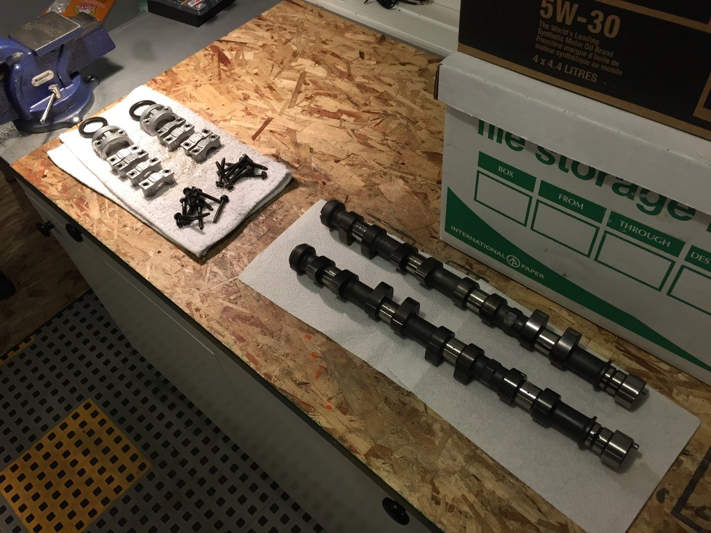

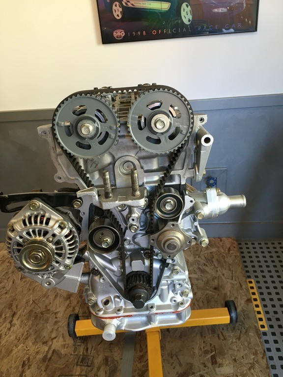

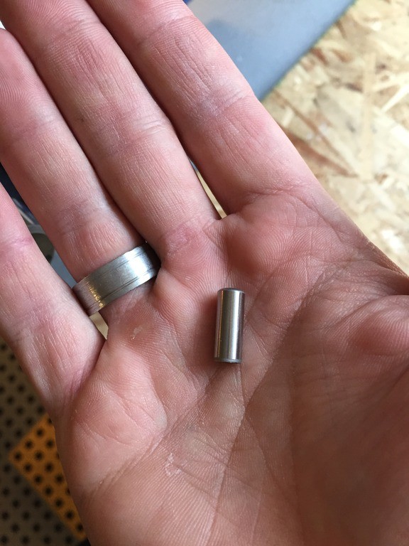

I have Integral stage 3 turbo Camshafts. They use the stock (puny) dowels. I decided to upgrade them to the dowels from a big block Chevy that I sourced from Mopac. Removed the stock dowels, had the holes machined out to the proper size, and installed the new ones.
Stock puny dowel next to the new and beefy one.
New dowel installed, and comparison to stock.

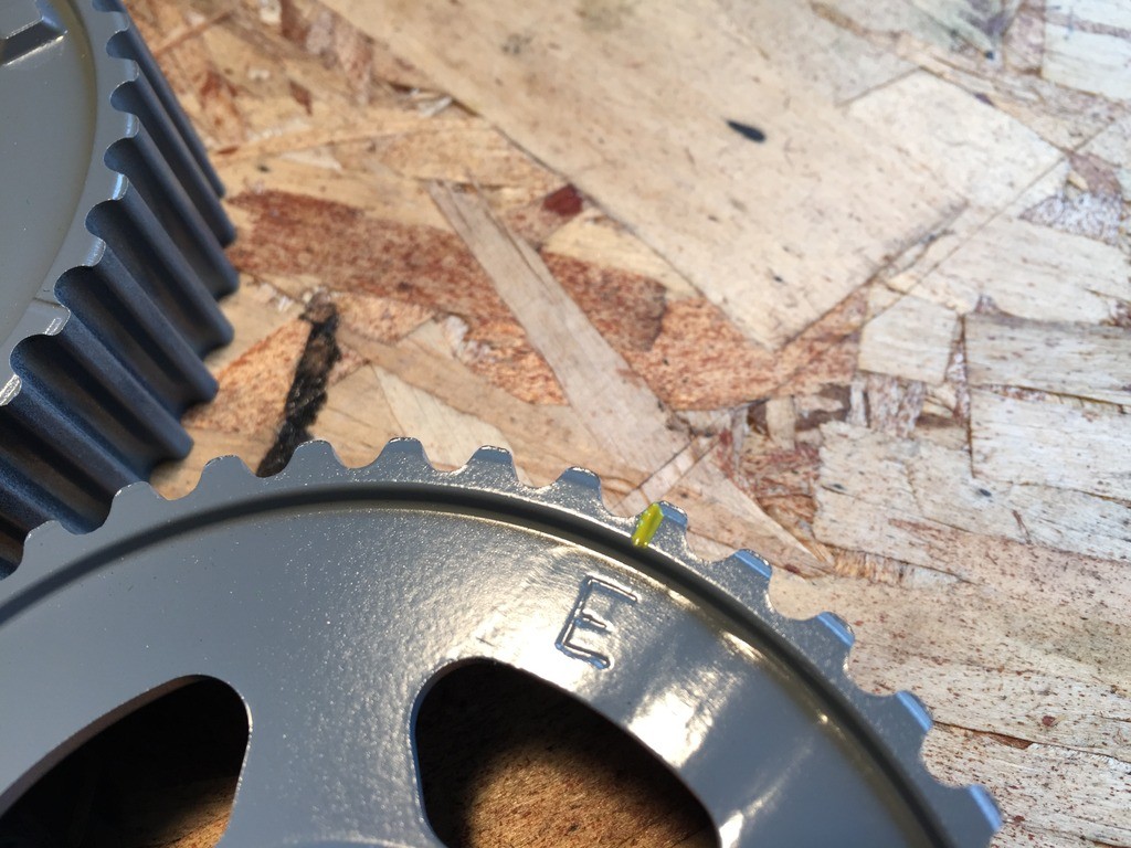

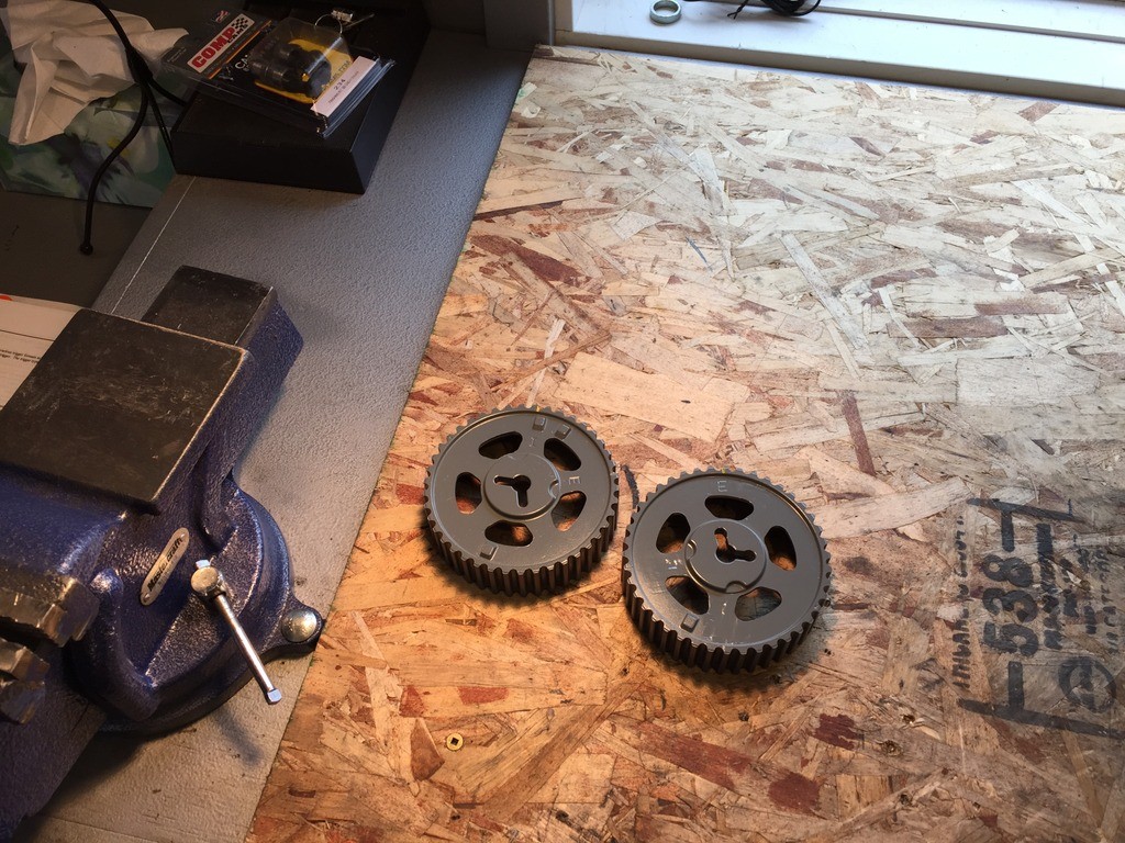

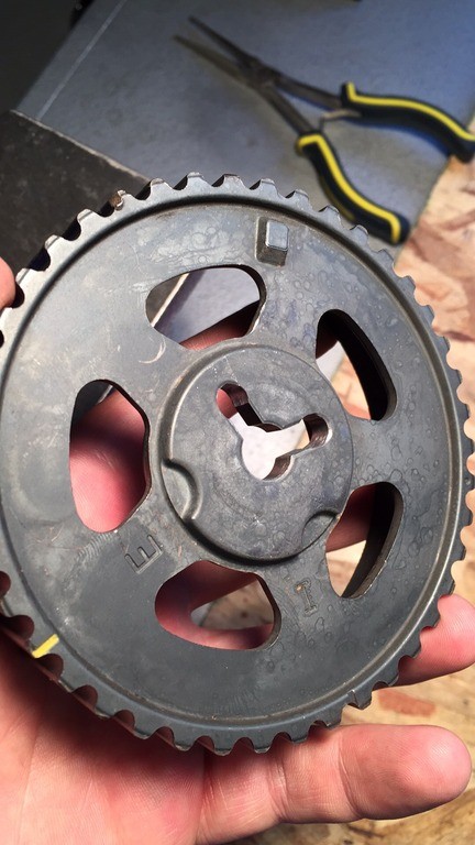

The cam gear needs to be modified to accept the larger dowel.

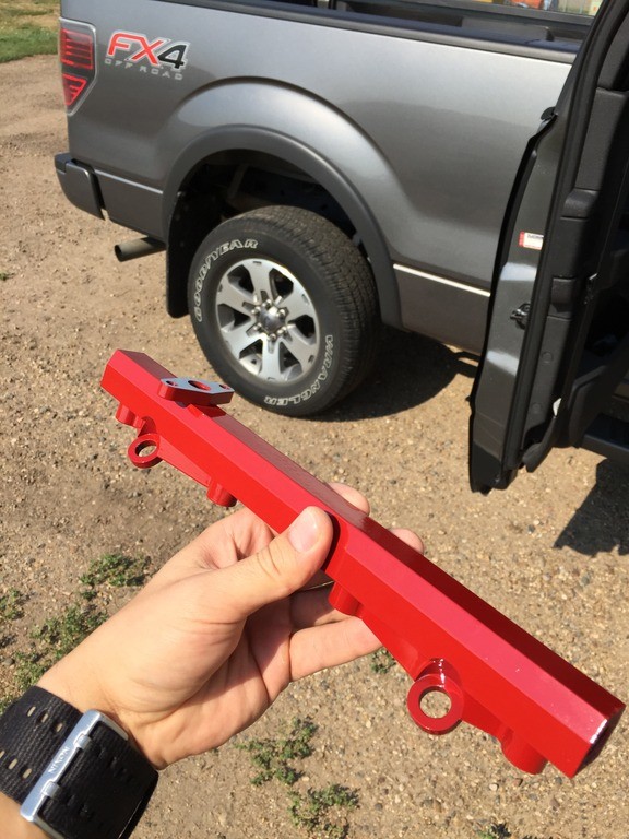

Had my Perrin fuel rail powdercoated, and I machined the pressure regulator mounting surface. The stock blue anodizing looked out of place against the rest of the s*** in my engine bay.
Got the cam gears modified for the thicker cam dowels, and coated.

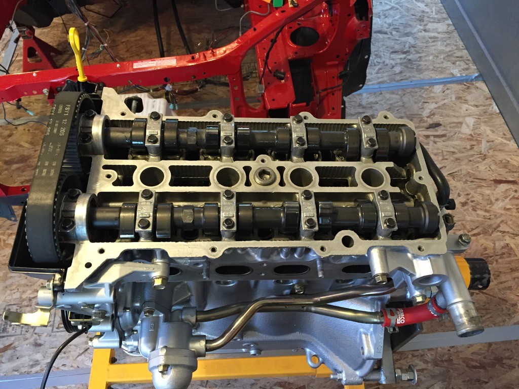

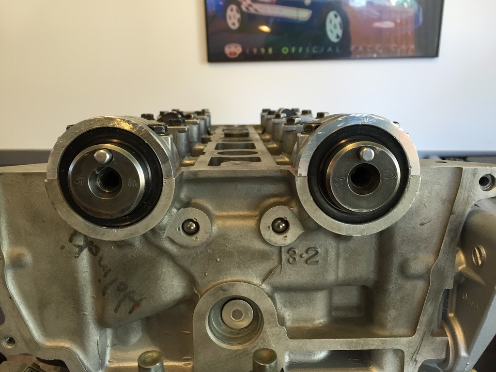

Both cams now modified with the big block Chevy dowel pins, all hardware cleaned and laid out. New cam seals installed.
Engine timed and ready to rip

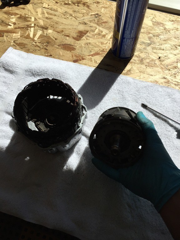

Sorry for the bad pic, but rebuilt the alternator and had the case powdercoated.
Engine completed minus a new crank pulley. She looks shiny!
