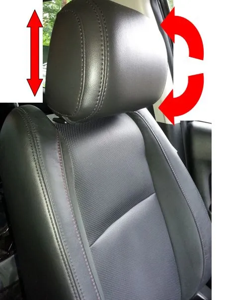

My buddy owns a car audio shop and one of his customers dumped their brand new Ford leather headrests
and replaced with LCD headrests. I asked my buddy if I can have them, he said sure he didn't have any use for them.
I figured maybe they might fit since Mazda and Ford worked together on the CX-9.
I find the CX-9 "fixed" angle headrest somewhat uncomfortable.
Kinda like this woman in this post:
http://www.chicagonow.com/drive-she-said/2012/07/todays-rant-headrests-in-the-mazda-cx-5/
Anyway, I did some research and the Ford headrest is 4-way adjustable:
http://content.usatoday.com/communities/driveon/post/2010/11/headrest-hassle-put-to-rest-by-adjustable-ford-explorer-head-restraints/1#.U7c8paJD9RA
http://www.edmunds.com/ford/explorer/2012/long-term-road-test/2012-ford-explorer-xlt-heavenly-headrests.html
The headrest posts center to center matches the CX-9 perfectly the posts are a bit tight into the seat holes, so need to ream the plastic just a little bit for them to slide up and down freely, but these are a lot more comfortable with the variable adjustments:

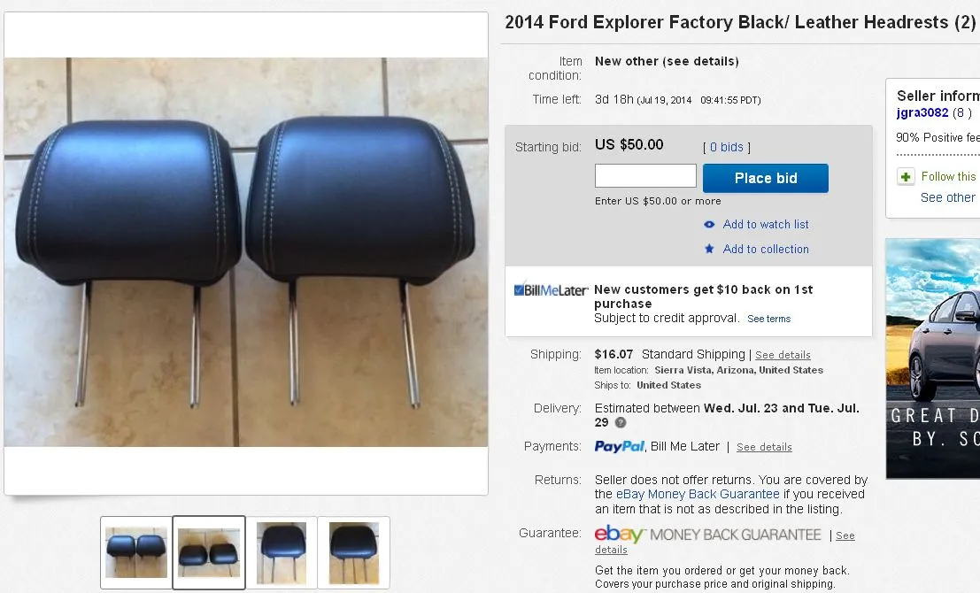

I did a quick search on eBay and see there are two black leather headrests, starting bid $50 for both,
I think they cost a lot more than that from the Ford dealer. Also, be careful, some Ford headrests have white thread stitching and the ones I got for free have black thread stitching, I got lucky and think the black stitching matches our CX-9s better.
http://www.ebay.com/itm/2014-Ford-Explorer-Factory-Black-Leather-Headrests-2-/271546922455?pt=Motors_Car_Truck_Parts_Accessories&hash=item3f397535d7&vxp=mtr
Also, just a friendly caveat, if you are going to do this mod, you will need to ream the CX-9 plastic headrest tubes,the Ford metal posts diameters DO NOT readily fit into the CX-9 tubes, the post center to center dimension is dead on but you need to ream the plastic tubes and shave off about 20 mils so the Ford posts can slide up and down easily. So if you are not handy with a Dewalt-type hand drill and reamer bit, do not attempt this mod.
