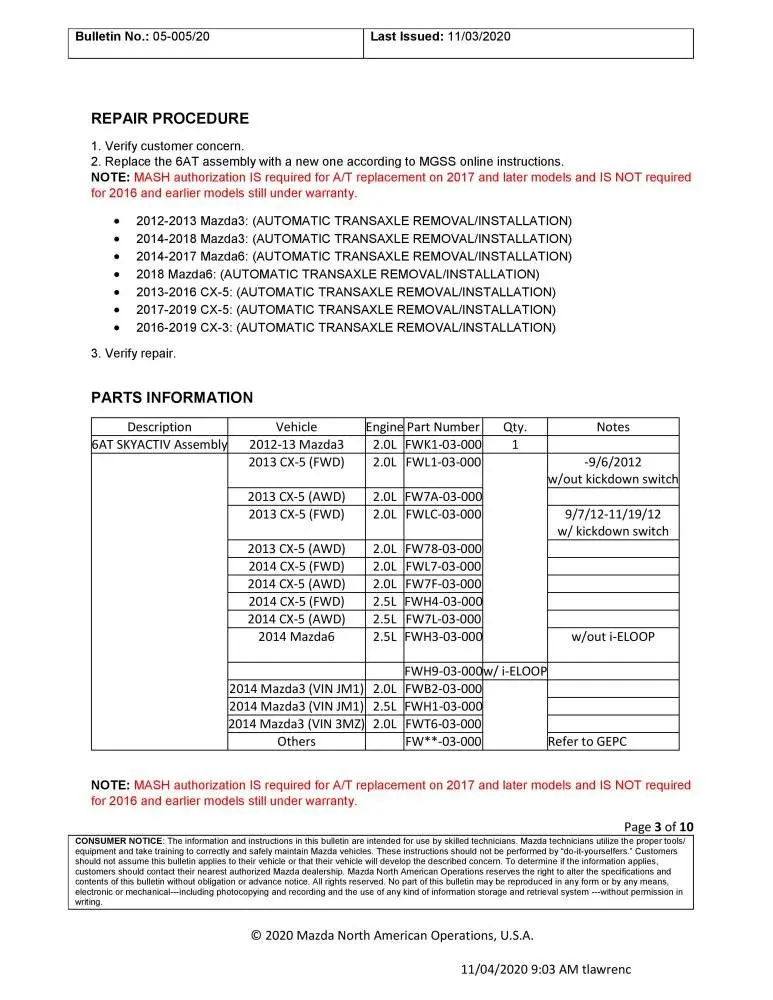

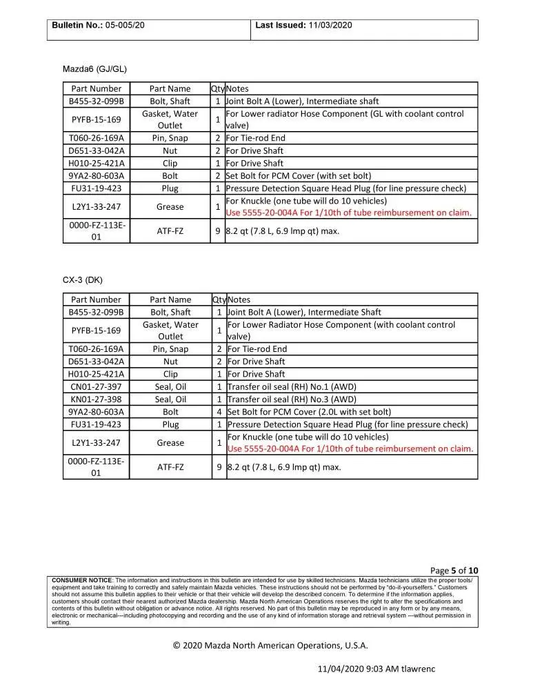

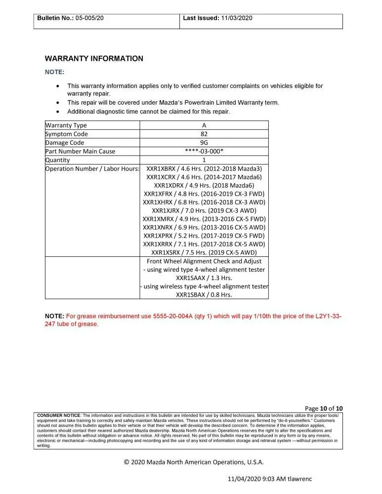

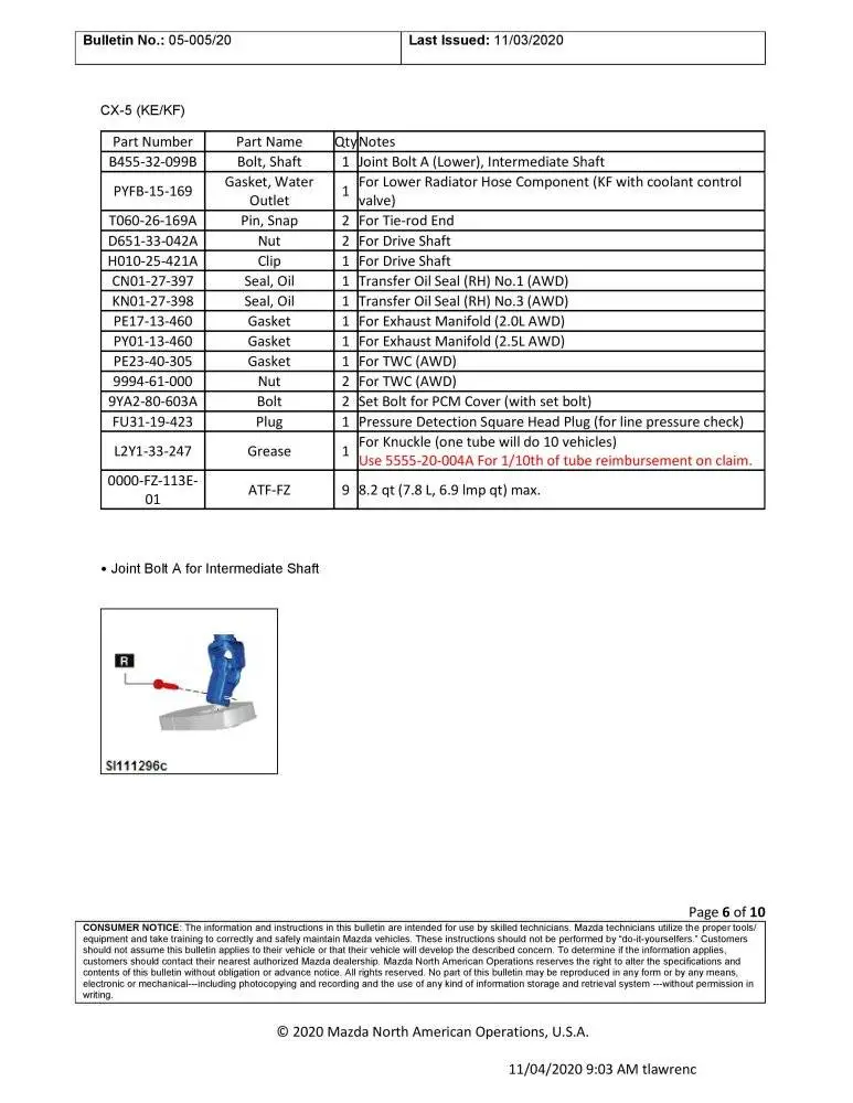

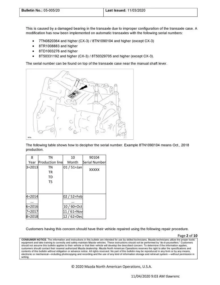

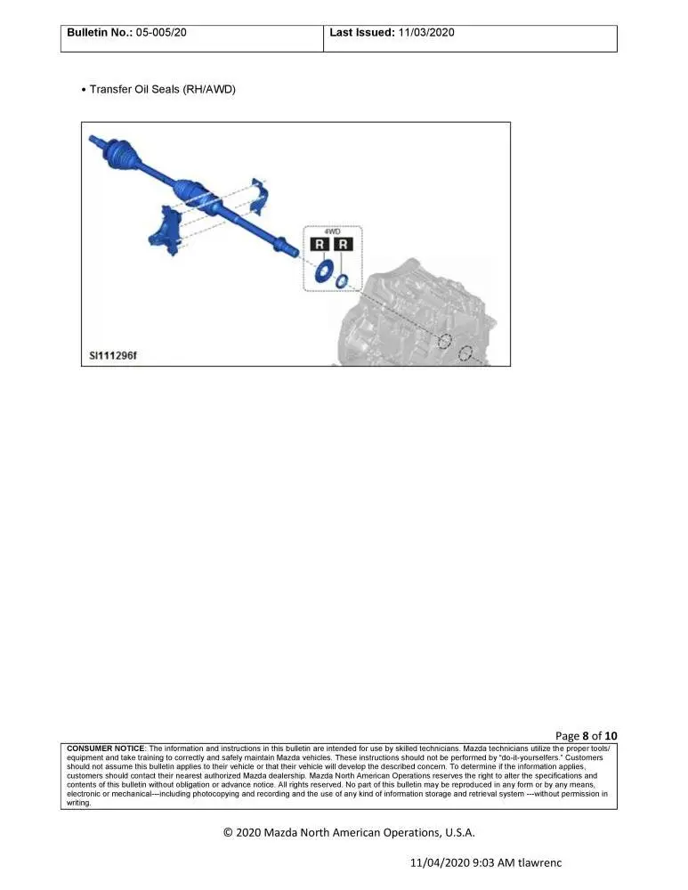

Noticed this whining noise TSB that simply has AT replacement as remedy
So this’s the 8th TSB for the same whining front input bearing problem which is caused by improper configuration of the transaxle case. The case modification had been mentioned as early as in 2014, and the problem still hasn’t been fixed and Mazda keeps modifying the case for all these years?
DESCRIPTION
This is caused by a damaged bearing in the transaxle due to improper configuration of the transaxle case. A modification has now been implemented on automatic transaxles with the following serial numbers:

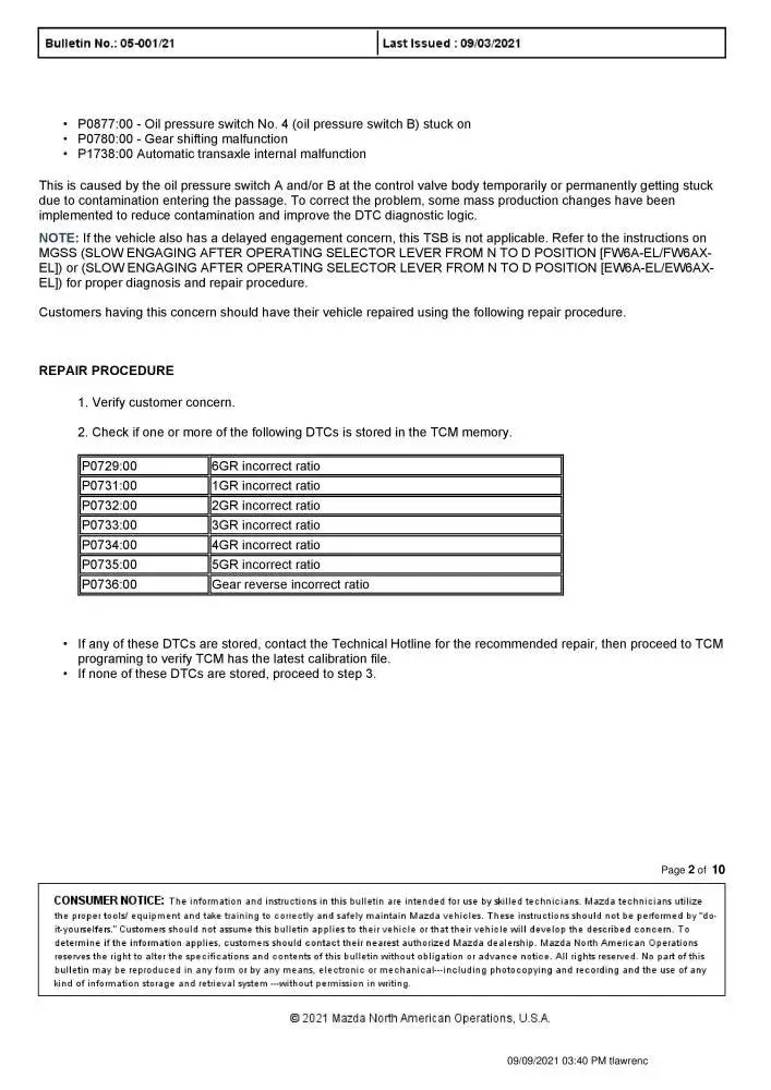

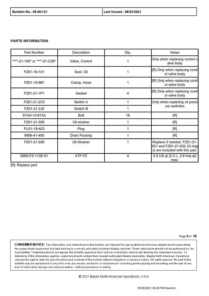

I think I am going to start doing 20-25k mile simple drain and fills. I last did basically full AT fluid swap back in 2019 at 50k miles... now at around 67k miles. One-offs seem to be in the 3-3.4 quart range on mine. I'm not sure if these pressure switches are simply being affected by normal clutch material in an AT or not. May drop the pan AT drain and fill after the next one.
Mine was like a steady dog whistling at any speed after about 10 mph which got me a trans replacement on my 2014
Hmm, may start doing ATF drain/fills more often then. No problems here, gearing up to do a drain/fill in a couple thousand more miles, but rather safe than sorry. Did 3 of them back around 71k and am at 108k now.

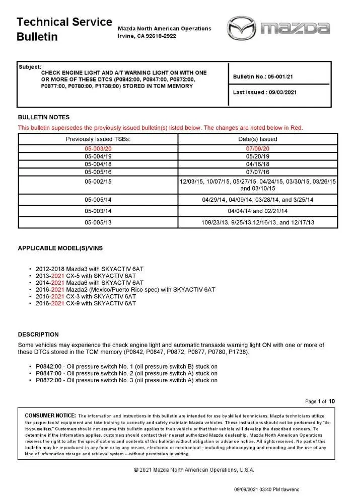

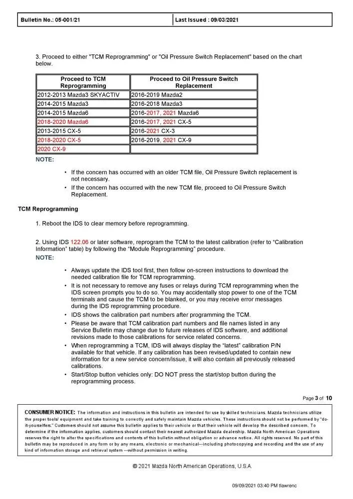

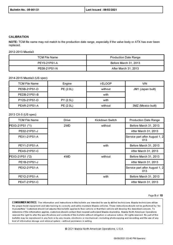

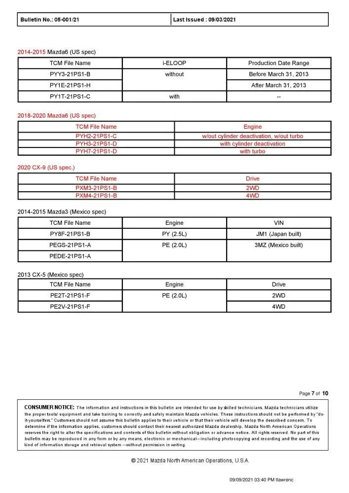

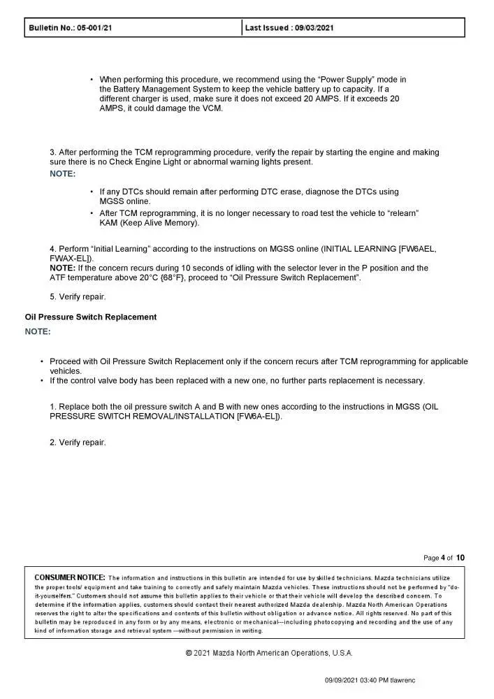

Being a little curious about the trouble code meanings and the effects of contamination, an internet search led to this:

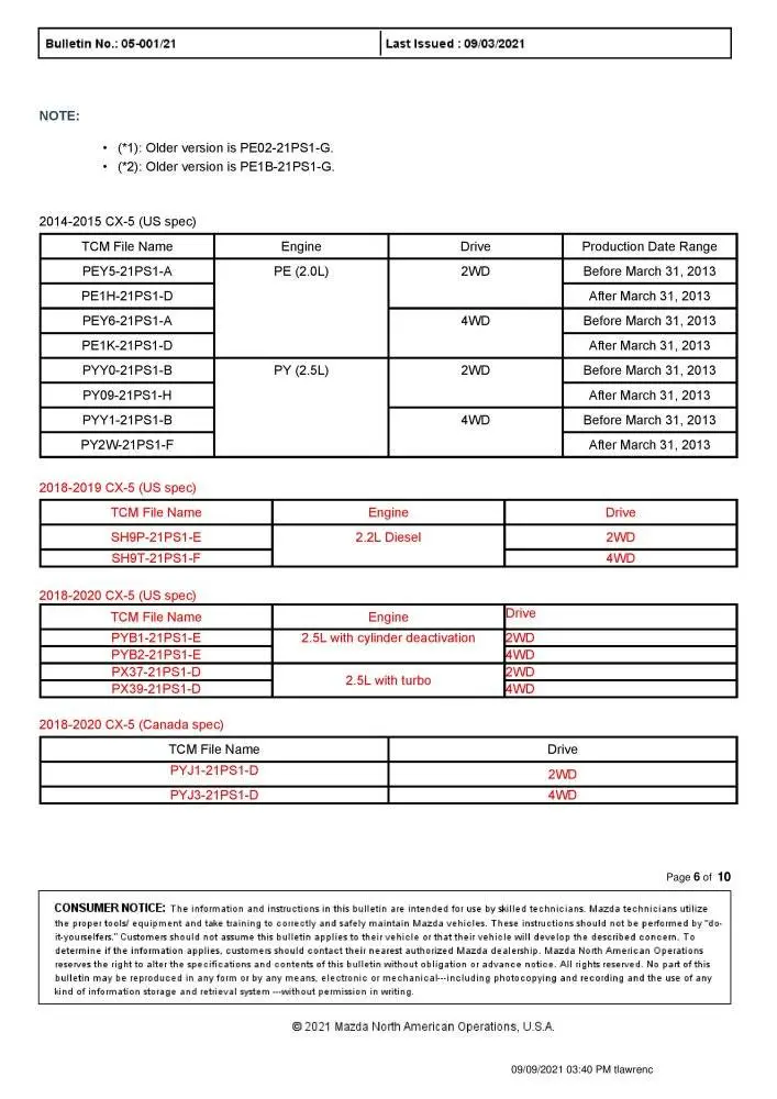

I guess this explains why the TCM is updated as mentioned in the TSB(s). There's probably more info somewhere on the great internet if one is inclined to search for it.

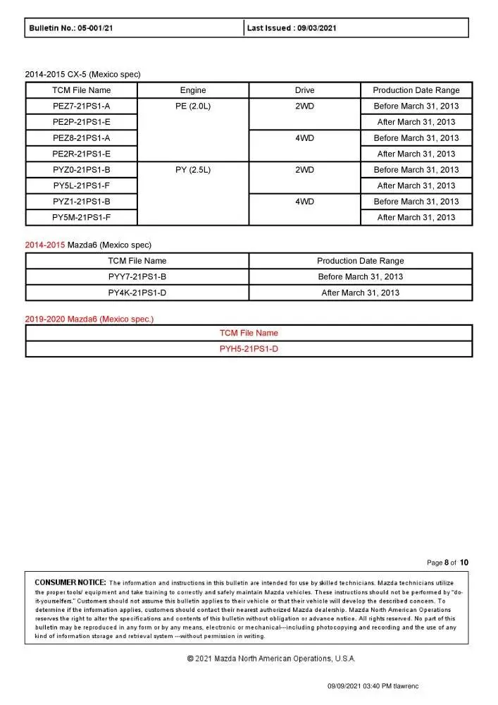

I'll probably take mine in to get flashed after next AT fluid change. I'll have to double check again but recall switch replacement isn't required for my model year to get update. I guess I'll be paying an hour for shop time
I updated the TCM on mine during the Holidays. Doesnt seem any different in shifting but at least its on the updated version.
For 2013-2015 and on 2018-2019 its only TCM update according to the TSB.
