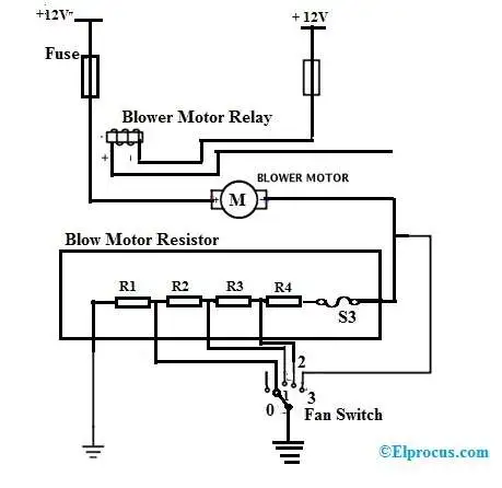

Here’s a typical schematic for the fan motor with resistors where their function is to change the fan motor speed. The more resistors connected in series will increase the resistance with the fan motor, hence reduces the motor speed. The direct connection skipping all resistors is for the highest fan speed. So if one of the resistors in the resistor pack blew, the current got cut, and the motor wouldn’t turn but only at the full speed without passing any resistors. The reason why the resistor pack is usually located in the air path that’s for better heat dissipation.
As for OP’s problem, it’s possible that the fan motor itself is failing by worn-out shaft and bearing due to high moisture environment which is common for the gen-1 CX-9. If the blower fan will not come on reliably, only intermittently at any speed, it can’t be the resistor pack. If the blower fan can only be started at the full speed immediately and consistently, but not on most or all lower speeds (depending which resistor blew), then the resistor pack could be the culprit.

Thank you yrwei52! This is very helpful. We ordered a new resistor and plan to replace (behind the glove compartment). Still waiting for delivery, but will report back when the new one is installed and we can test the blower function.
