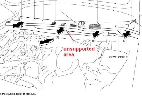

Interesting of seeing theses parts. I took a quick look at the hood last night and so far trying to support it at the rear edge is a bit more difficult since under is the plastic cowl grill. About 3 to 4" in I could feel the rear weather striping. We will see this weekend when I took a closer look

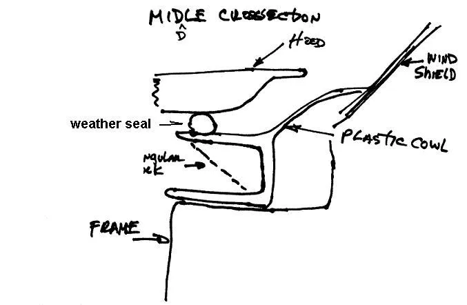

Thanks to Wannabe and SayNotoPistons I was able to see the hood TSB. However this does not apply to the 2014. It does make sense when the hood and the hood frame become separated because it was not enough. Kind of like a loose sail. However, yesterday I had a chance to do a family outing. I have found that at smooth highway at 70-80 mph there was no hood vibration. At rough sections I could see the hood vibrating at the center (at the wiper area.)
After returning I popped the hood and I realize that the plastic cowl is flexing when I push it down at the weather seal area. In my other cars the weather seal is attached to the frame directly. I think at rough roads the hood flexes but because the cowl also flexes it does nothing from supporting the hood. I am thinking in supporting the cowl with some rigid packing foam to stiffen the cowl. See attached picture to get the idea
here is what I am referring. At the middle there is a triangular molded stiffener in which the base is at the top. If you press the weather seal this stiffener does nothing because is not directly at the frame. (see cross section sketch)
