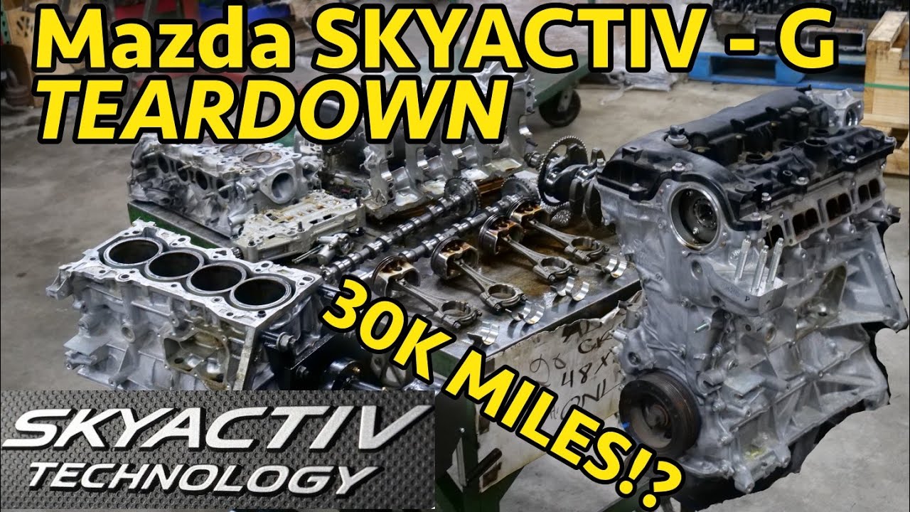

This video should help you to remove the cylinder head:
The damaged engine on cylinder #3 and #4 was having the similar problem, coolant mixed with oil, although it’s a newer 2.5L NA with CD.
Good video. The construction quality of the engine is impressive.
But one loose bolt at the corner of the cylinder head makes me feel otherwise on workmanship.
wow awesome, thanks. I looked all over for 2.5L Skyactiv videos and couldn't find much. Gonna be quite a different animal with the engine in the car, though.
