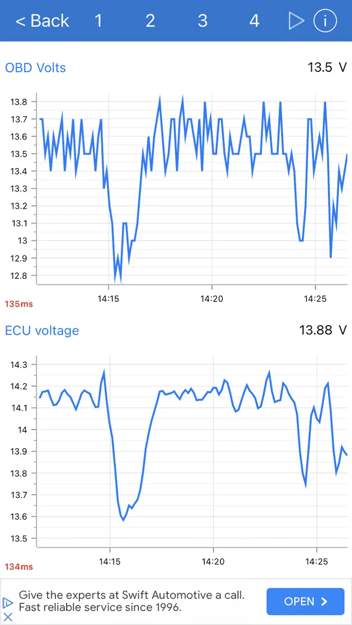

I've been driving around monitoring voltages with the scanner. I'm seeing a drop when I accelerate off the line. In the attached image you can see the dip at the left of the graphs. The dips at the right were another smaller acceleration around a corner. Is a dip under acceleration expected? I also noticed last night while parked and idling, my headlights dim slightly on occasion when the rpm dips ever so slightly during the "normal" idle cycle. Feels like more signs pointing to the alternator.

You definitely captured a very interesting and helpful test result! If you haven't already done so, here are some other things to check. The first would be the tension on the serpentine belt, and also the condition of it as well. Look for anything like glassy patches (indicating slipping), or damaged areas of the belt. Also, take a look the belt while the engine is idling, to check for wobble, particularly at the alternator pulley. And if it's not difficult on your vehicle, you might also consider releasing the tension on the serp belt, by removing it from the tensioner. Once the tension is off the belt, you can work the alternator pulley with you hand, checking for any sign of wobble.
Assuming you find no indication that the belt is slipping, IMO you've found enough evidence that the alternator is on the way out. A significant grounding issue is the only other thing I'm aware of that's in this ballpark, and there is some additional voltage drop testing that we haven't discussed yet, which you certainly can do if you want to run every possible DIY test.
If swapping the alt on your 5 is something you're up for doing, and you decide to go ahead with it, I recommend an OEM unit (reman or new). So find the alternator maker and part number on the I.D. plate. Then you can read through the specs for the various ones for sale on Rockauto, or other parts site you usually buy from, and make sure they're using that same part number.
