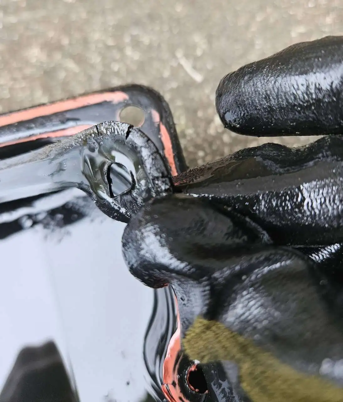

Fast forward 5 trouble and drip free years, at 164k (28k miles later) while doing an oil change I noticed a non-trivial amount of oil leaking from the transmission pan side. It was kind of a mess on the under tray. On closer inspection, I could see some cracking on the oil pan gasket. Checking the trans oil, it was about 1/2 quart low (this is what it took to bring the oil level up to normal on the trans dip stick). I re-torqued the oil pan bolts as I knew I wouldn't have time to get around to dropping the pan for some time.

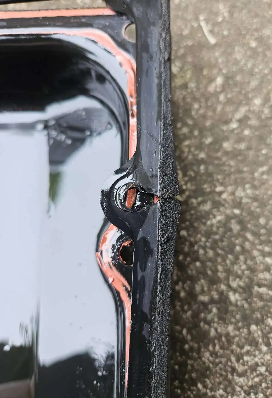

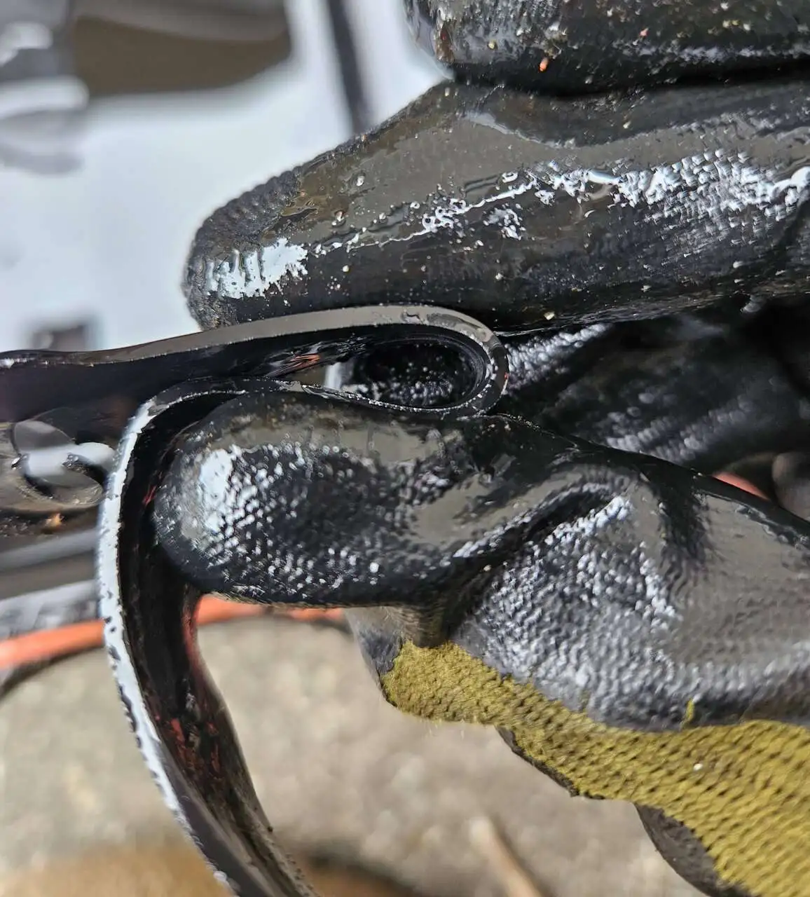

3k miles later, I went in to drop the oil pan and replace the gasket. I was surprised to see that re-torquing the bolts just about eliminated the leaking (there was a little, but no serious weeping or mess and the dip stick level looked good. When I got the pan off, it looks like the gasket was still nice and pliable in the areas covered under the oil pan mating surfaces. I could even bend it back on itself without it cracking. The parts of the gasket exposed were totally cooked and brittle and the areas around the bolt holes were deformed.

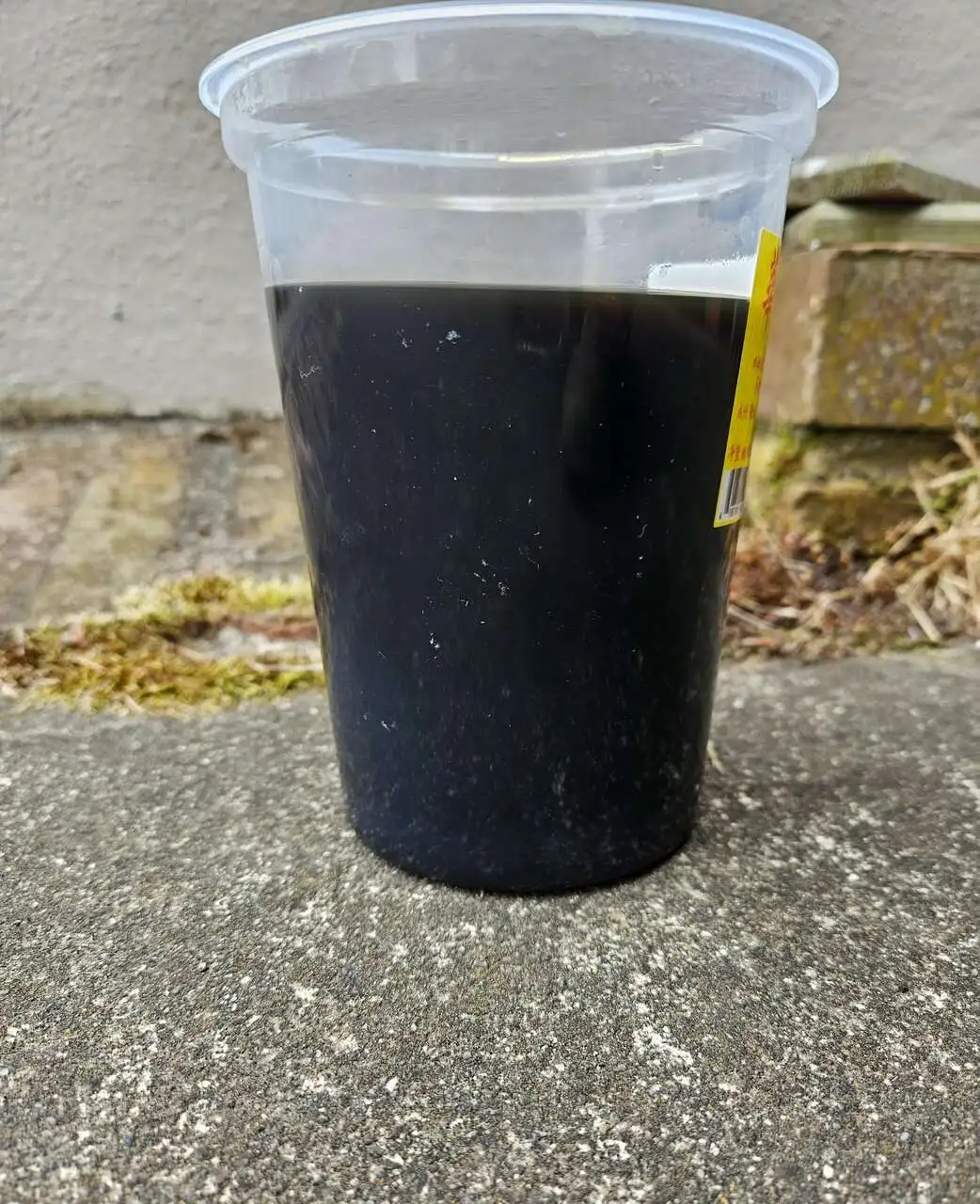

The oil was dirty, but no shavings/sediment. For what it's worth, I did not "flush" on the 1st change at 136k, just did a single fill after replacing the transmission filter. My plan was to just do a drain/fill without dropping the pan every 30k and change the transmission filter every 2nd or 3rd service (ie 60 or 90k miles)

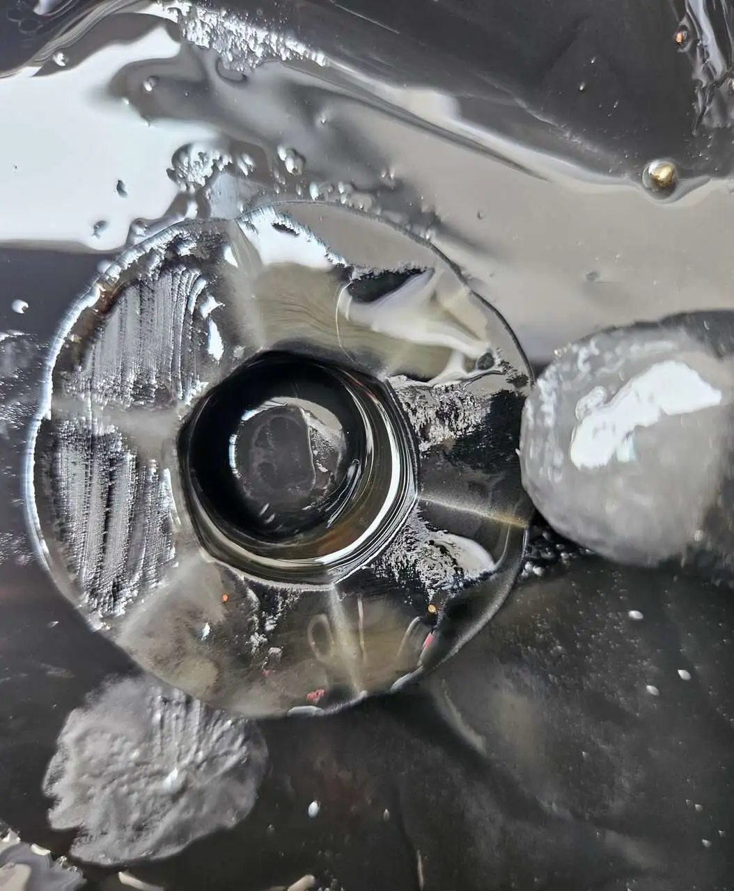

In the oil pan itself there were no metal shavings on the magnet this time around. There was the usual grey sludge, but no filings or anything solid. The transmission filter was also pretty clean looking. I didn't send for an oil analysis, but based on what I see, I would not spend the effort to change the transmission filter after the 1st time and would not have were it not for the leaky gasket.
