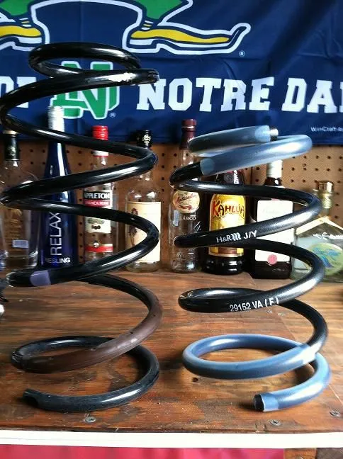

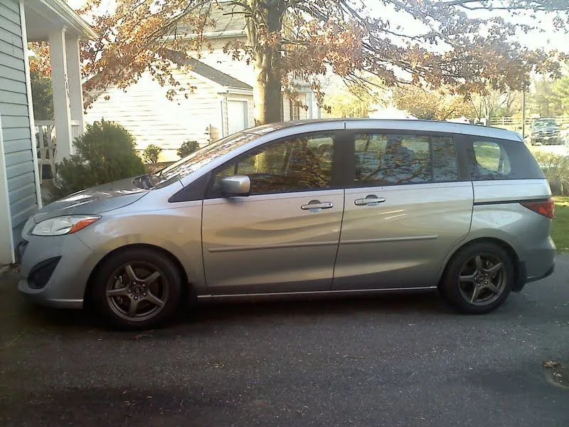

Well I Went Ahead And Purchased The H&R's For The Mazda5, And It Is A Really Nice Ride With The Stock Struts.
I Haven't Bottomed Out, It's Not Bouncey Or To Harsh. It Feels Pretty Close To A Stock Mazdaspeed3, I Went And Test Drove One
After I Put The Springs On Just To Feel The Difference Between The Two. If I Had The Mazdaspeed3 Wheels And Tires It Would
Ride Alot Better, The Stock 16's Sidewalls Give, But Provide a Quieter Ride!
Got The H&R's From CorkSport And Purchased Their Black Extended LugNuts!
Also Showing The Difference In Stock Front Spring To H&R!

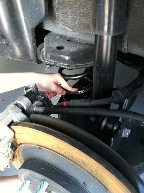

My Son Helped So He Got In The Pic Showing Off The Rear Springs After Install!

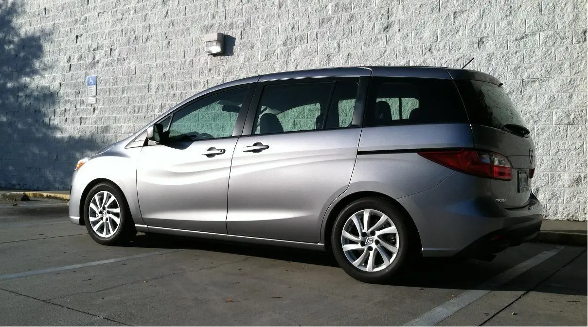

I just finished up installing the PN 52685 H&Rs on my 2012 Mazda 5.
I thought I'd write up some install tips because in searching for some before install I didn't find much. So some tips on the install.
FRONTS
- To get the front end up in the air safely, I first drove it up on my ramps. Then I was able to jack it from the center of the k-frame into the air and put the jack stands under the k-frame right inside where the inner control arm bushings reside at the edges of the k-frame.
- Once the front wheels are off, to get the struts off, disconnect the brake line from the strut (pull out clip, slide line down and out of the way). Disconnect stabilizer bar (15 mm) and move out of the way. Unplug ABS sensor. Remove bolt in pinch sleeve in bottom of strut. Take something large (like a jack handle) and place in the indentation in the knuckle right in front of the pinch sleeve. Pound on the jack handle and drive the knuckle pinch sleeve off the strut bottom. Then disconnect the top 3 strut bolts (NOTE - on the driver side you will need to take off 2 10mm nuts and swing the reservoir out of the way) and drop the strut out.
- The front springs are not bad to get off using spring compressors. I bought a set of Powerbuilt spring compressors for $30. These have u-bolts with threaded ends that secure to the spring. I felt much more comfortable using these. As always, BE VERY CAREFUL using spring compressors. Put them on opposite sides of the springs. Make sure the u-bolts are tightened down. Do a few turns on one side, and a few turns on the other, trying to keep them equal.
- When reassembling, the H&R lowering spring does not need to be compressed. Just put it on the strut and you can put the mount on. Make sure you get the upper strut mount on correctly. It has a little tab at the back of strut mount that goes towards the back.
- The bottom of the strut goes back into the aforementioned pinch sleeve. It is a TIGHT fit. What I found works best is some WD-40 or silicone lubricant on the strut and inside of the sleeve. Put one of the upper strut bolts in. Put the strut bottom in the pinch sleeve. Work the knuckle back and forth some and get the strut about a 1/4 inch in. Make sure the back tang on the strut is sliding through the opening in the pinch sleeve. Then put the other upper strut mount bolts in and tighten them down snug. Put a floor jack under the control arm and jack up on the arm until it starts to come up. The tap LIGHTLY on the knuckle. The strut should start dropping little by little into the pinch sleeve.
REAR SPRINGS
- There is a plate under the rear that I put the floor jack on. Once in the air, I put the jack stands under the cross member. You want the rear end up reasonably high to get the springs out. I used large 6 TON jack stands for this with them raised up one notch. I like these bigger jack stands for jobs like this because I think they are much more stable than the regular size stands raised several notches.
- After the rear wheels are off, disconnect the rear stabilizer bar from both rear trailing arms at the top. It will spin after you first loosen it. To get it off, a metric allen socket can be used to hold the stud so you can get the nut off. Push the sway bar down and forward towards the front of the car.
- Put a jack under the rear trailing arm where it connects to the knuckle, raise it just enough so it makes contact. Take the 17 mm bolt out. Then drop the jack slowly and it will get low enough so the spring just falls out.
- When you install the rear H&Rs, the dead coils (the ones that are really close together) go on the TOP.
- To get trailing arm back into where it mounts, you will probably have to push the jack forward a bit as you jack the arm back into place. The arm, once out of the knuckle, pushes back a bit and won't line up without a bit of pressure pushing it forward as you raise it.
Hopefully this is of help. I've attached a pic of the finished product.

Having driven mine for a bit now with the lowering springs, there is a definite noticeable difference in ride and handling. The ride is definitely stiffer and choppier. I don't find it uncomfortable though. The handling though is much improved, even with the stock 205 55 16s I have on my car. If you already have 205 50 17s on your car I would think the handling with lowering springs would be that much better. Are the stock 205 50 17s the touring pkg comes with V or Z rated?
