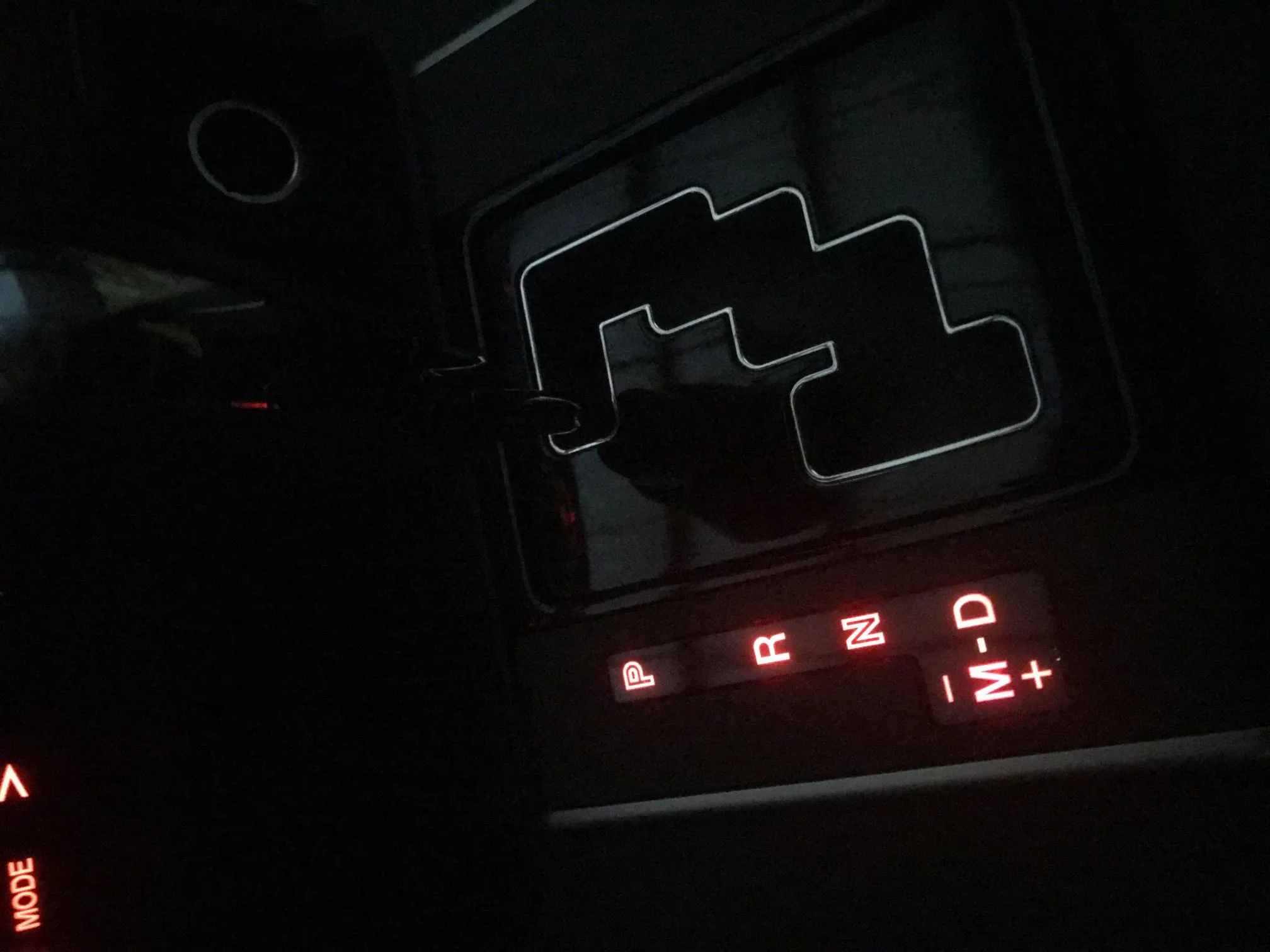

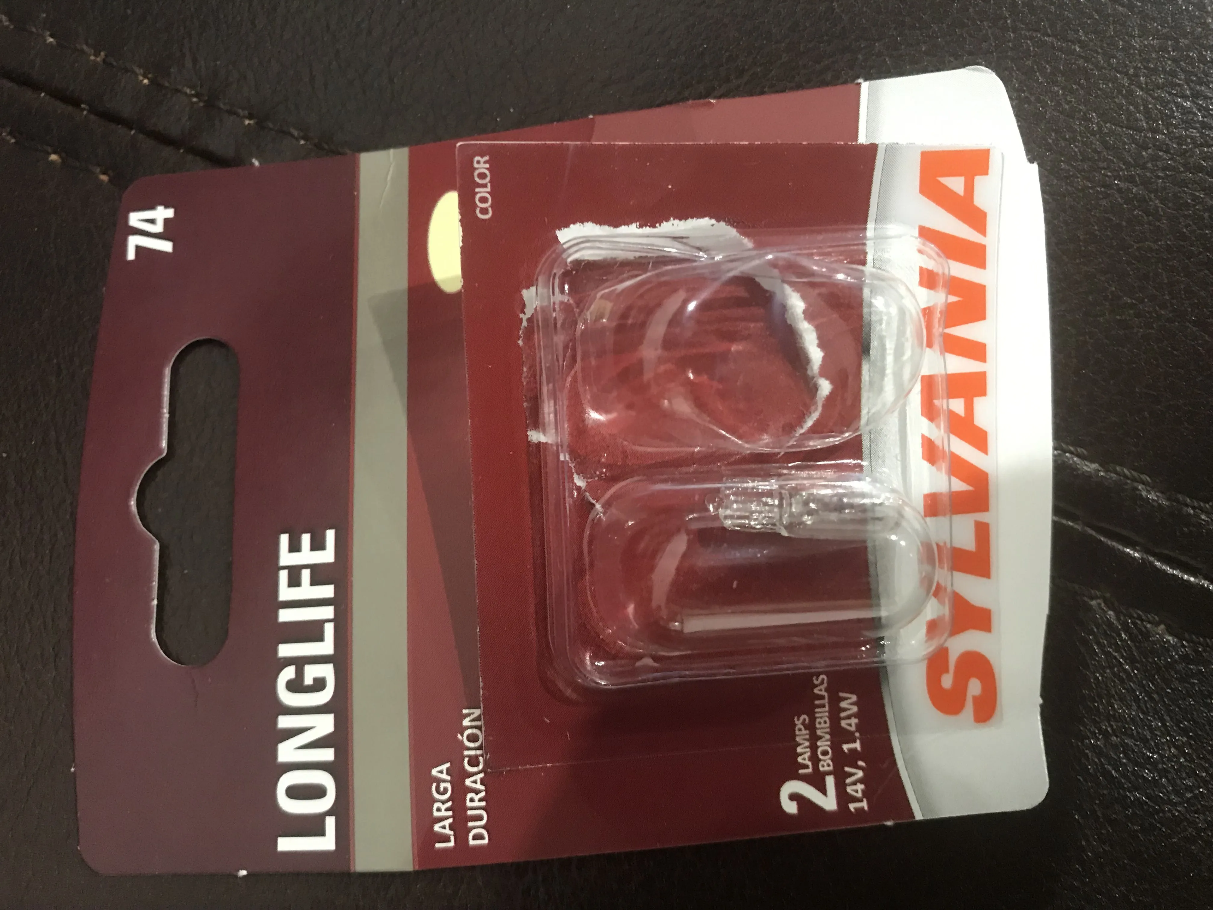

great video.......I got the bulb out and went to Advance Auto Parts ( any parts store will do) and just matched the bulb up......Bulb #74 from Sylvania
Hint.....go on Ebay and look for a CX-9 shifter assembly for sale.....you can see pictures where the attaching studs are so you know where to pry up the top plate.
I use plastic trim removal tools bought cheap at Harbor Freight
