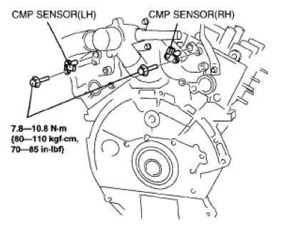

Wait, what code number? CRANKshaft (CKP) or CAMshaft position sensor? I'm going to assume it's the CAM sensors you're talking about as the CRANKshaft position sensor is underneath the engine.
Your CAMshaft position sensors are in the same place as the 2008 3.7L engine. You do not need to pull the valve covers, but will likely need to pull the air cleaner.

Once you loosen the retaining bolt for the sensor it should just pull out. There is an o-ring that needs to be lubricated, so it may just be stuck.

CPS problems can sometimes be frustrating to troubleshoot. Mine are fine on the CX-9, but I had a BMW once that used to die unexpectedly without codes and it all came down to a flaky CPS. Hopefully yours is not something more than a flaky sensor or wiring. Sensors are around $80 to replace, while a bad PCM will cost upwards of $600. Swapping the sensors is also where I would start.
If you ohm'd out the sensors and they fell within spec (800-1,320 ohms), then your troubles may be elsewhere, but that's not a guarantee. Have fun and let us know what you find.

Thanks. Now I'm wondering what I was looking at? Cylinder thingy sticking up from the passenger side of both banks with electrical connectors on it.

Now that I have the manual to look through, I think I was looking at the OCV. I'm guessing that's for some sort of variable valve feature. I'll do the proper inspection on the CMP tonight.

Yep, you were looking at the OCV solenoids that control the oil going to the VVTs. LOL, I should have caught that when you said they were poking through the valve covers. Be thankful you're not concerned with those yet.
