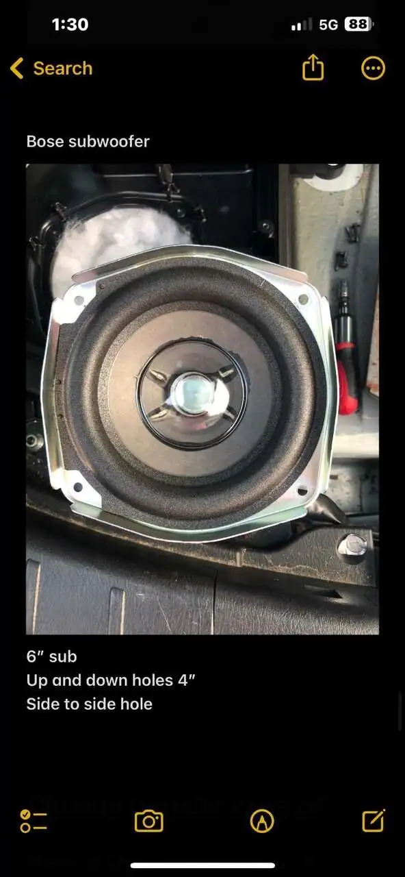

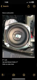

I do however, like the sound of the Bose subwoofer but, I cannot find any replacement aftermarket sub for the 2012 cx9.
Would anyone have any idea what size speaker or sub would fit in that hole in the back?
Even if it was a mid range woofer I would be happy just putting something aftermarket in?
Crutchfield said my front speakers are 3.4 ohm so I believe all speakers should be roughly that and I have been buying 3-ohm speakers.
Not sure if that info is helpful or not but pic of the bose subwoofer is attached. The sub appears to be 6 inches from top to bottom and side to side obviously but not sure if I can find one with the right hole placement for screwing down.
