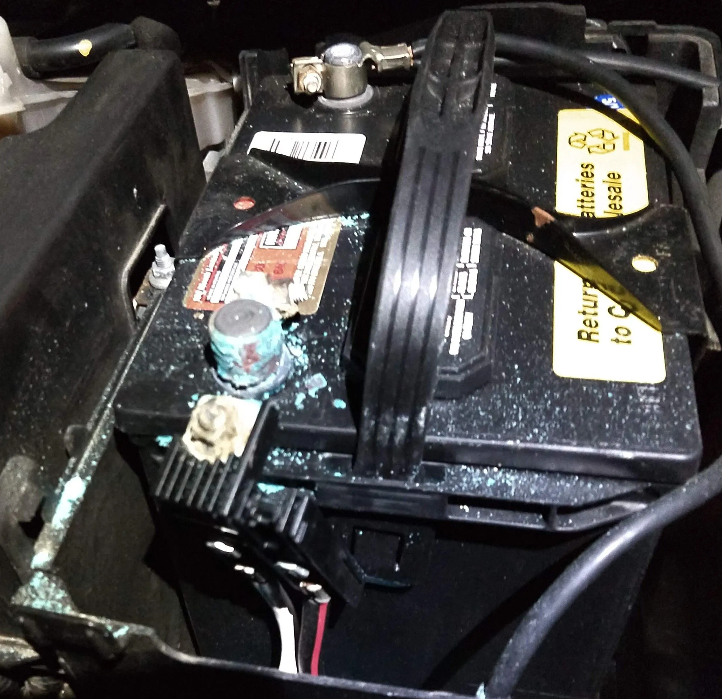

Battery Terminal Corrosion - Cause? What are the White & Red wires for?
Our 2010 Mazda 3 had no power yesterday and after opening the battery compartment, I found the + cable was no longer connected to the battery terminal. I had inspected the terminal for corrosion in the spring and it was clean. Around 2018, Labor Day weekend, the car wouldn't start and I found some green powder caked up around the battery terminal connection and cleaned it off and put some petroleum jelly on the positive terminal to prevent corrosion.
NOTE: this is a replacement battery I purchased from Costco that was installed around 2015. I had the same battery installed in my previous 2011 Mazda 3i Touring; and never experienced this problem - I usually did park in the opposite direction than my wife so maybe this prevented the problem my wife's experiencing. See #1 below.
I have several questions:
1. the problem occurred after a hot summer in both cases - is it possible that parking the car facing slightly downhill caused some acid to leak out of the vent caps onto the terminal connection? Note the fluid path is such that it would accumulate on the terminal connection since the parking spot slopes from the driver's side to the passenger side (the hill slopes downhill in this direction).
2. Where does one find a replacement terminal connector? I searched multiple online Mazda parts sites and there isn't anything "Battery" related under the "Eletrical" Category.
3. Is it necessary to use the OEM part? There should be a reason why the black plastic part containing the Red and White Cables, appears to a heat sink? Why is there a White cable at all?
Thanks in advance!
1a. How often do you check the battery to ensure that each cell's water/acid level is correct? I check my battery at every oil change. Letting a cell go dry will reduce the life of the battery.
1b. Overfilling of one or more cells could cause corrosion from loose-fitting/leaking caps.
1c. A crack in the battery case could allow corrosive gas to corrode the terminals. Check for any liquid on top of the battery, near the caps. Fully charge the battery after properly filling the cells with distilled water, if needed.
2. Your local auto parts store should have generic ones. Ask if they have the same style as the OEM. If necessary, pick one up at the dealership, but the online dealership parts sales should have them. If you can't find it on their sight, give them a call.
3. I would use the OEM style if it includes an attachment point for the white wire.
By the way, under high ambient conditions, 4 years of battery life is fairly typical. Many folks in Arizona replace car batteries every 3 years.
There is a bank of terminal connectors and generic battery cables at any auto parts store. I would also use a torch and solder it onto the old harness. Crimping only...it'll probably corrode after some time.
If you want OEM, you will almost certainly have to get a wiring harness. That will fix it though. Better than a terminal. Dunno how costly.
-Mike
Yesterday, I called up a Mazda dealer and the Parts guy was able to explain that the wiring harness contained the Main Fuse in the black plastic thing and the clamp could be detached. I was able to remove it using some water pump pliers and a box wrench. It took some searching at the auto parts store; however, I found a Top mount terminal clamp that had an attachment to the OEM bracket. Everything is working again.
Hopefully, the bad connection was the cause of the electrical problems I mentioned up thread. Thanks for your help!
