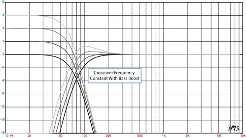

"5. The subwoofer level control in MS-8 isn't a level control for the subwoofer output channels. It's a shelving filter that boosts bass in ALL channels below 60Hz, but never above 160 Hz. When you boost or cut, the slope of the filter is adjusted. This helps to maintain the illusion of bass up front by sending the appropriate amount of midbass to the front speakers and bass to the subwoofers. It also maintains the crossover point. Here are a couple of graphs that illustrate this and why it's better.
The first one is a conventional control. It's pretty obvious why this moves the image of the bass to the back and sounds boomy. There's too much interaction between sub and midbass. This is why people claim that "underlapping" the bass is important and why so many people try to get big-assed midbass drivers in the front of the car and cross the sub at 50Hz. With MS-8, that's totally unnecessary, and the evidence of that is in the second graph.

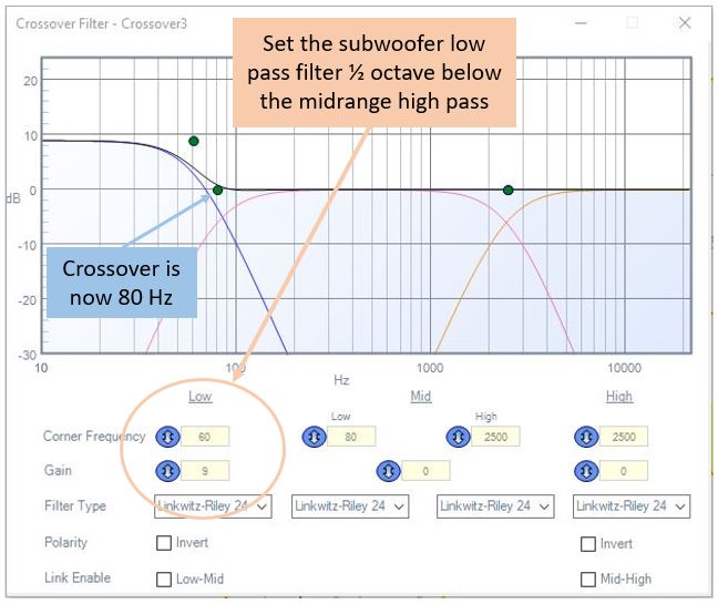

mzmtg said:
In an effort to get some headroom back on the head unit's "preamp", I followed Andy's advice for those that don't have a low pass shelf filter in their DSP. I lowered the subwoofer cutoff frequency half an octave below the midrange HPF, so 60Hz and 80Hz, repsectivley and then turned the gain up on the subwoofer amplifier channels to get my +9db (or so) boost there.
This way I could get rid of the big boost in my EQ at 63Hz.
So with these EQ settings, I got this response:
2018-02-20 Whitledge Filters by ben.garner, on Flickr
2018-02-21 FR with subs up by ben.garner, on Flickr
I definitely have the headroom back in the head unit to play louder overall, but the subwoofer is not nearly as well integrated as it was before.
