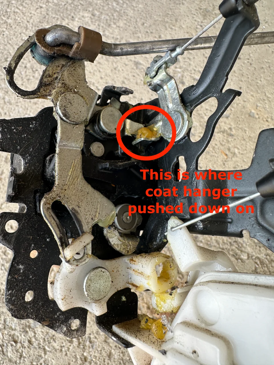

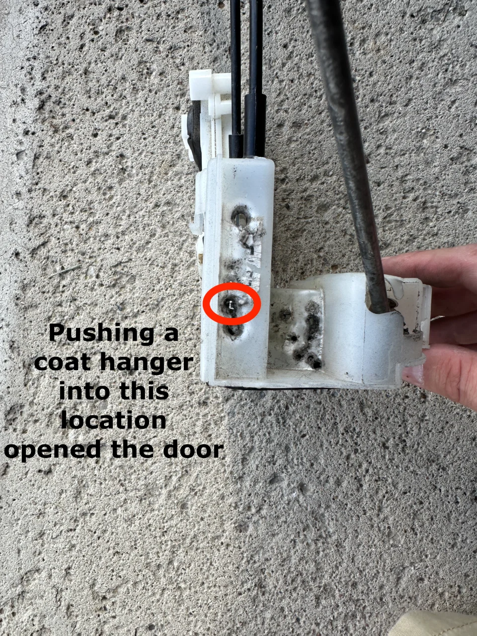

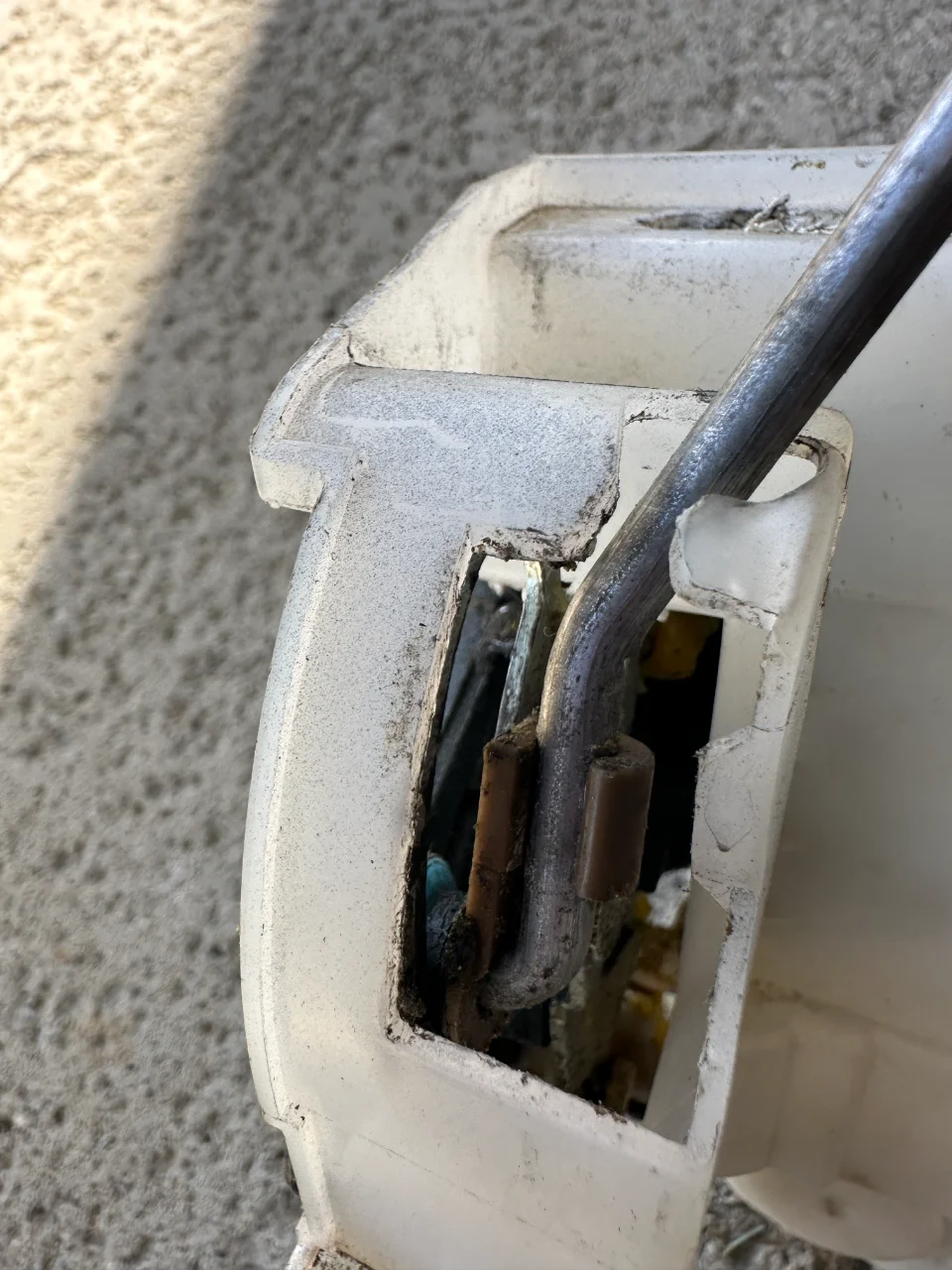

Now I could see the top of the lock actuator but didn't know what to do. This video below encouraged me to make random holes into the top of the lock actuator plastic housing - I did so by poking holes into it with a 2ft long torx driver I had.
The above video was the most helpful - especially around 4:15 mark. Once I had some holes made in the top of the plastic housing of the actuator, I used a coat hanger to just poke at stuff though the holes. The fifth hole I made I magically hit something inside that popped the door open! Then I was able to disassemble the door property, remove the remains of the broken exterior door handle, removed lock actuator.

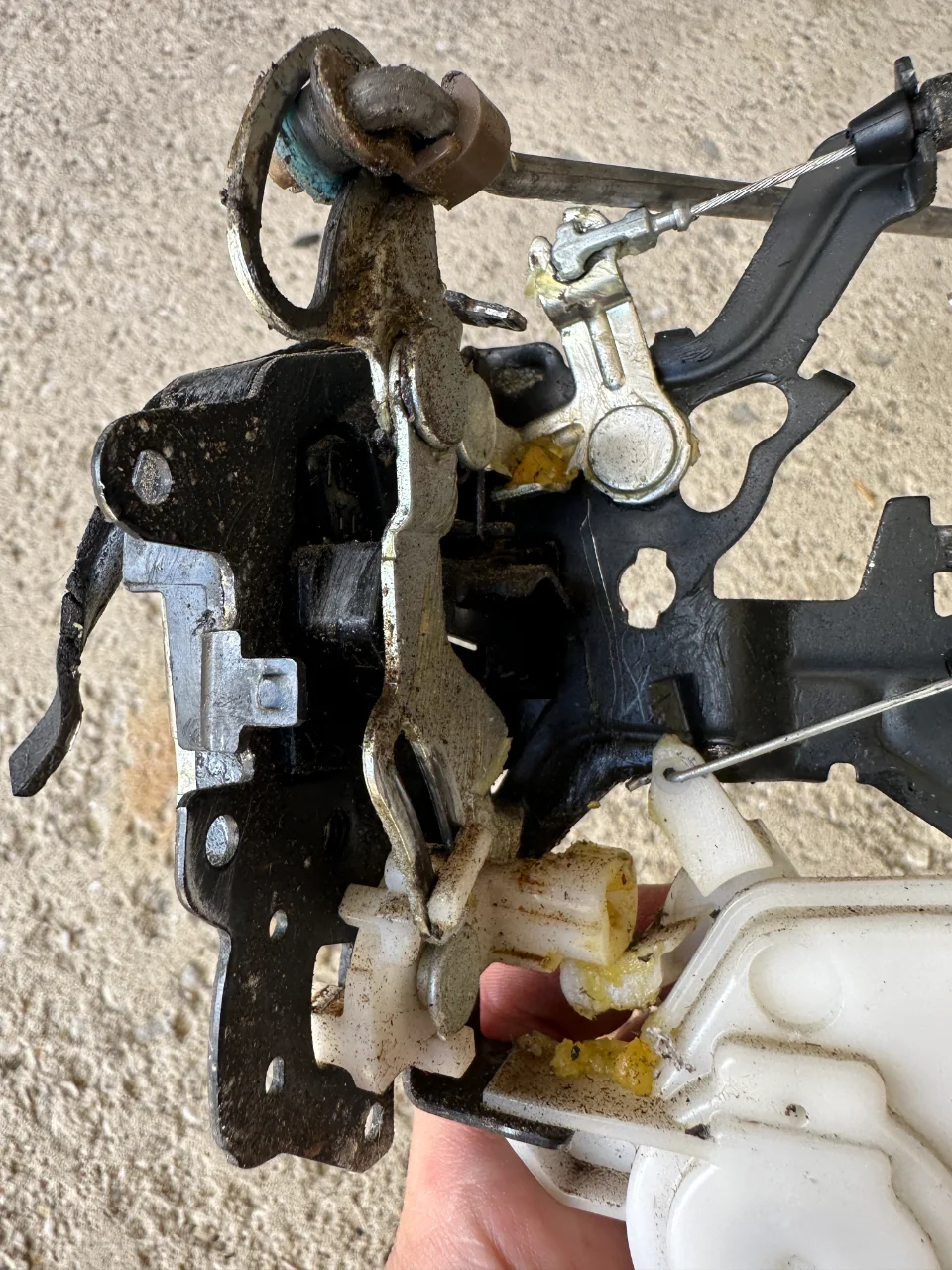

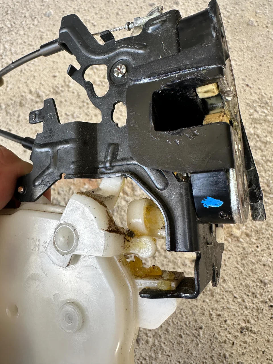

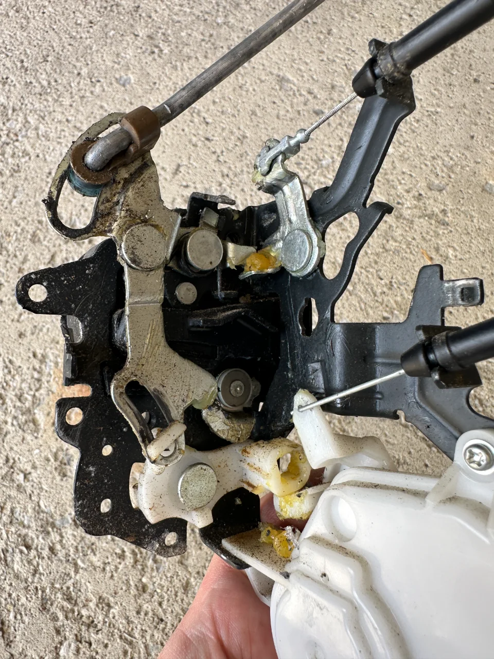

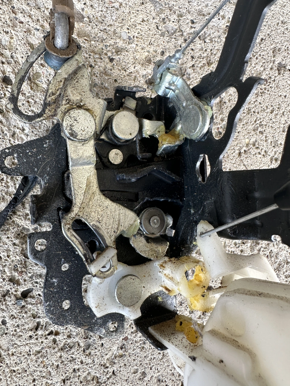

The exterior door handle has a spring on it, and the plastic around the spring was just gone - I found bits of plastic and the spring inside the bottom of the door. Same failure as my driver side door.

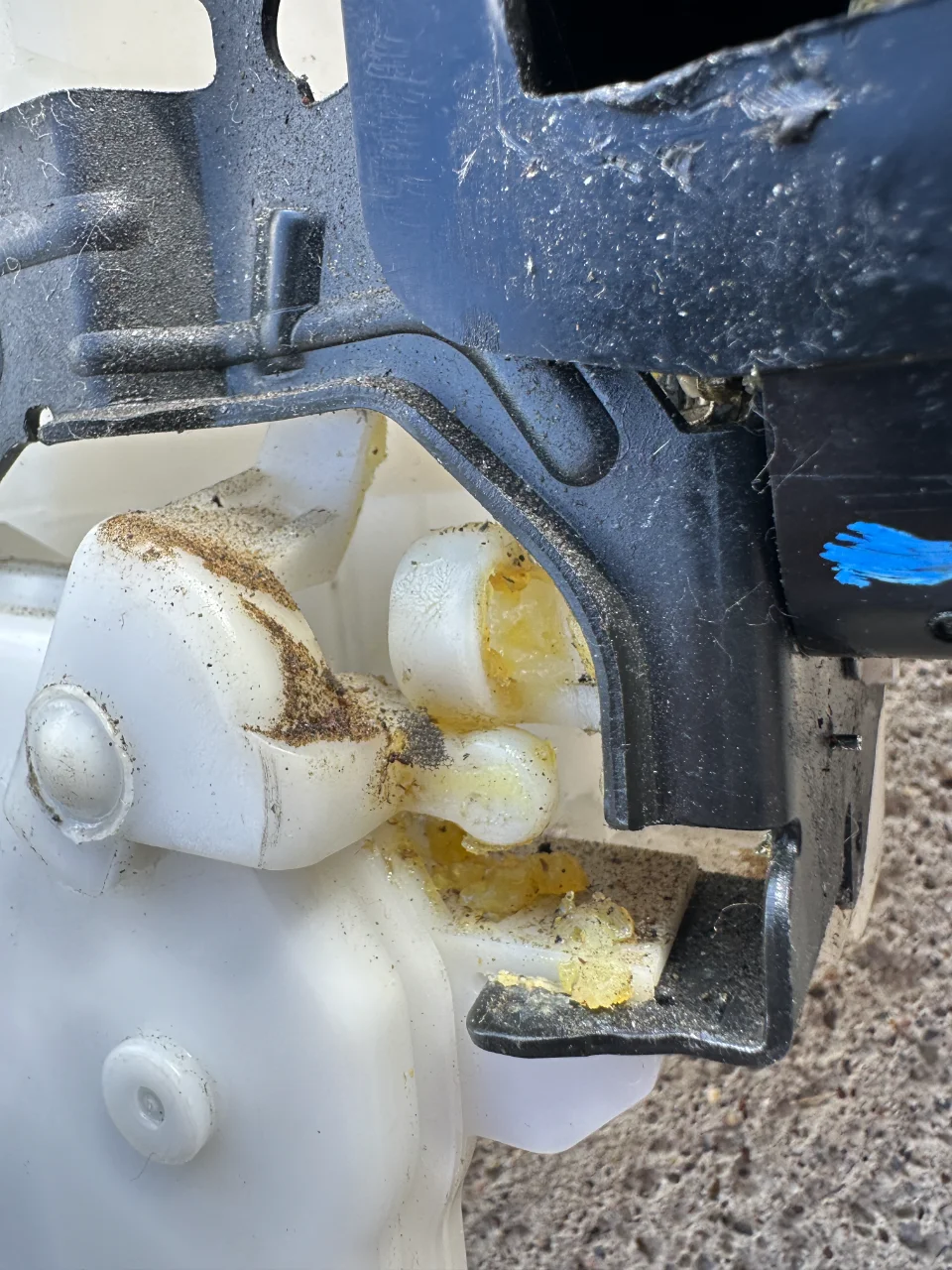

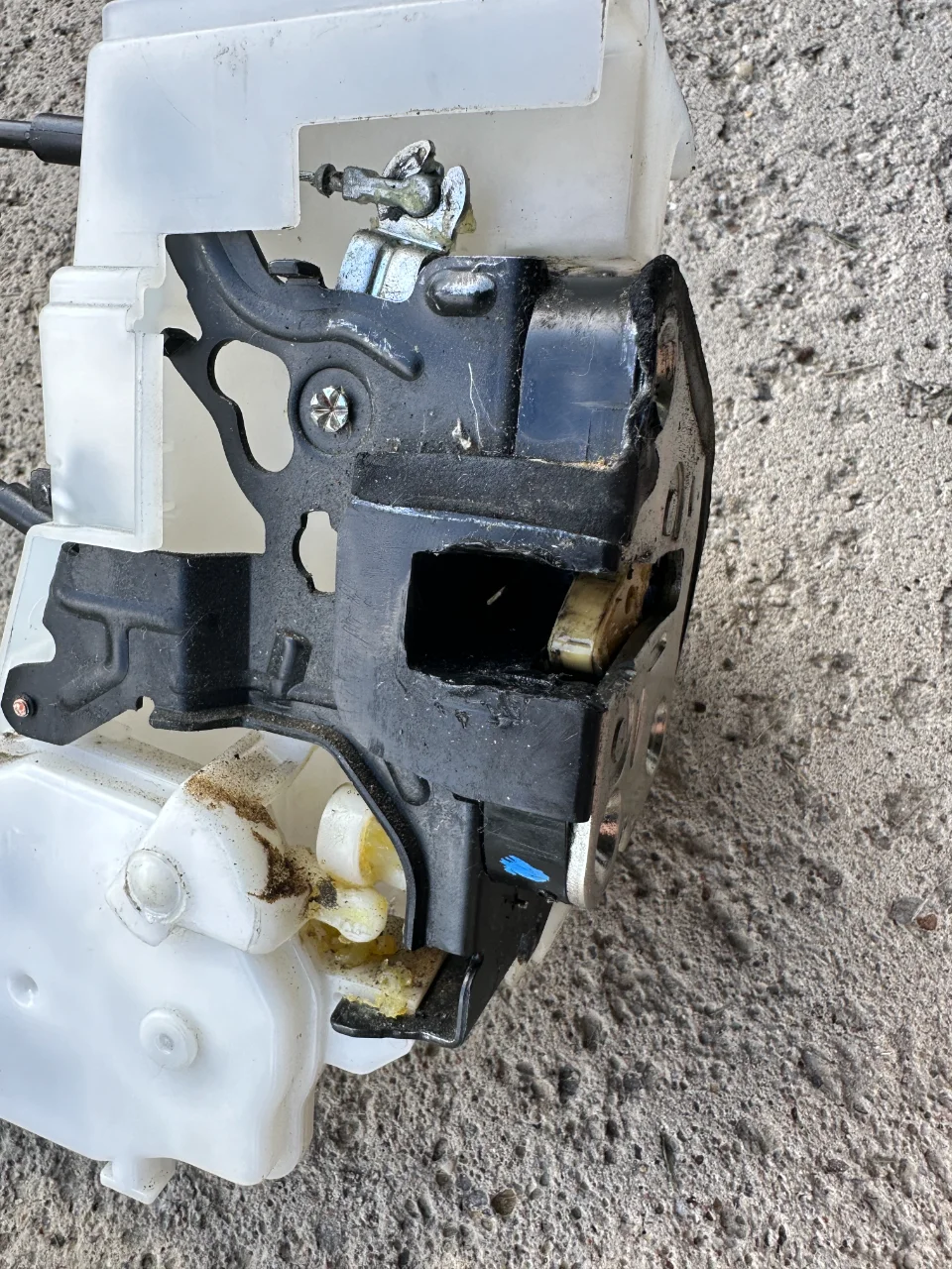

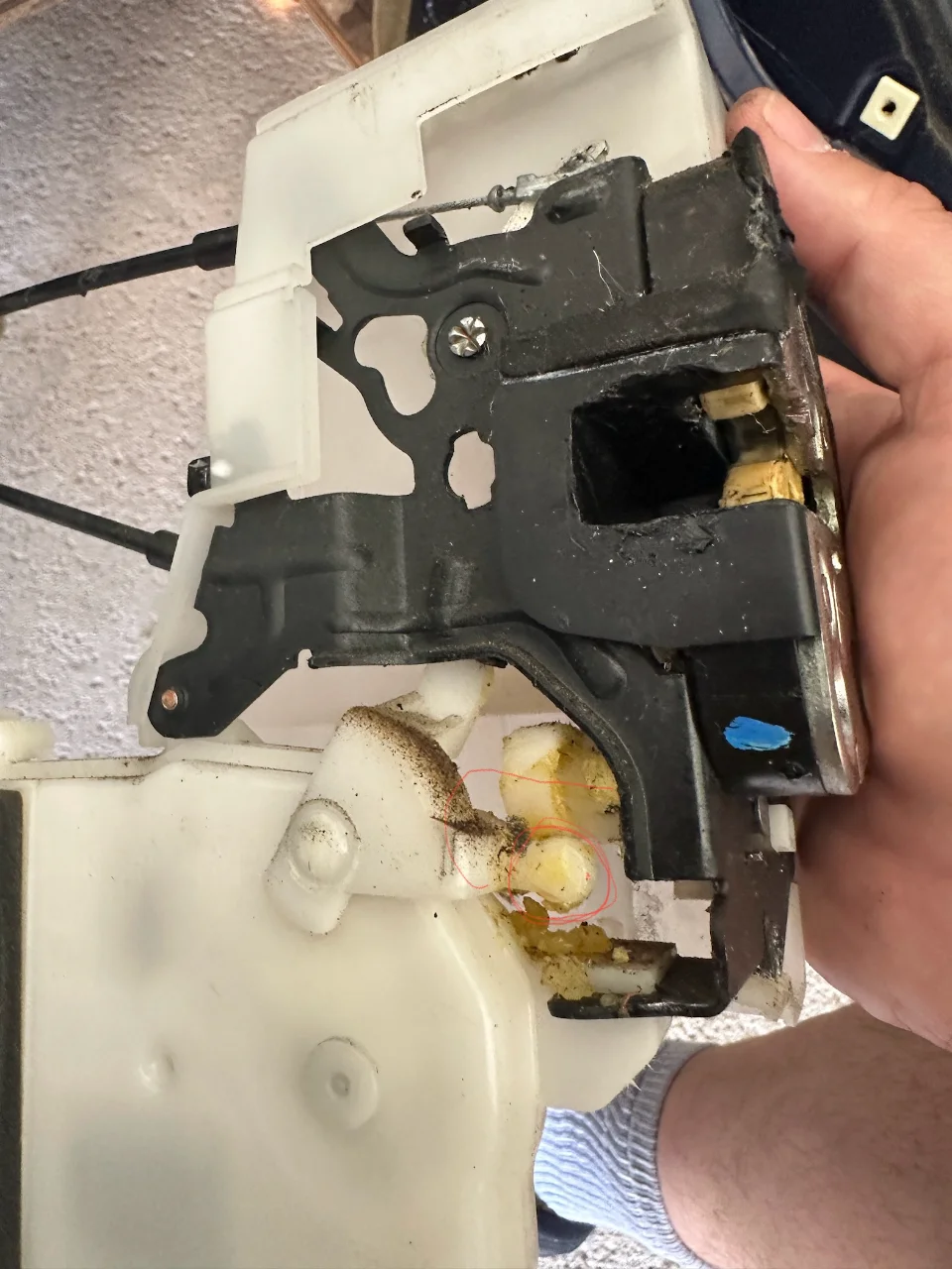

In the third image below you can see what went wrong. This is the lock mechanism - somehow that plastic arm/peg came out of the hole its supposed to be in. I took some pictures of the inside of the lock actuator with the plastic housing removing in case its helpful for anyone else.
This is why my lock failed: that plastic peg is supposed to be inside that hole. The plastic peg is connected to the cable for opening/closing the lock.
