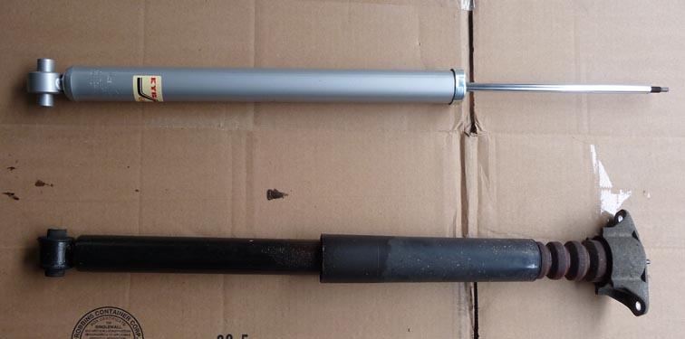

I had a blown rear shock so I went ahead and replaced it myself. Someone else posted about doing this and said it was really easy. As far as difficulty goes, it's on the level of brake pad replacement. It depends on whether you have the right tools or not. The replacement shocks I got were KYB GR-2's (Part No. 343412). You can find them online for $35 to $50 per shock.
DISCLAIMER: I am not responsible if you break something or hurt yourself while performing this procedure.
Stock shock and KYB GR-2 (silver)

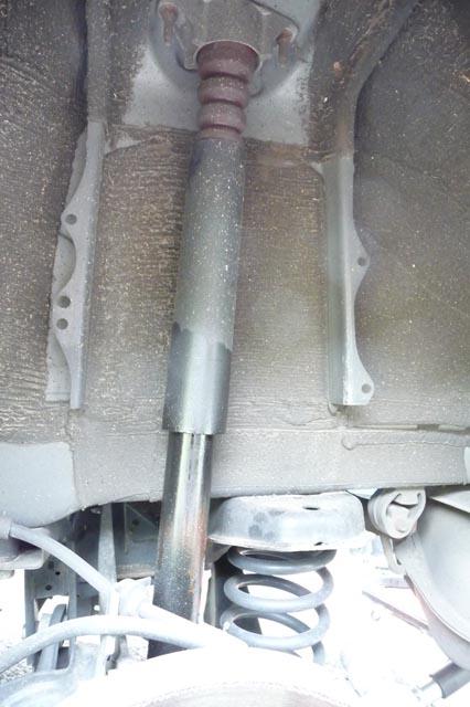

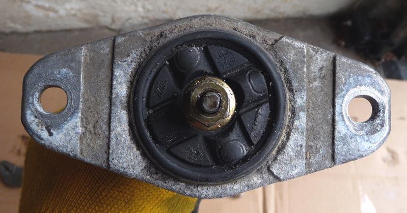

Now you can see that the shock is held up top by 2 nuts (12mm) and a 17mm bolt at the bottom. Unscrew the two 12mm nuts up top with a 12mm deep socket. It's really hard to get a wrench in there because of the shape of the bracket. Your job will be a lot easier if you also have an extension so you don't have to reach all the way in there. As you start to loosen the nuts, there will be a lot of crap falling down. Make sure you protect your eyes and try not to breath in the stuff.
Notice all the shock oil that has leaked out from the blown shock.

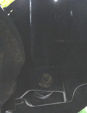

Uncrew the 17mm bolt at the bottom. A long socket wrench or a cheater bar will help out a lot here. I used a mallet to loosen the bolt.
This is a bad picture, but you can see the bolt. It's behind the disc brake. With the wheel off, you can reach the bolt without getting under the car.

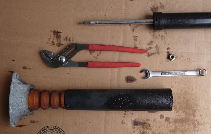

Uncrew the 13mm screw holding the dust cover/bump stop to the shock body. This step is really easy if you have a vice. To uncrew the nut, you have to hold the rod that the nut is screwed onto stationary. Otherwise, if you try to uncrew the nut, the rod and the shock body will spin with the nut. The tip of the rod has two flat faces, so if you put the whole thing in a vice, you can easily uncrew the nut.
If you don't have a vice like me, you'll have use something like pipe pliers to hold on to the rod and unscrew the nut... big PITA. This is the shock with the dust cover/bump stop off.
