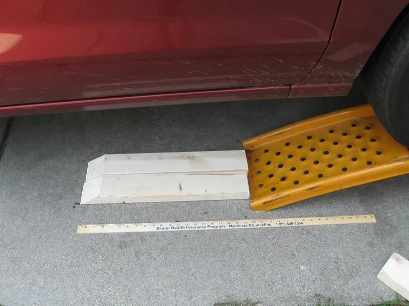

Anyway, the picture with the tire on the ramp - my ramps are a little too high for the Mazda5, the ramps were hitting the bumper before the tire could ride up on them. So I cut the 2x4's as shown, the Mazda5 now rides onto that first, then onto the ramp without the bumper hitting the ramp.

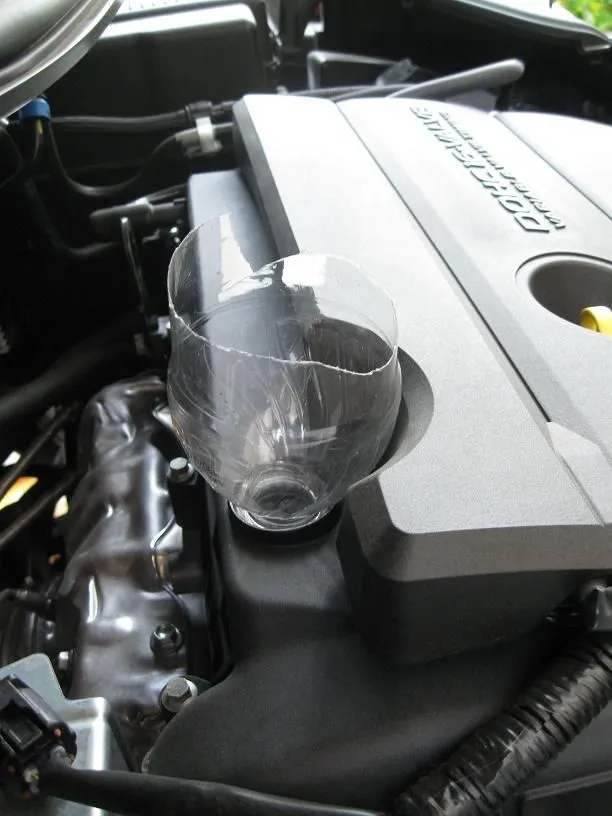

The picture with the funnel - that's a cut off plastic soda bottle, rinsed and dried. Works great as a disposable funnel.

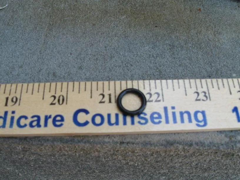

The picture of the gasket on the ruler (in inches) - what is that gasket for? This gasket, and the large one for the filter, came with the filter. Is this gasket for the screw that needs the 6mm allen wrench when removing the filter housing?

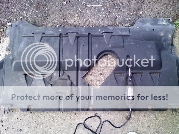

When I did my 40K oil change few months ago, one of the plastic piece that holds one of the screws broke off. So I decided to extend the hole in the cover so that I don't have to remove the cover the next time I change the oil. So when I did my 45K Oil change a few days ago, I removed the cover for the last time (hopefully). Got my dremel and just extended the hole.

Bought my 07 used about 5 months ago and have performed 2 DIY oil changes so far. Previous owner cut a 5" circle through the undercover so I don't have to deal with removing the undercover. First car I've ever owned with an oil filter cartridge. My observations:
