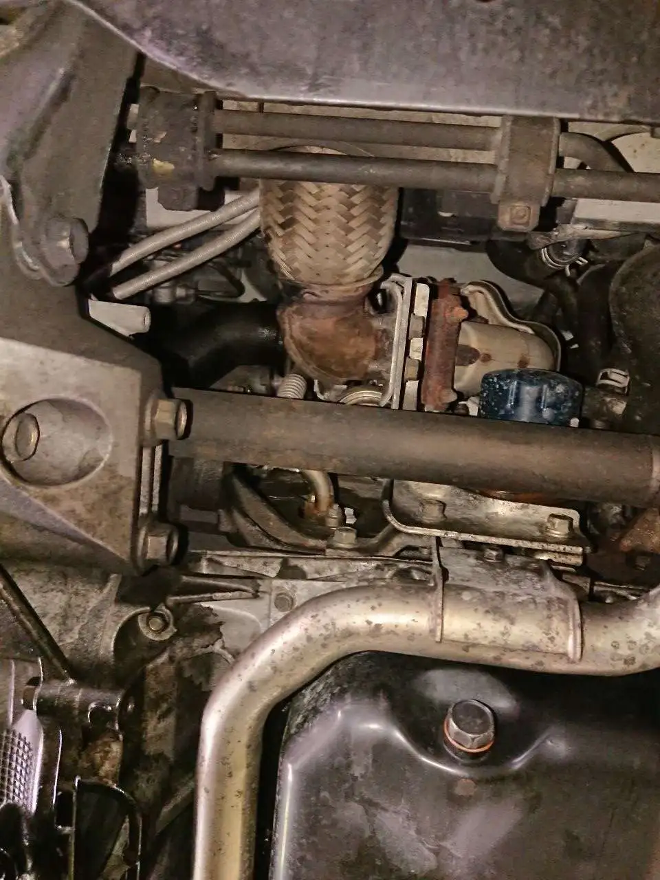

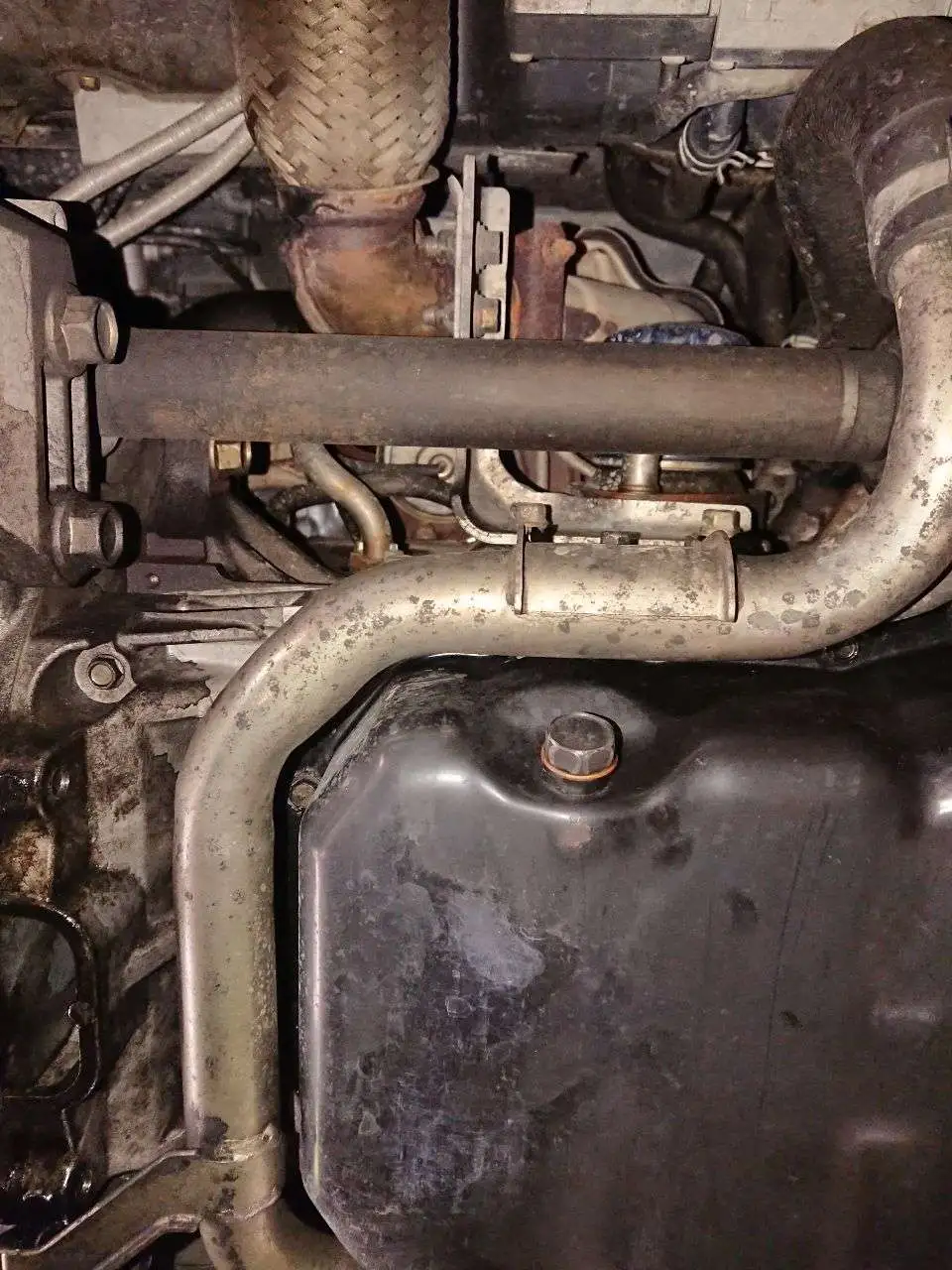

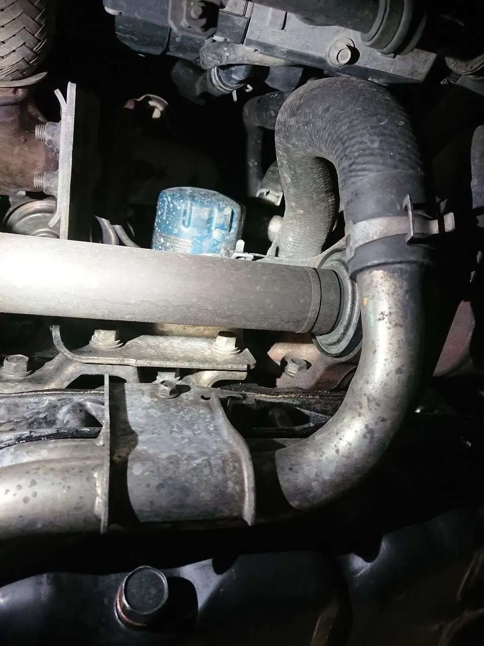

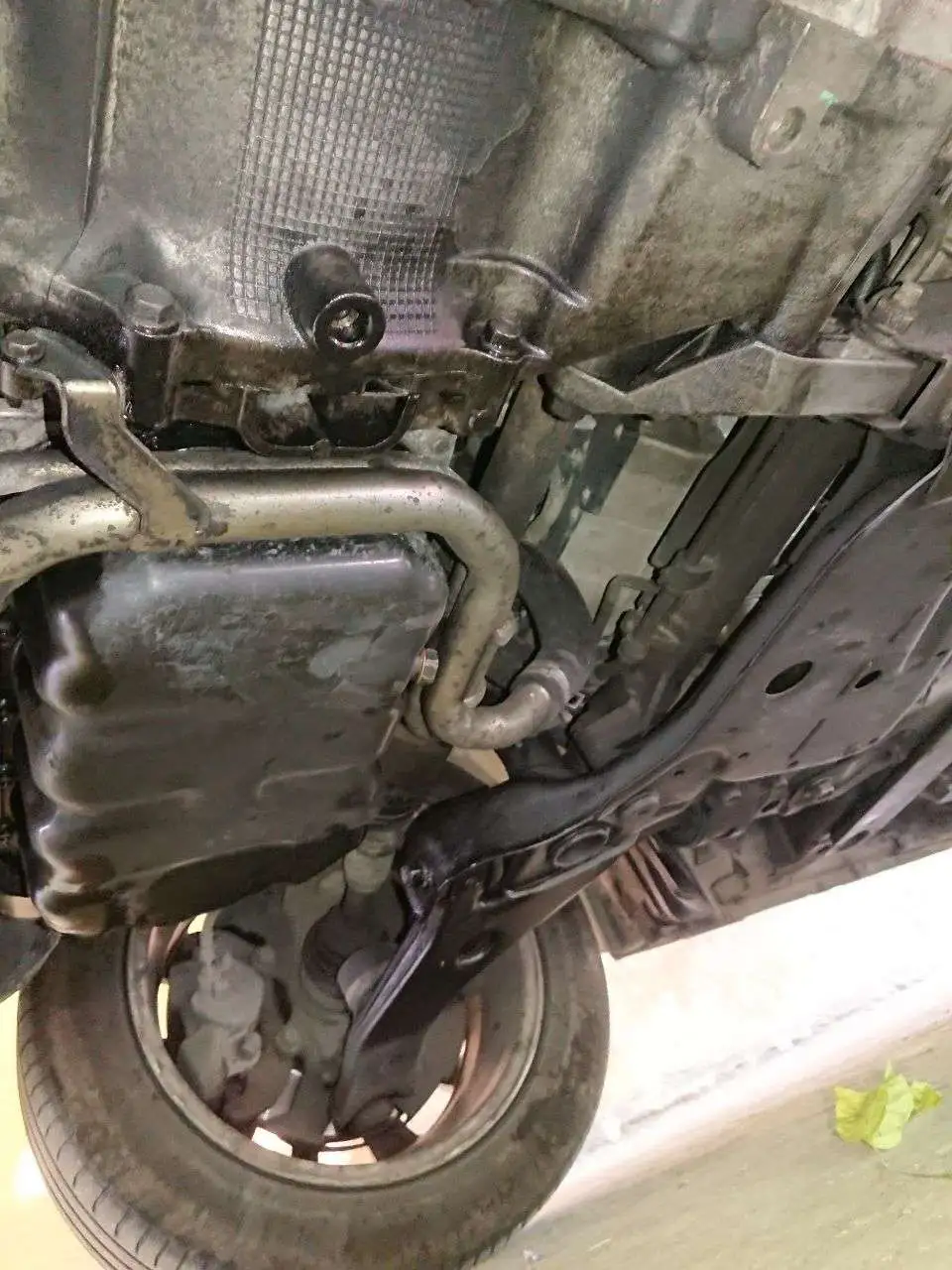

This is a very old thread and I'm probably asking a very stupid question, but I've never changed oil on any car before. How do I change the filter on the diesel model without spilling oil everywhere?
I couldn't find any video or guide about this particular model (2006 diesel engine).
The problem is that the filter is quite inaccessible, behind the engine, and I fear that when I take it out it will start dripping oil everywhere... The filter doesn't have a drain plug either. Maybe these filters don't need it? Maybe it doesn't leak when removed?

i don't have the diesel engine but it seems a similar location- it is as you fear and will make a mess. wear gloves, as soon as it is unthreaded, put it upright so more doesn't come out, of course. and i will cover the stuff below it with foil that i can just throw away afterwards. and wipe the rest of the mess.
good luck on your first attempt!
quick oil places are a good deal these days, but i like to use oil changes as an excuse to perform a check of everything underneath.
