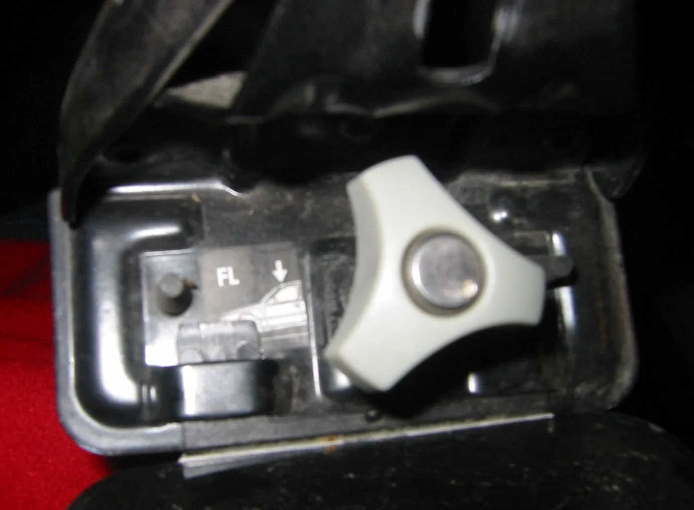

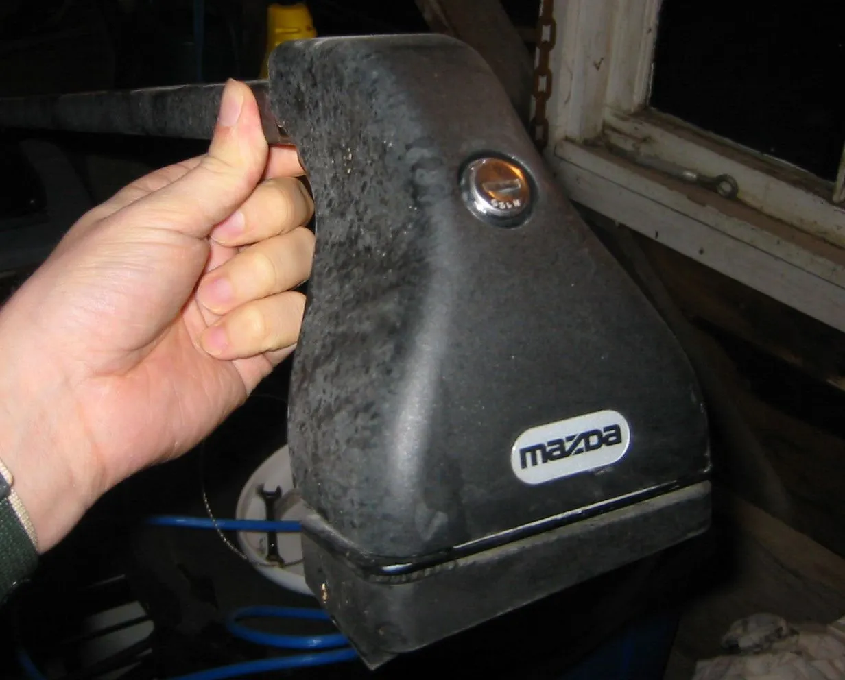

For those that wanted to see the CDN roof rack. There 4 plastic covers on roof. Just pop those off and these just bolt right on. On and off in about 5 minutes.

here is my p5 with the yakima rack on the qtowers. fits ok, but the antena is in a bad spot and I need to push the box forward about a 1/2 inch to clear the spoiler.

Now, ... if possible, could you take a picture of the "nut" end of the roof rack? i.e. remove the 4 small pieces, and take a picture of what's underneath them?
The american version (obviously) doesn't have ANYTHING under the four holes, and I wanted to see what all else I'm going to need.
The second picture is a different car, sorry about the confussion, that and american p5. you can see the factory rails under the box.
