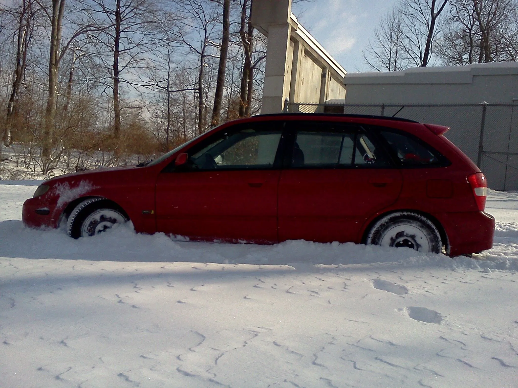

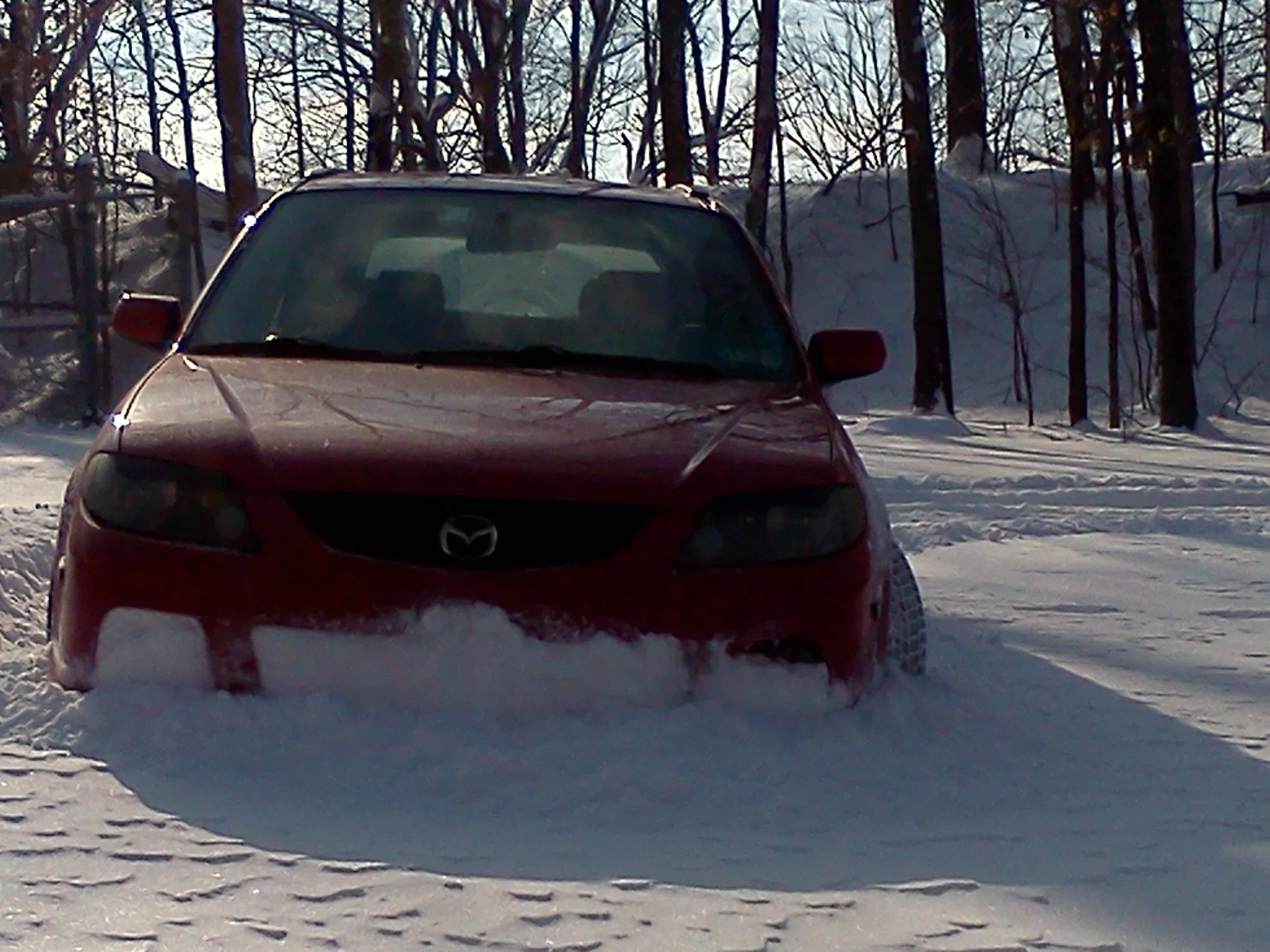

Here's some fun I had with my former Blizzaks a couple of years ago (185/70/14s). :D
attachment.php
attachment.php

NP and should be able to find a nice winter tire in that size or even run a 185/60/15 like stivine6 is. For winter, the narrower the tire the better for slicing through the snow. My stock size is 195/50/16 but I've been running a 185/70/14 in the winter. Cheaper to buy replacements and they are nice and meaty.
I'm running cheap "Winter Claw Extreme Grip" tires made by cooper and the only time i got stuck was when we had 25-30 cm of snow a bit north of toronto much like CTt3P5, plus my car is lowered with a front lip which acted as a plow that day. I found it better than any all season tires, any cheap winter tires will perform better than the best all season tires in my opinion.
To clarify, in my pics I was not stuck. Simply having some fun in a gravel lot next to my office building. I'm lowered too on Tokico Blues and Tein S-Techs and have done my share of plowing on un-touched roads. :D
