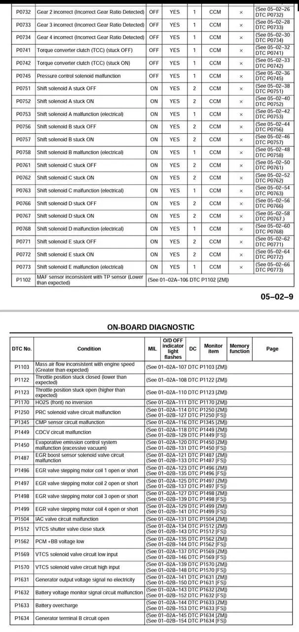

Blinking O/D light ONLY when I shift to drive. It hard shifts and doesn't go past 15 mph. I have to turn car off and on, shift to drive, and wait for few seconds to make sure O/D doesn't blink up. I have to do this several times on cold starts. After that then it drives great. Upon research in forums. I was told to replace Input Speed Sensor. I have done this and it has worked for about 3 months. Issue is now back on and off.
Has anyone had this issue. I was thinking to buy another Input Speed Sensor to see if this issue goes away.

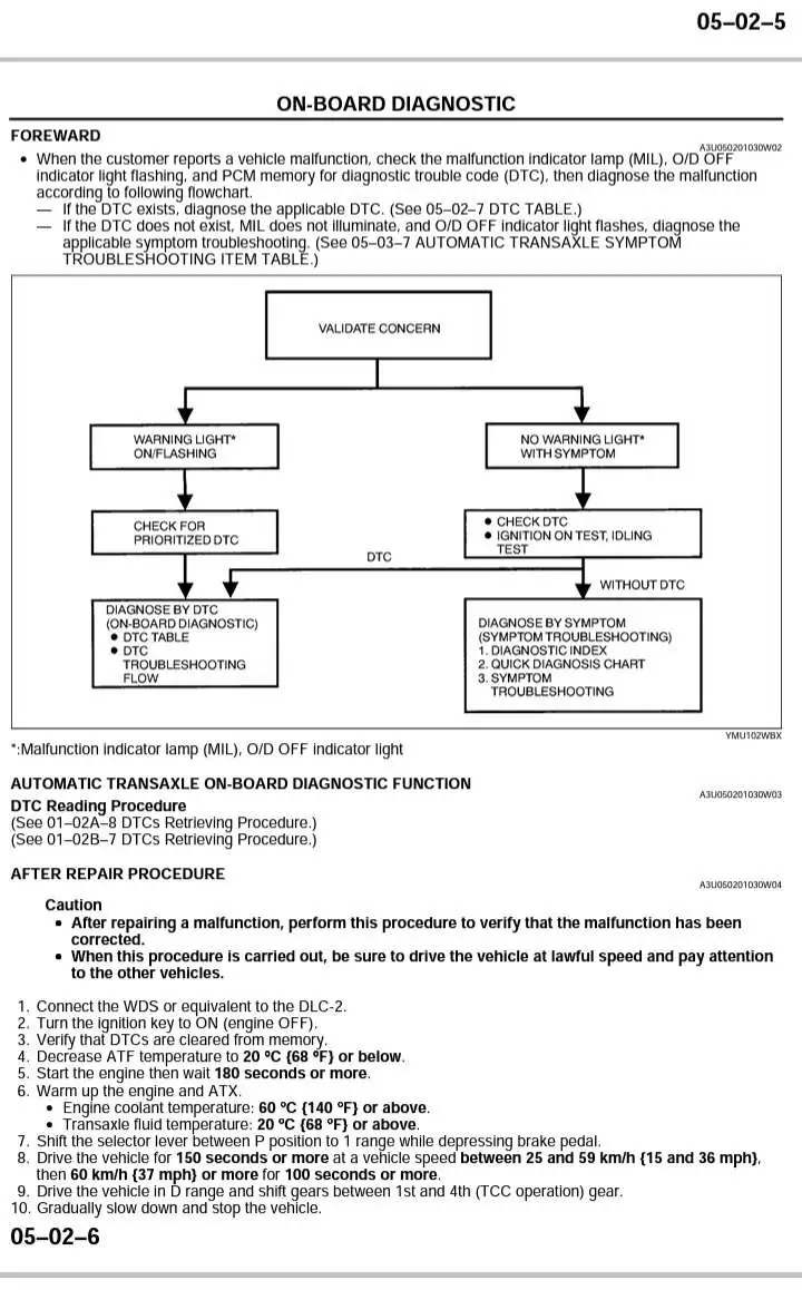

Check your codes.
It will tell what's wrong.

Here's a link to the service manual,..
You might just need an ATF oil change,..
