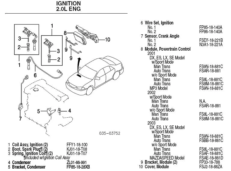

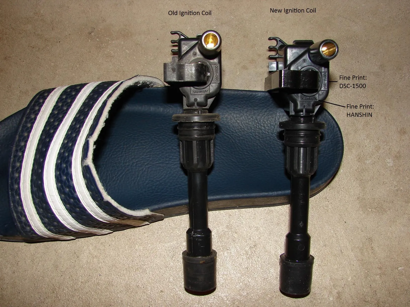

I am newbie in fixing my own car but after reading a few forums and looking at the service manual and 2001 Mazda Protege car parts catalog, I decide to do my own tune-up maintenance. I got the P0300 code several times over the past 3 weeks and the exact same symptom is hesitation while driving on freeway. While driving at 65-70 mph, the car would suddenly lost power for a few seconds (disengage) and then reengage again and a CEL will come on.
I had replaced the EGR valve 10 months ago when I had experienced it for the first time. It seems to creep back on me this past weeks after it go over 103k miles. It seems like most people would have the ignition coils, spark plug wires set and spark plugs changed. I just did a change of the ignition coils just to see if there is any improvement to isolate the culprit one by one.
I got the BWD Ignition Coils Part # E427 for $26 each and a 10 mm socket (for bolts removal). You can get the BWD coils from O'Reilly or Advance Auto Parts. It seems to me BWD is the OEM parts for the car (please correct me if I am wrong here) since the design is the exact same and there is an identical fineprint code. See attached photos for details. Hope someone would find use for them.

Did this fix the issue for you?
Yes, it does fix my problem. No more CEL on the dash and I pass the State Emission test after a week of driving the car with the new coils. I also replaced the spark plugs and spark plug wires thereafter. I noticed just after replacing the coils and the spark plugs + spark plug wires, the car rpm will be very low when idling at stops and struggle to stay alive. But after one day, it does not do that anymore and seems to idle smoothly at stops. So if you also experience the same thing after replacing them, don't panicked, maybe it just needs sometime to adapt.
