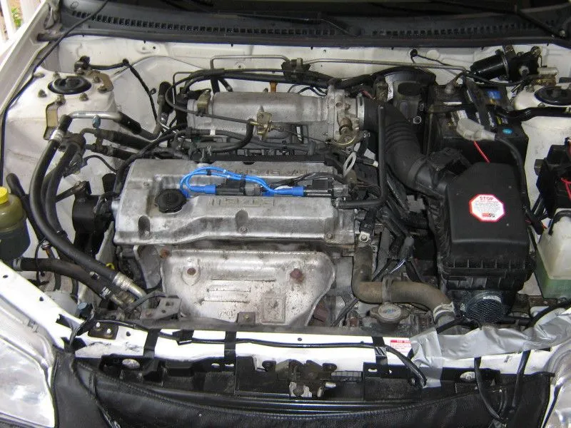

Did anyone do this to a 1.6? If so, post some pictures of it because this is hard reading about it and then going to look in my engine and then completely forgetting what I just read, haha.

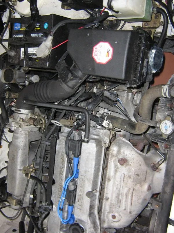

as i said b4, i took everything that was in front of the air filter box (2 big pieces of plastic),and i drop a K&N filter in the box.
yep, works just as well as a sri
