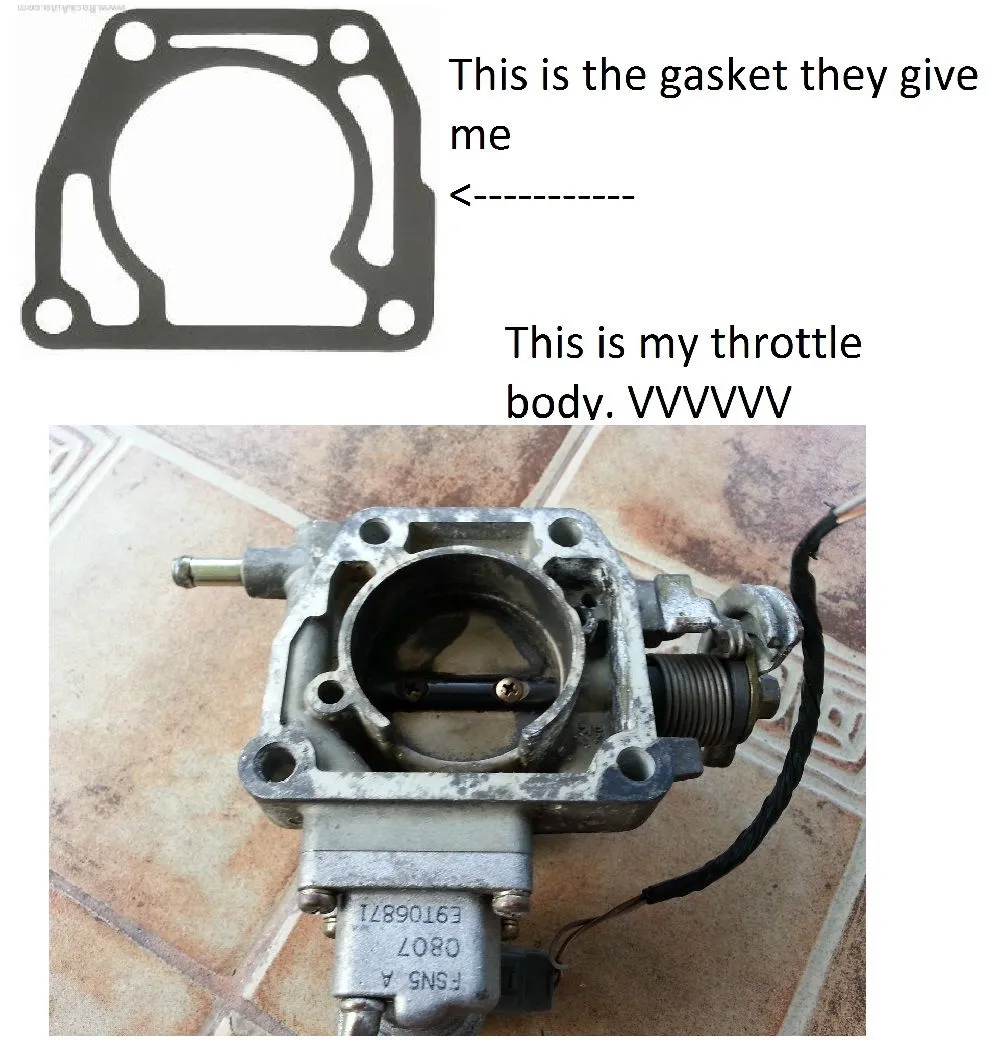

I have another concern. I'm looking around for a throttle body gasket, but cannot find mine.
Here's a picture that shows the gasket they provide me and my throttle body...you can see how it's different. My car was manufactured in Japan. Does that make the throttle body different?

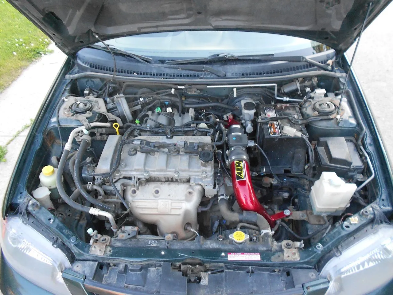

Can you post a picture of your engine bay? Sounds like you may have the fsze which will be a bit different diagnosing due to the differences. If I'm right you will have a black plastic piece on your intake manifold and may possibly have a 4-2-1 header. The major differences are the cams high compression pistons and the intake manifold which may be why your gasket is wrong and it will be obd1 iirc
Here is the picture of my engine bay. I noticed on the right side of the engine block that there is "FS9". I did some research and most people relate the FS9 to the FS-DE engine, with 130hp and 135 lb-ft of torque.
