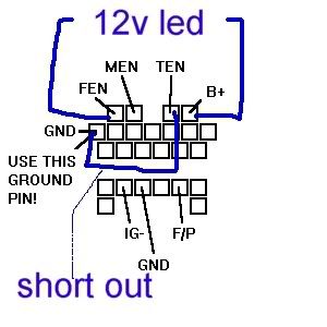

Lastly you can check your own CEL with a paper clip on the Mazda mx-6's,
For more information on how to read the codes and what they mean check here.
http://homepage.ntlworld.com/mx6-uk/malf/malfcode.htm

it's an obd-II bro, i do believe it's a different connector from us obd-I folks. u are right with the disty--they're notorious for going bad on us... also check for the HEI mod, which i heard isn't too difficult
on that connector, all u have to do is ground the ten pin and turn on the key and count the flashes of the check engine light and it will give u the code or codes
I know this works on the 92 model and up to the 95 we just aren't sure if the OBD 2 will do it. does anyone know for sure?
afaik, obd-2 cars have the connector inside the car, under the steering wheel/knee pad... i believe it's the connector the smog testers use
