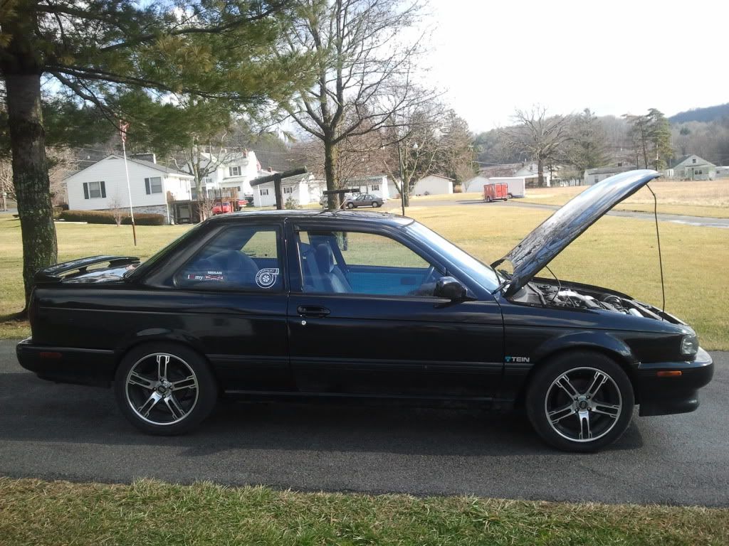

here is my New to me Nissan NX2000.
I have to say I enjoy driving this car alot more than the Sentra.
I miss my ve though.

Nice find, that seems like both a fun and badass car. Those are not sleepers though as there known to be quite capable with the right modifications, which yours seems to have. Hope you find a new trans and continue to enjoy it!
Sr20 is a bad ass motor. But nobody would expect that in an older sentra the only bad thing is its fwd and transmissions aren't very strong
Boostr - Thanks man! I have located a transmission I hope to buy it on the 1st of march.
StealthWyvern - It is a blast to drive, puts a big ass smile on my face. I agree with you about the FMIC killing the sleeper status. I live in such a small town the people probably don't know what the FMIC even is. So its a sleeper for WV lol but if I went out of town it wouldn't be.

Your SE-R looks good man. maybe some better tires and new rims hahaha..... I used to have an 02 SE-R 5spd, man i miss that car. Had rear Gutted/bolt-ons with a tune and it pulled hung right with S2K's and 350s
Thanks man. I love the car. I agree with the rims lol. looking at getting some gold rotas
