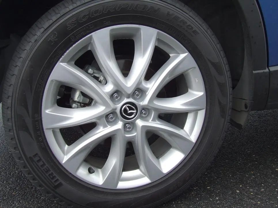

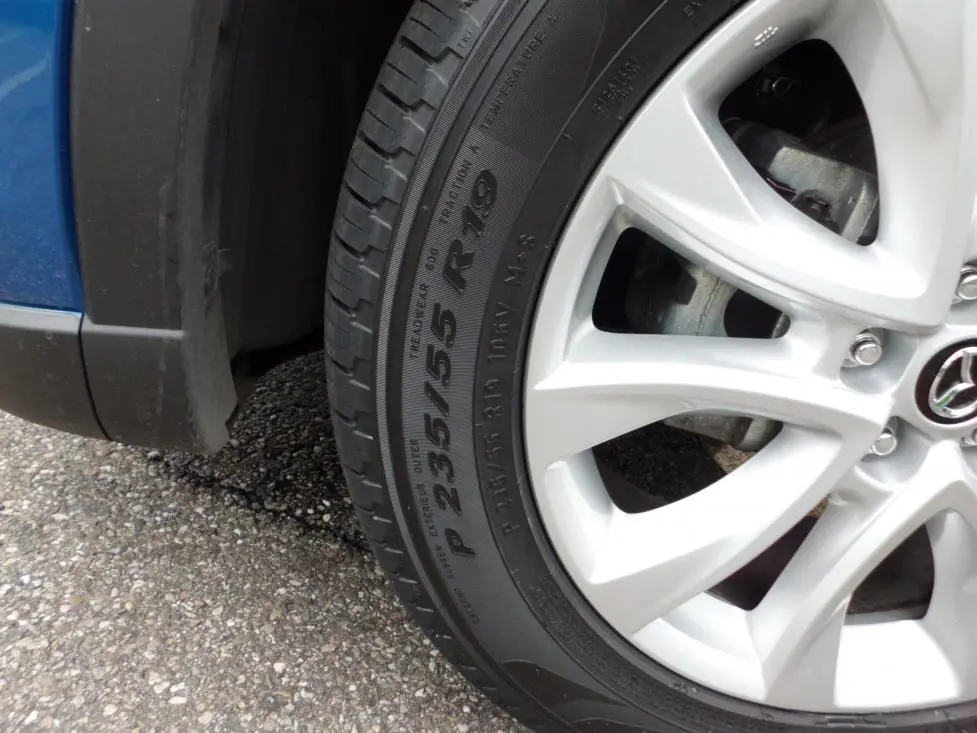

these pictures are from Mazda Hockenheim Experience tour , so you're pretty safe with 235/55/R19 :) (mounted on original wheels)
Cheers,
Miki
instead of 100km/h tacho should read abut 97km/h... not a big deal. I think it's a fair trade off for high quality and easy to obtain tires, though I would still prefer if Mazda kept CX-7 wheel size (19x8J) on CX-5 (19x7J). 19" wheels with 7 inches width are almost non-existent.
