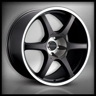

Tenzo DC-6 Version 2
main.php
Sup Everyone,
Is anyone out there running these Wheels?
With what offset, any drop and any problems???
I'll appreciate all the info I can get..
Pictures will be nice!!
Peace!

You should be okay with the 18x8 45 offset. If you drop it too much, you might need to roll the fenders.
