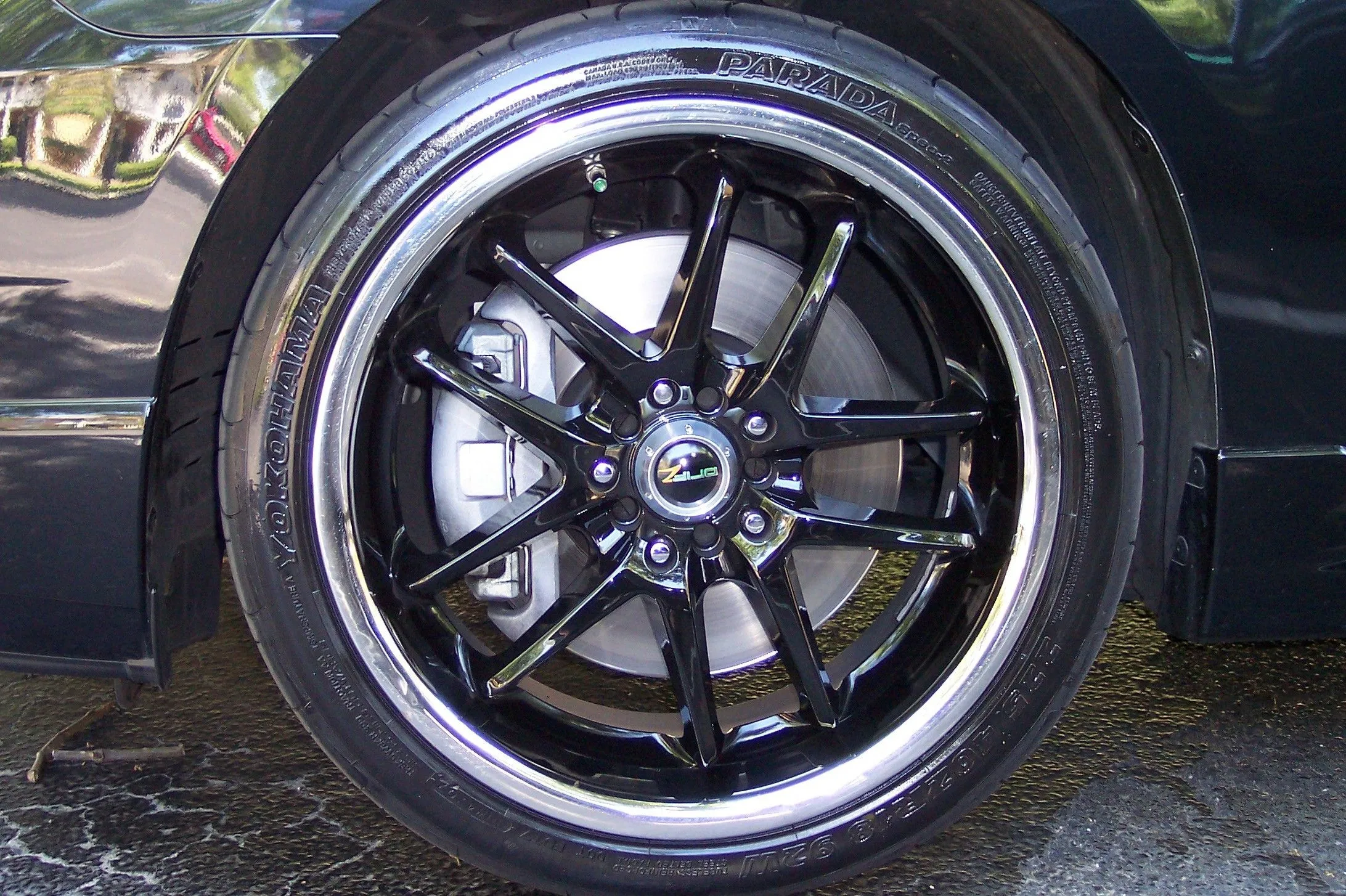

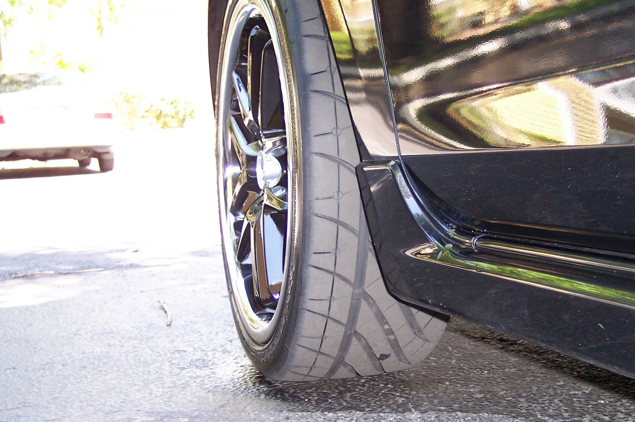

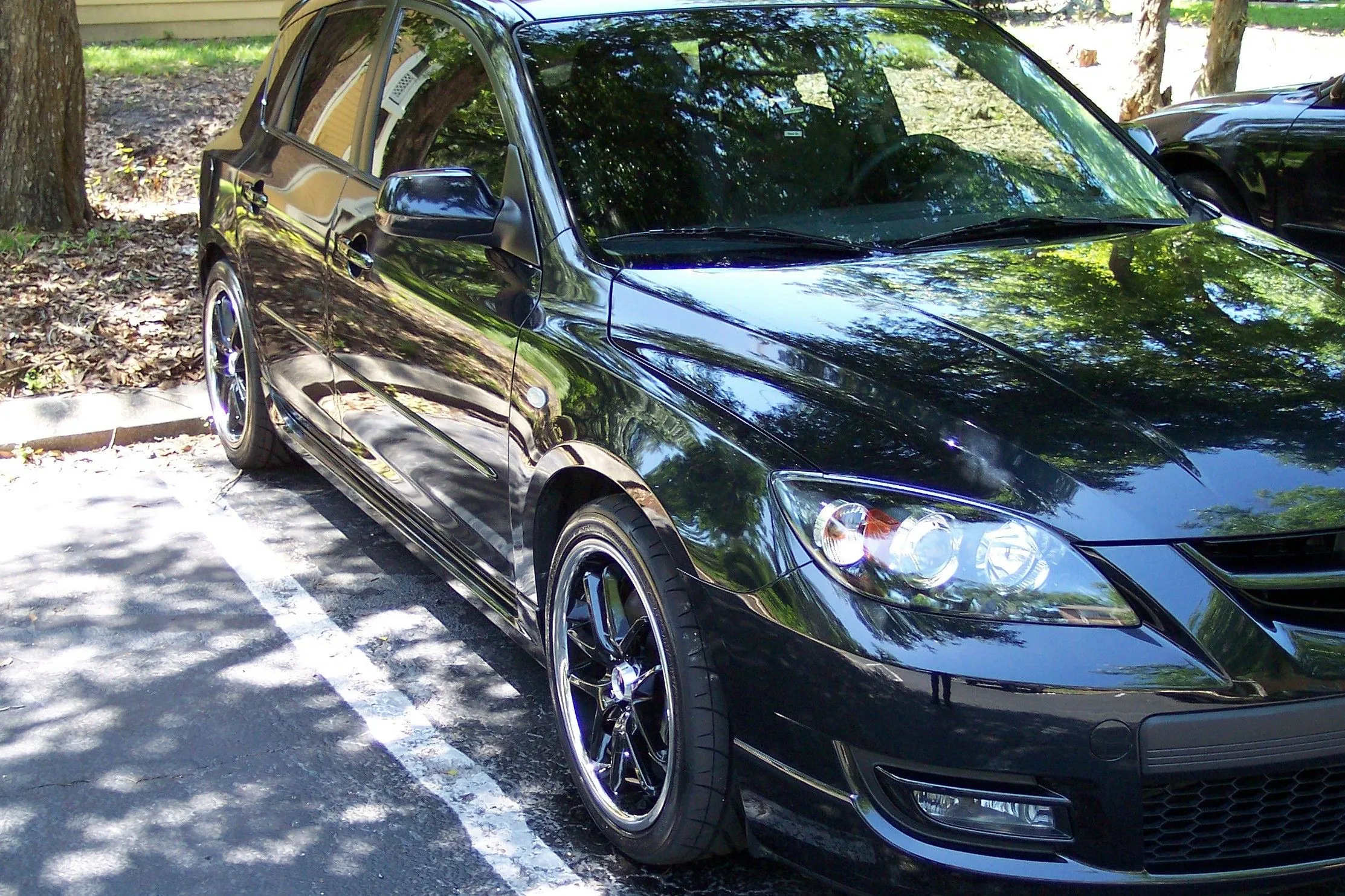

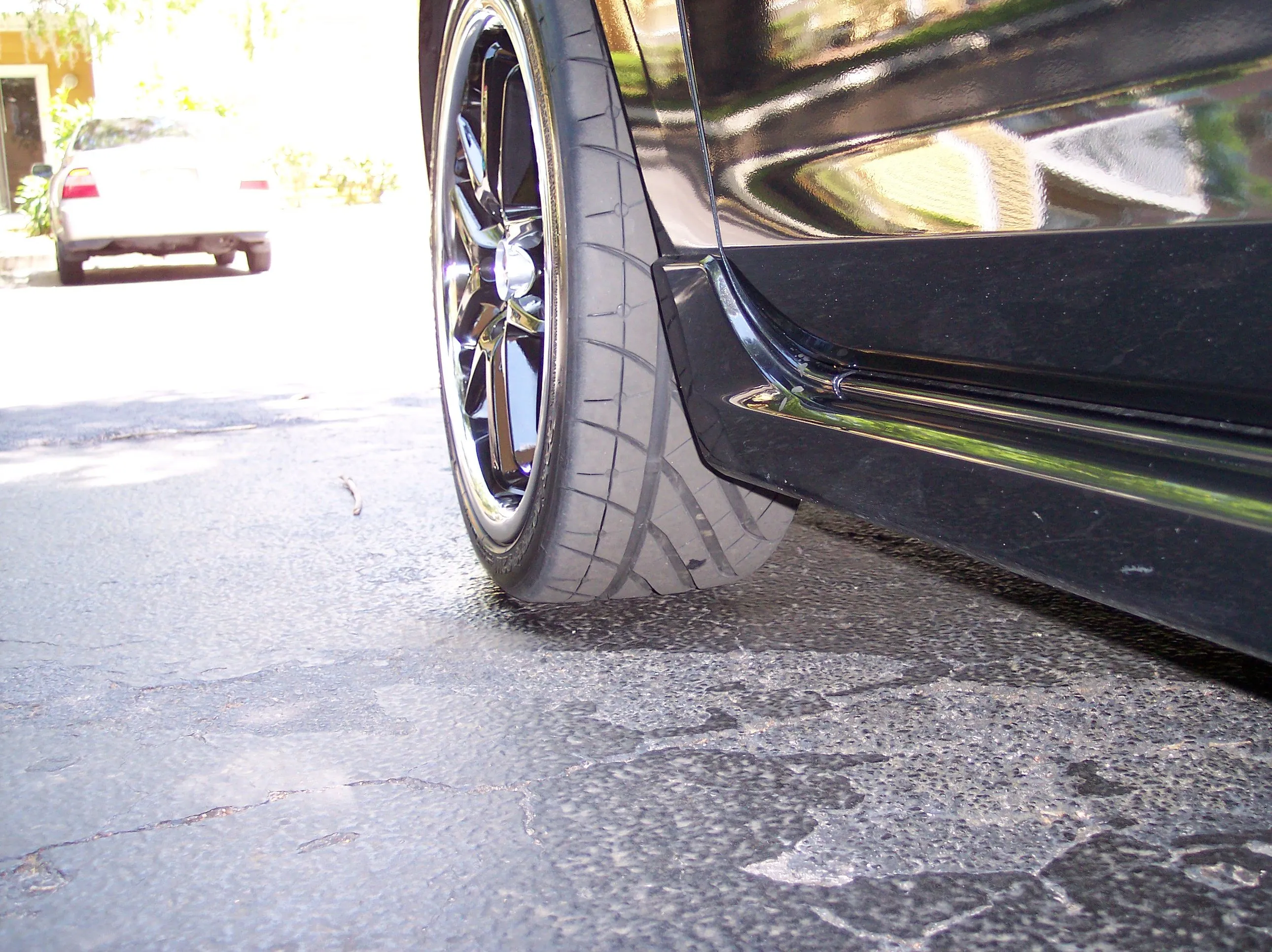

Thanks! Here's a couple pics of mine
If I did the math right, an 18x8 48 offset would have the wheel .35mm closer to the wheelwell than an 18x7.5 42offset. In other words, so close that you would have to have freakishly perfect vision to tell the difference by looking at them. Both of them sit less than half an inch closer to the wheelwell than the stock rim.
