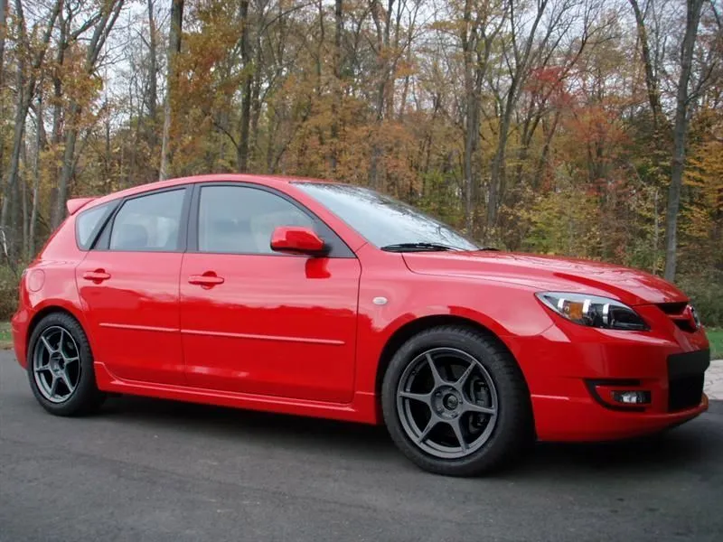

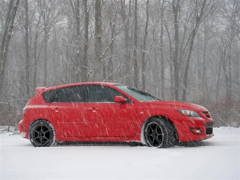

I also photochopped my wheels so they appear to be black-chrome, I might get them powdercoated. Here's a photo, whadda ya think?

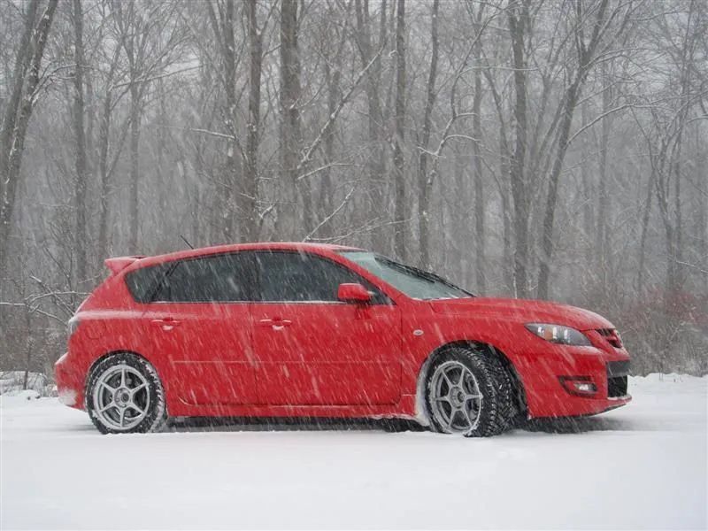

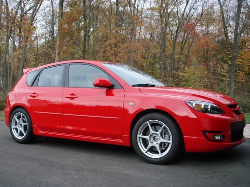

Thanks! I'm not sure which Kosei's they are, they are older and apparently a lot of people ask me that... I got them locally with the winter tires on them for a good deal and I love how they look. This is the actual color:
update, just did a search and yeah they are either called the K1 or the K1R or the "K1 Race". When I search K1 race I see a ton of these coming up on yahoo images.

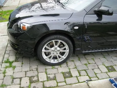

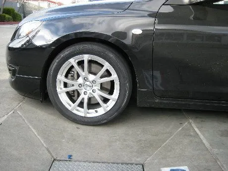

17x8 50 offset.....245/45/17
