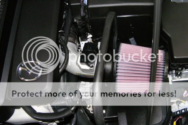

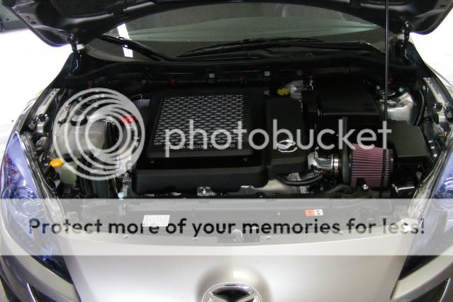

Hey Everyone,
All I have added to my '11 Speed3 is the K&M Typhoon Intake. I really do not wish to add anything else, BUT, I'm thinking about doing a flash or something. I do not really think I will race the car. I just want it to be tuned correctly to add a little more power.
Any thoughts?
