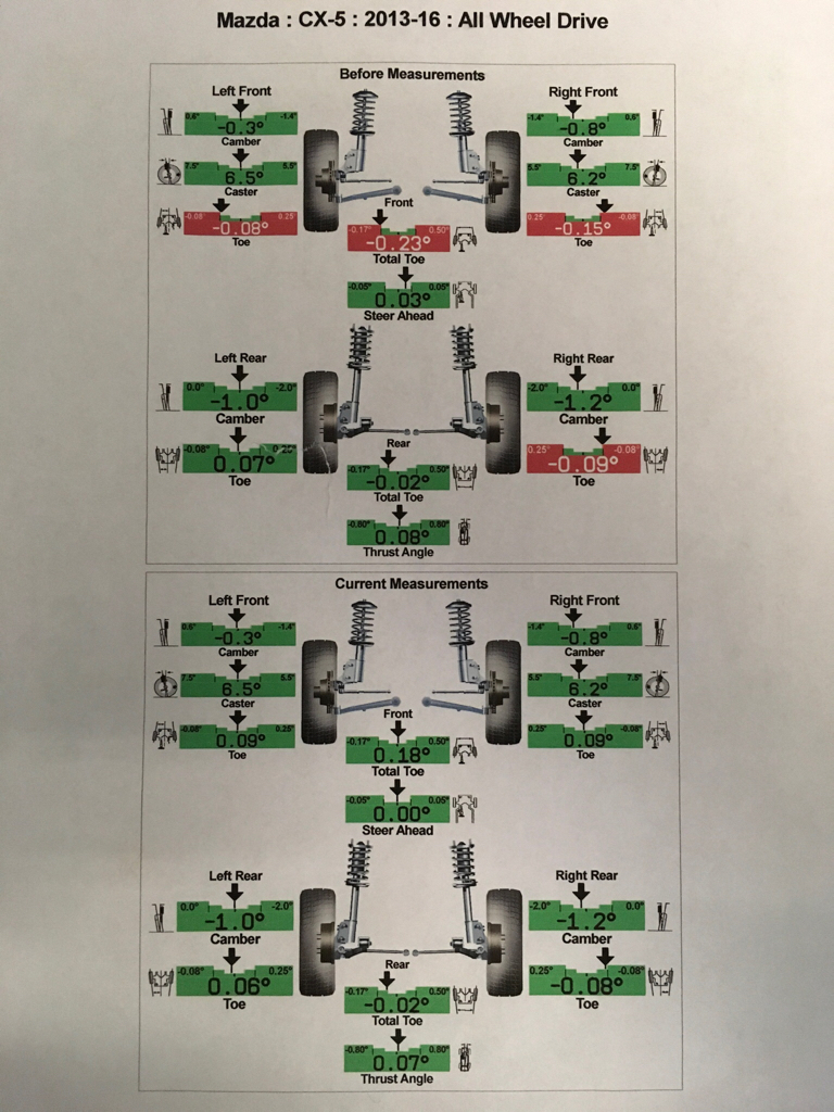

Attached is the alignment printout. I just found it on the seat lol.
meh, that thrust angle sucks. Even though it's in the green I prefer thrust angle to be as close to 0.00 as humanly possible. That front toe out I'm sure is definitely what caused the abnormal tire wear, although I would have expected both front tires to be worn like that. Odd that it was only one tire.

I think that is as close to 0 as humanly possible. The good range is between -0.8 and 0.8 and they have it at 0.07 which is pretty much 0.
