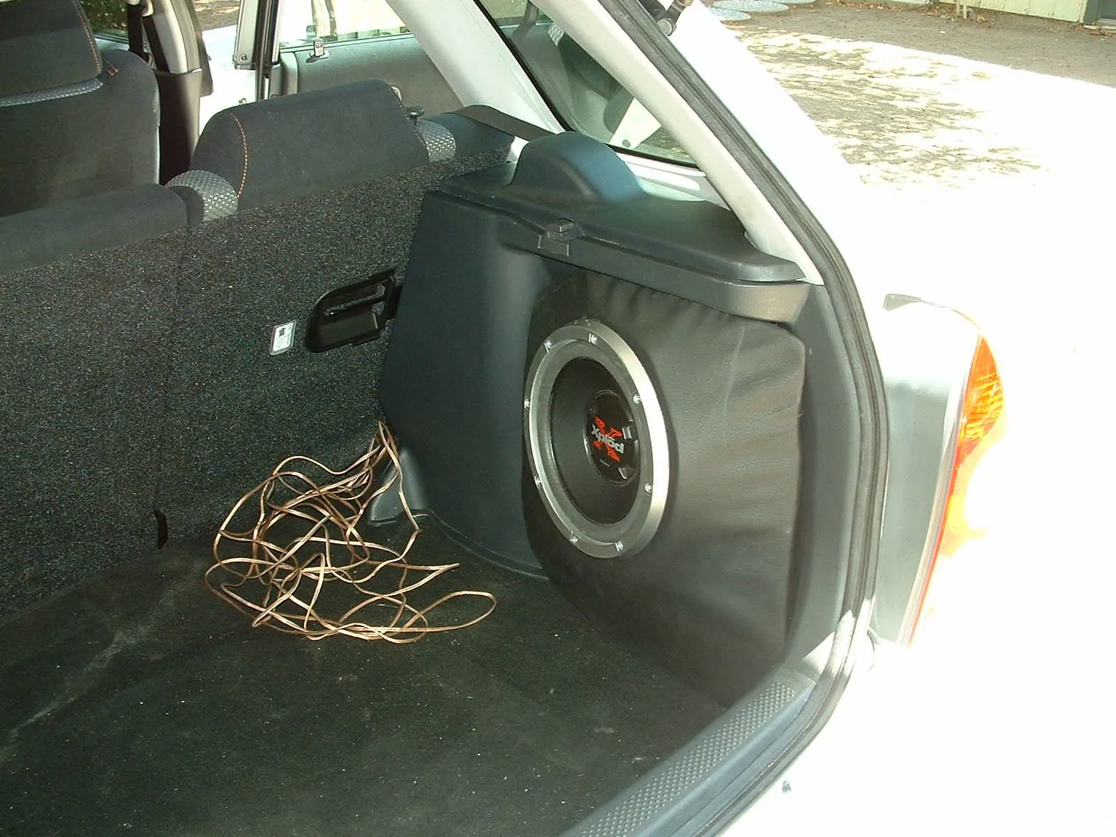

hog that pig out to 12" and gain a xtra 3/4 ...but you wont be able to use that grill ... check this pic out ... this version of the same box gets me lil over 7"
