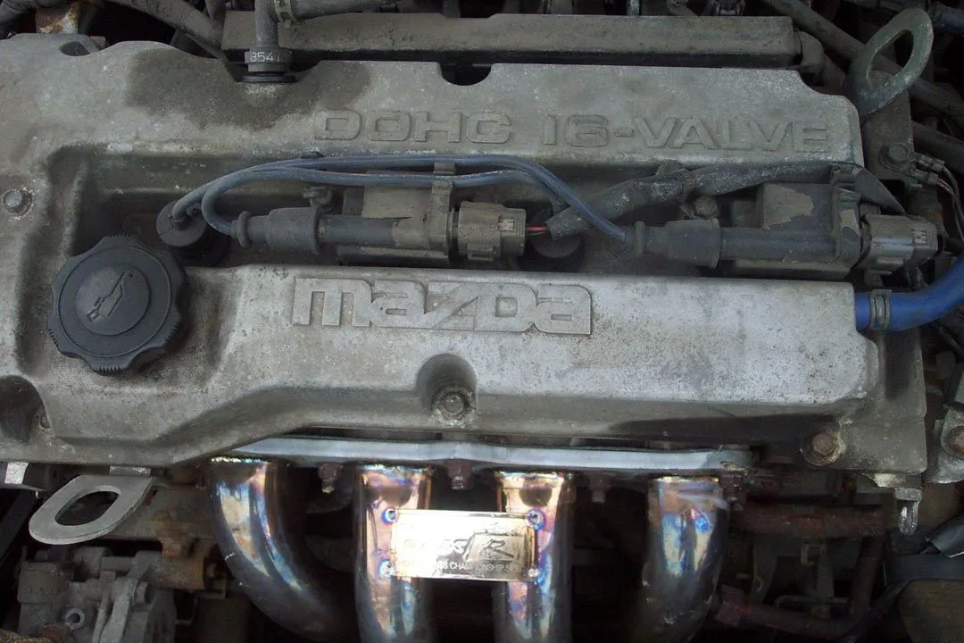

i bought the 1.6l 99-01 obx header from ebay (it is on OBX web site but it is doscontinued) so i got it and it looks great, the soldering are visible but look bad ass too . in canadian with shipping, currency change, custom taxes etc...it cost me about290 $ can .. i'll post picts of the work in progress when i'll install it yesssss!!

OK, the pic on the link is a 2.0L header. If that's what you got, it will not fit.
If you post a pic of the flange of the header you received I'll save you the possible trouble of taking your car apart.
Maybe you haven't seen other threads about this but the OBX 1.6L header does not exist, it never has, no one has ever seen or bought one and if you did indeed receive a 1.6L OBX header, then it's a miracle whose magnitude exceeds the virgin birth (or Marisa Tomei's Oscar win).

he obx headers for 1.6l engine, its hot
i didnt encountered major problem,
minor issue :
- the first 02 sensor cable is very short, i had to loosen up the connectors from the series of cable that r all tie-wrapped but few ti-rap relocations and it was good,
- for the second o2 sensor i did the cel eliminator with resistance and capacitor from radioshack, from the post about it on this site, my old exhaust manifold was so dusty that i didnt take any chance, i heated up the bolt with a "blow torch" then i prayed and remove all the old bolts, none broke in the head.! :)

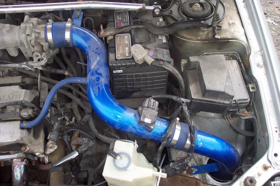

- i already had a cold air intake witch seems to give some hp in hih range but loose torque in lows. BUT with the header it semms i regain the lost torque, iand i still keep the HPs, i would like to dyno my car now but i dont know where to find a place in montreal, i have promise you some pict and you will get some i garantee it,
i recommend this header it cost me 195$us + 45 $ shipping (im in canada so that much) + another 45$ can for customs taxes... yes our government own us too!(those bastard).. so bottom line is i got this header for about 300$
on ebay, the user who sold it to me was dannywong. good seller.
let me tell you the sound is freakin awesome!
if some one get one of those, id like to hear your comments!
Peace!
Samuel

the picts of obx header on 1.6l
here they are:
I don't know how yu got that to work without leaking but that sure looks like a 2.0L flange to me from that angle.
thunder's construction is definitely better...thicker flange, all polished ss(including the flange), 2 piece design, better welds, etc.....
