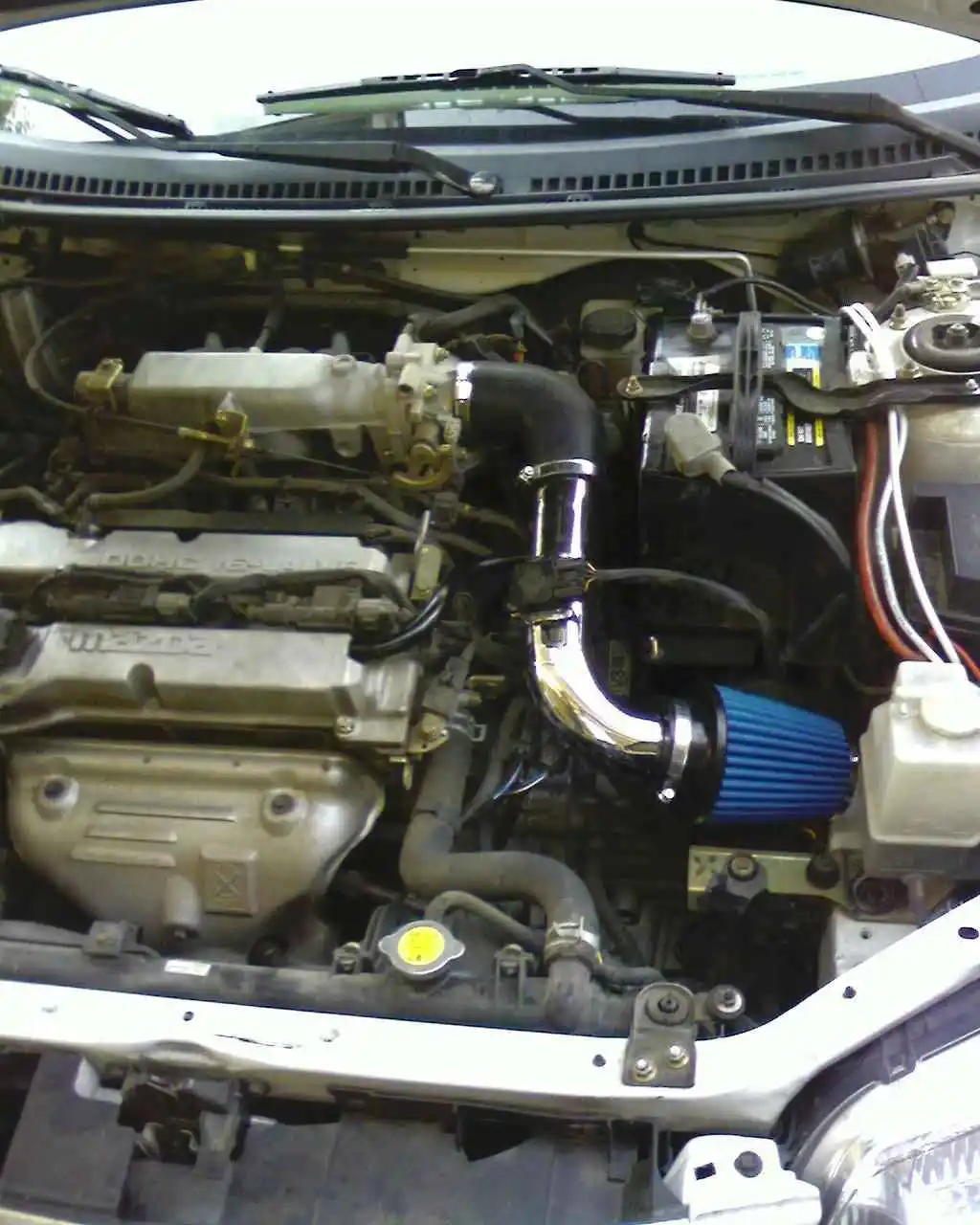

hey protephile, does the simota cause the hesitation issue?, if not, do you take paypal?, and can u post a pic of the intake please
Yes, I take Paypal. akawest@comcast.net.
No hesitation with this intake. Here is an installed pic
sent by a forum member:
that would be a negative squirrel. The Celica MAF is only needed with intakes that are 2.5" in diameter, the simota intake is 2.25" same as stock so the stock MAF works fine. However, the celica maf works in the stock intake fine too, so i would imagine it works in the simota intakes just not needed.
