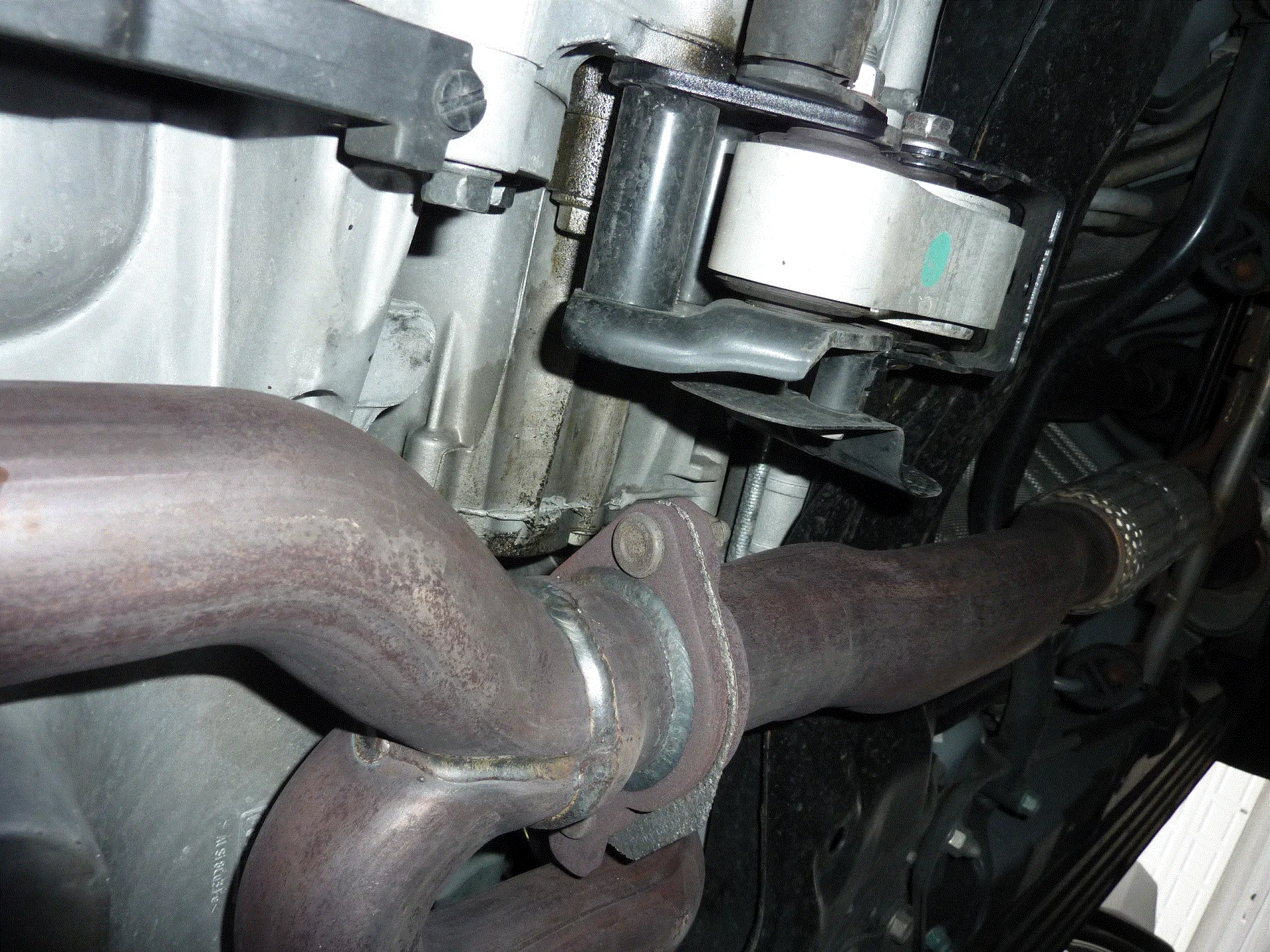

Noticed a wet spot at the bottom of the PTO during the last oil change. Did not see any drops on the garage floor and no other obvious leaks that i could see so I cleaned it up to see if I could find the source. Just changed the oil last week and saw that same wet spot at the bottom of the PTO(see attached picture). Took it to the dealer this morning and they confirmed that the seals are leaking. Unlike the CX7, they cannot replace the seals and have to order a new PTO. They ordered a new(or refurb - forgot to ask but i figure it would be refurb)and will replace it under powertrain warranty as soon as it comes in. Car only has 22K mi.

I just noticed something very similar last weekend when doing an oil change. Thanks for the info, I'll take mine in to the dealer, too, and see what they say. Car has 25k on it.

Noticed a good amount of what I thought looked like cv grease in the spot where the wife parks the cx9. Finally got some time today to have a look. I was hoping it was just a cv but I found this.
We had the TC changed out at 35K because of the well known TC issues. Has been fine since now with 85K. Pretty sick to my stomach to say the least. Anyway, I can't really tell where it is coming from exactly. Could this be a breather issue?
In case you were wondering this is a 2007 and I hope your 2011 doesn't look like this in 4 years. Has anyone seen this and fixed it yet? (pukey)

I think my leak was very small and definitely not enough to produce drops on the floor. It was almost like a sheen that just coated the bottom. From what I could tell, it was definitely not thick like grease but rather more like gear oil which I thought was in the rear differential and TC?

Called yesterday for an appointment today and just got car back from dealer. They replaced the transfer case under warranty. They also did a full circle inspection to check tires, brakes, battery and fluids all no charge. Wantagh Mazda on Long Island.

dropped it at 8 and was done at 4. They said it was about a 3 hour job so not sure about leaky seal or internal gearing issue. They just said they replaced the Transfer case. The pictures above show the extent of the leak.
