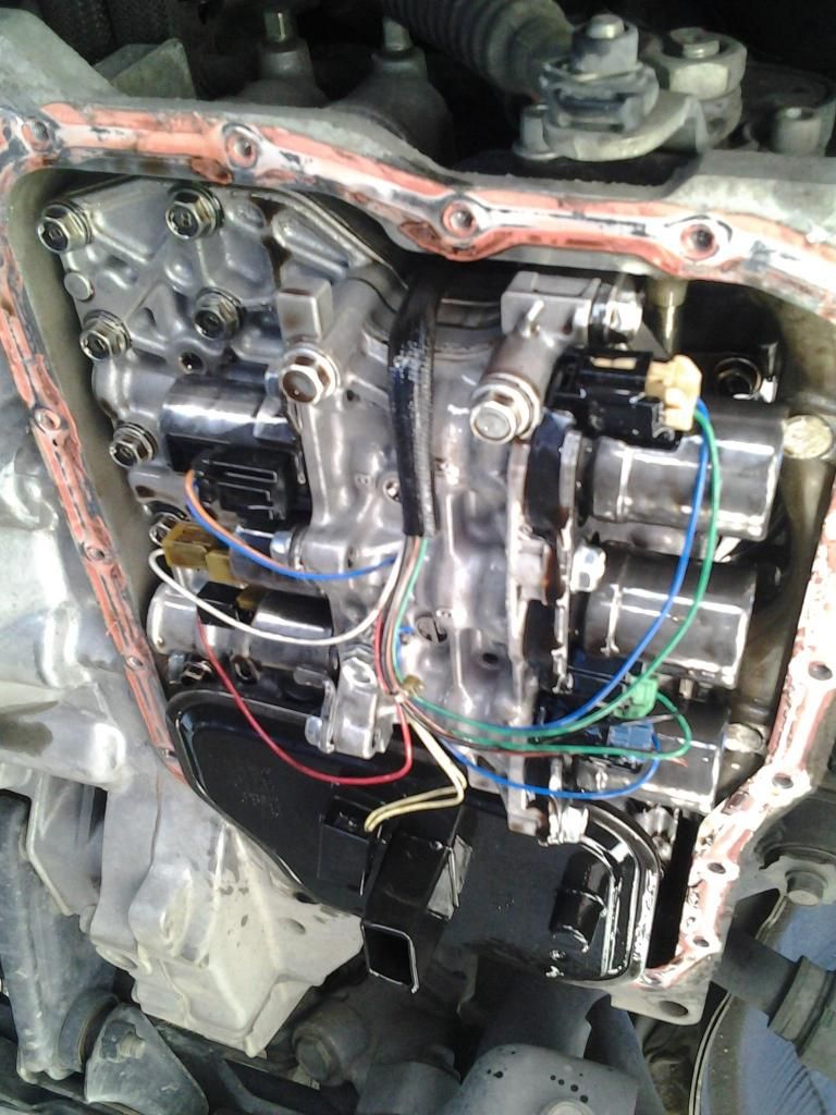

According to the transmission supply place I got the parts from, the two smaller solenoids should give a resistance reading of about 4.5 ohms and the three larger ones should be in the range of 20-30 ohms.
I got 25 on E, 32 on D for the two small ones, 30 on the pressure control solenoid, A, and on the shift solenoids A, 10 ohms; B, 9 ohms; and C, 7 ohms.
These all are fairly consistent with each other, so I am hoping that I don't have any issues. I am going to try just changing the fluid and filter for now and see what happens.

Ack. It didn't work. This attempt only lasted one day, so I swapped out solenoid B and gave it a new round of fluid. The new fluid I drained out didn't even have 10 miles on it, but it came out nearly as dark as the stuff before. I didn't flush the whole system, so it was mixed with old fluid that was still in the torque converter.
But, even changing Solenoid B didn't do anything. I changed it out yesterday and I didn't get 5 miles before the AT and ENG lights kicked back on.

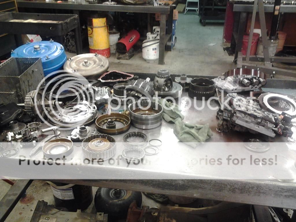

They pulled the tranny and tore it apart today, and they were fully expecting burned/broken parts. I bet you (Aaron) are going to think, 'well duh' on this one ;) , but given my symptoms and description they found nothing wrong visibly. Well, I'm hoping it wan't a waste of time or money at this point, but he proceeds to inform me that with that amount of particulates it is more than likely the torque converter. It's all apart anyway, so I'm having them rebuild it instead of dump the old parts back in. At this point, I may as well.
Continuing on, further research by them indicates that either there is a short to the TCM or the TCM itself is bad. (transmission control module). I'll have them replace that while they are at it.
Hopefully the problem will be repaired through all of this, otherwise, as Dave Ramsey likes to say, it will have to go down in the books as 'Stupid Tax'
Here it is all torn apart, if you are interested.
Sorry I didn't get that to you sooner.
FYI - the PCM (next to the battery) is the ECM/TCM. It will require programming to work with your vehicle and instrument gauges. A WDS is required.
Metal particles from a torque converter? I guess it's possible. Though you will have new internals, electrical testing is likely still in order. Hope they give you a good warranty.
