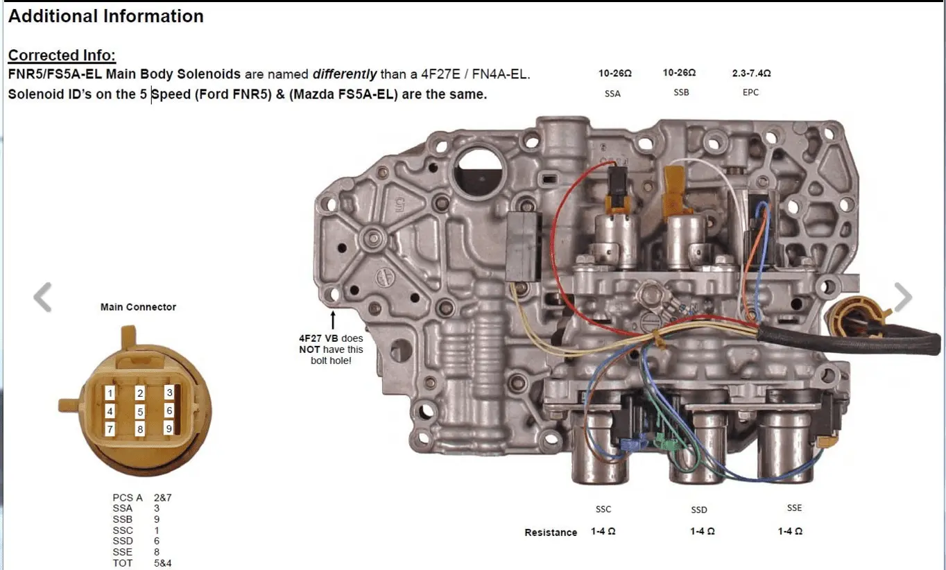

valve Body diagram.

Does anyone have any diagrams showing which solenoid would be regulated by shift sensor B, and where that sensor would even be?
Also, how can I tell exactly which transmission I have?
