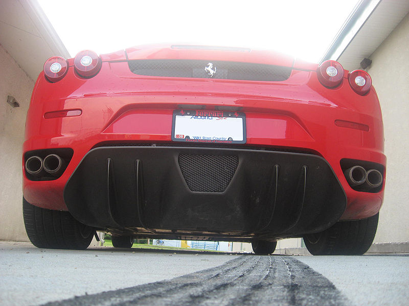

If you take a look at the way Ferrari builds their diffusers, they will look fairly similar to the one I have in mind.
Notice a trend?
Yet another example of an upwards sloping design.
By leaving the majority of the stock bumper, your trapping air and creating a parachute effect in addition to not getting the full benefit of the diffusers own effect on smoothing out airflow and merging air streams with the air coming from the top of the vehicle.
