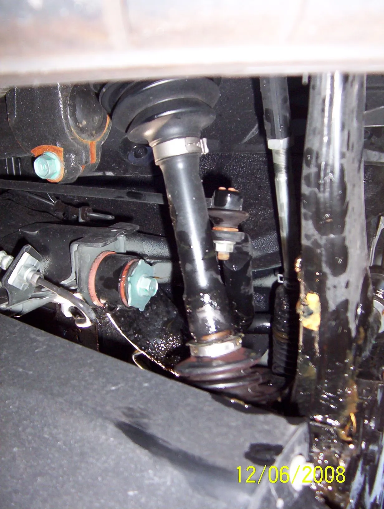

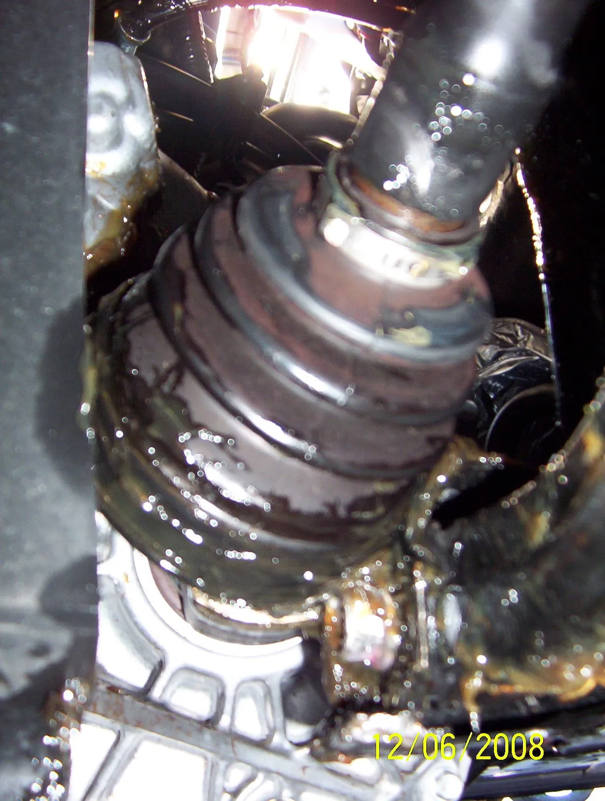

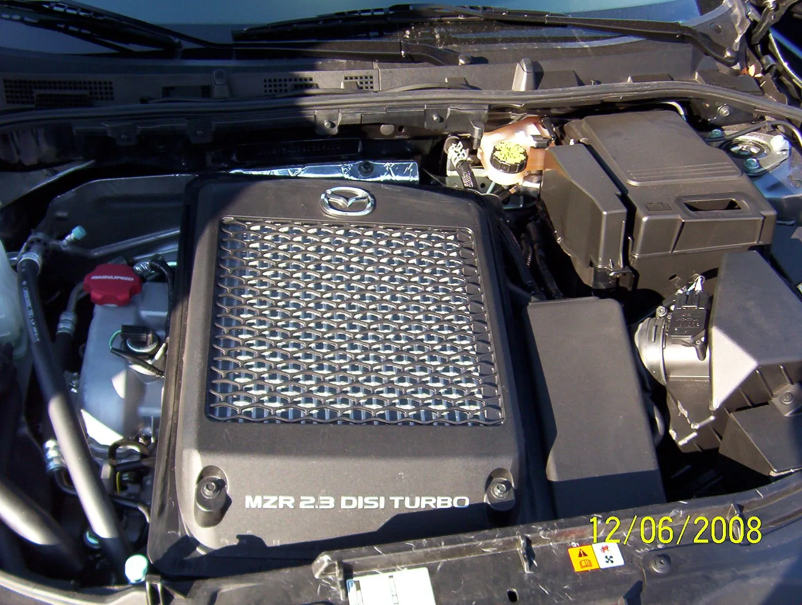

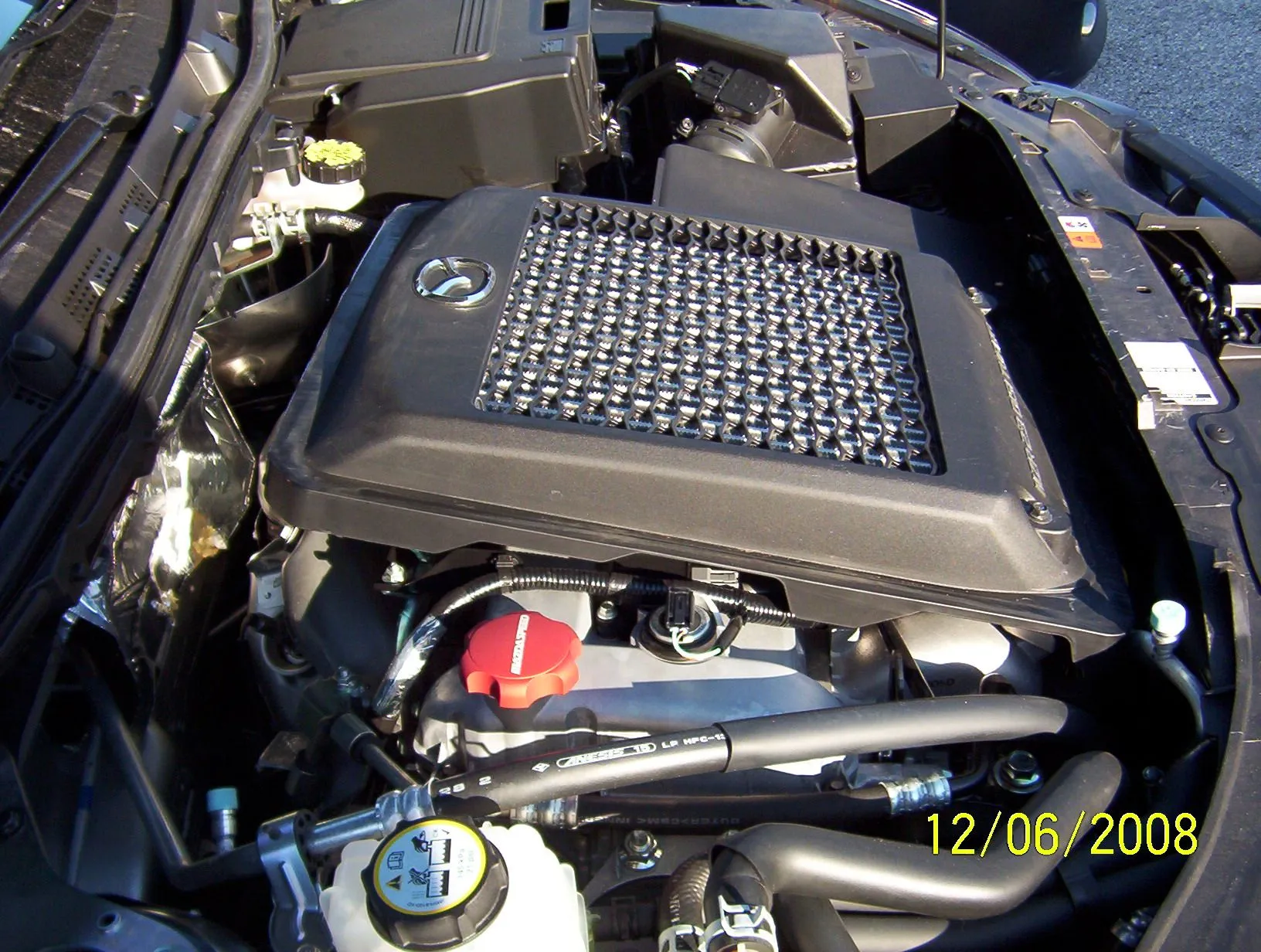

engine mount failure
I had 08 speed 3 sport put 8,000 miles no problem, traded it in for a 09 speed 3 GT now 1,300 miles later my motor mount failed

Damn, I'm keeping my 08 then... (lol2)
That totally sucks donkey balls... I can't believe that...
Why did you trade your 08 for a 09?
wow that is horse s***....engines are falling like crazy...makes me not want to modify my speed 3 :(
