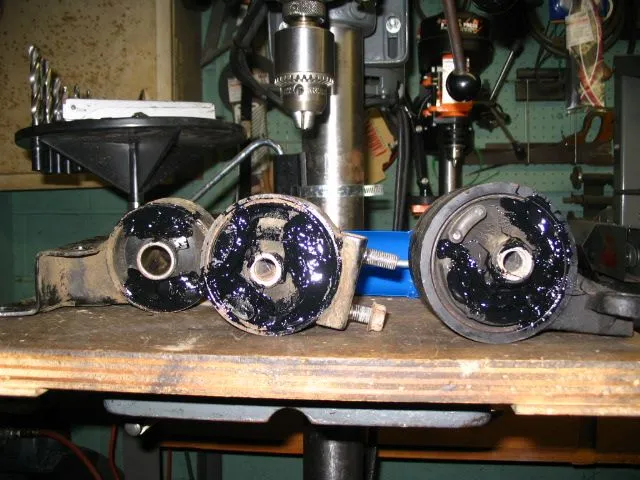

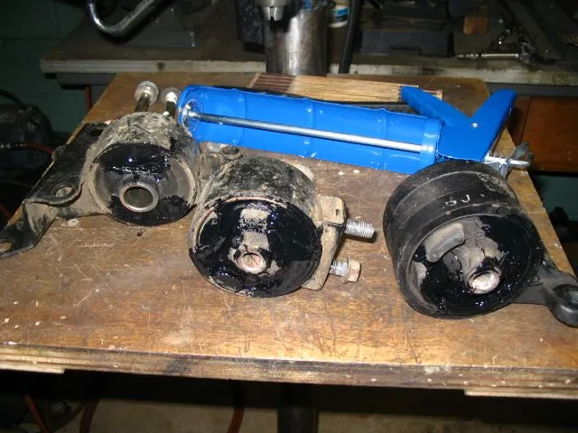

I picked up the motor mounts today. I'll be "window welding" them tomorrow and letting them cure while I get the 1.8L removed from the car. I'll try and get some updated pictures once I have things moving in the right direction.
Wino-Weld FTW!
Are they stock or after market?

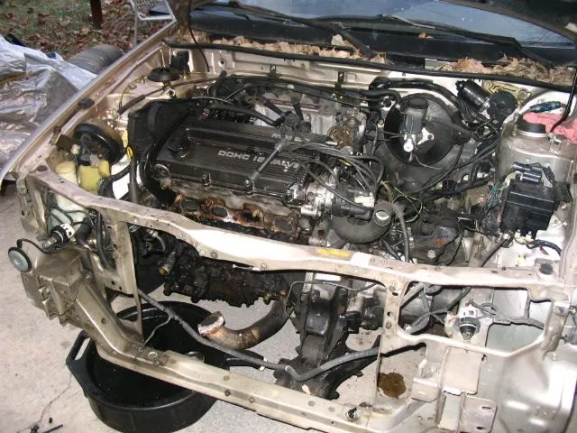

Finally, some progress. I started today by getting the front of the car dismantled and throwing away most of the A/C system. I discovered that the person I bought the car from cut holes in the radiator support for the intercooler pipes to route through. I'll need to get some metal in there and weld those up to stay legal. I'll probably just cut out the whole section and rob a good one from a salvage car. That will make it a lot easier to weld in. I swapped out the throttle cables from the 3rd gen to the '94 model and I'm happy to say it matches up perfectly. The peal end of the cable is exactly the same, but the I needed the much shorter 3rd gen cable to work with the FS motor. I also window welded the 3 salvage mounts I got. I still need to do the rear mount, but I have to get the motor out before I can get to it. Hopefully I can get the motor out tomorrow. I slept in and got a late start today.
