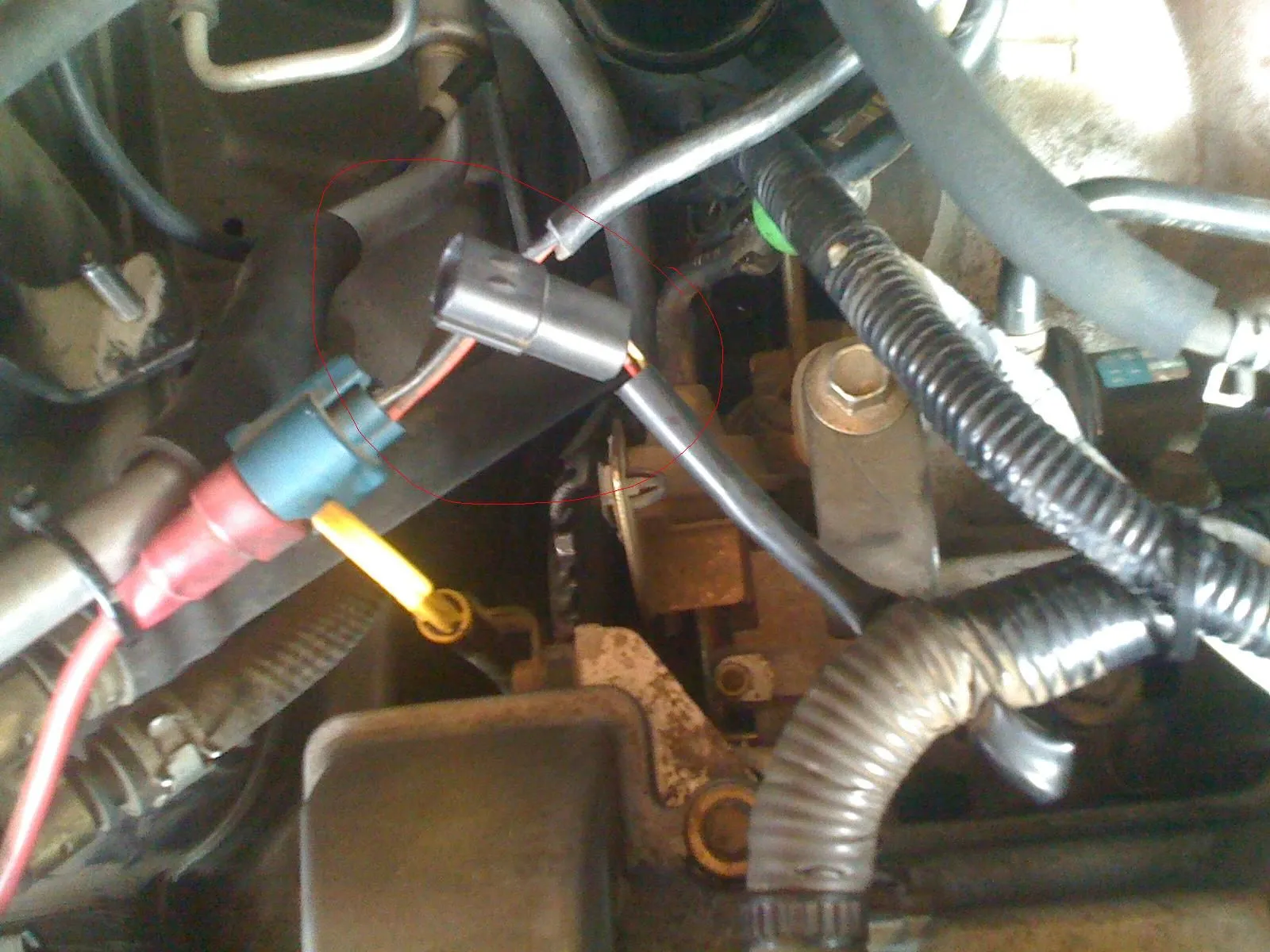

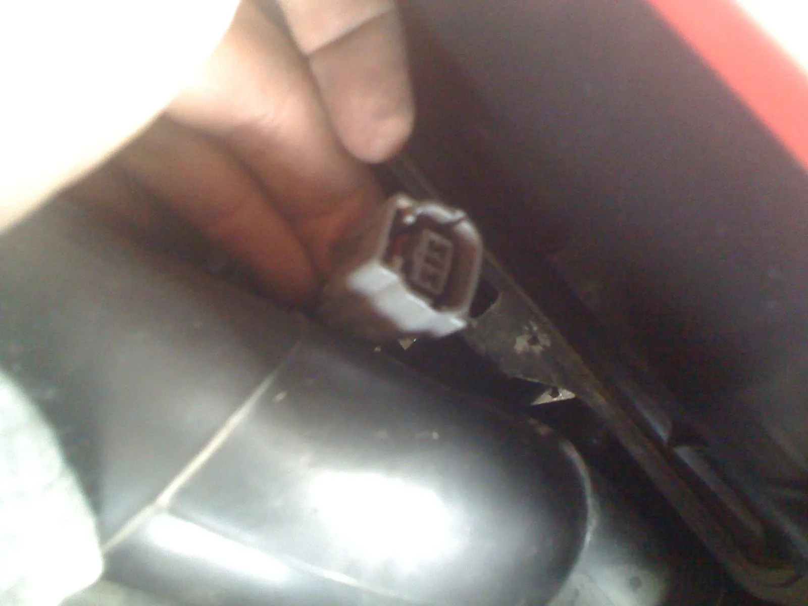

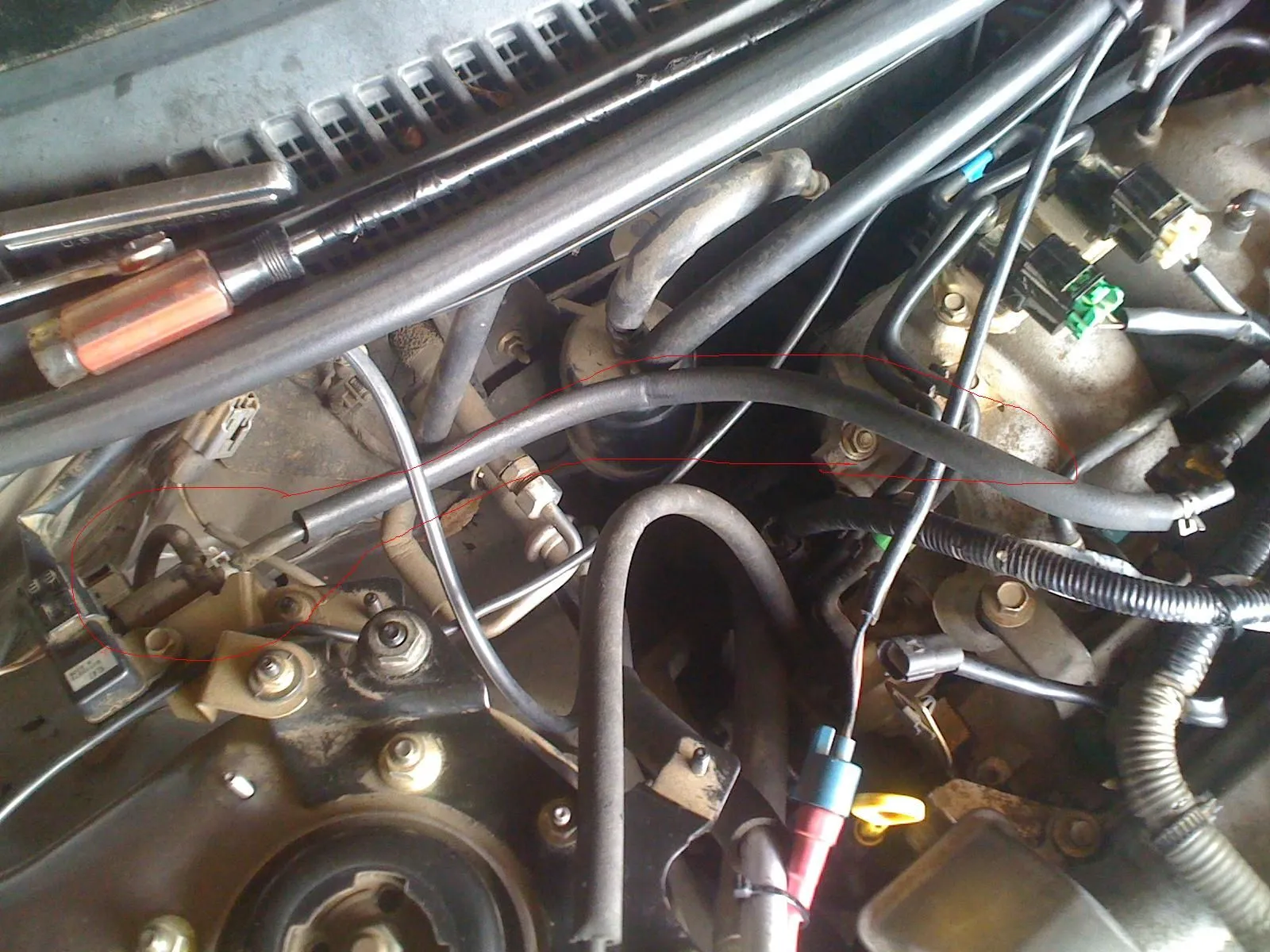

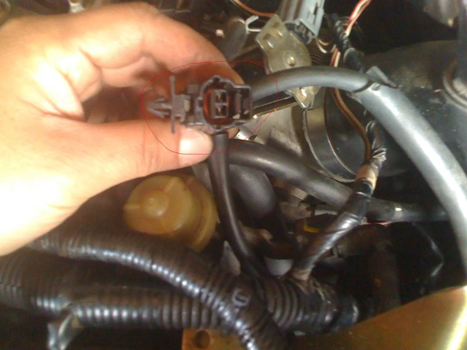

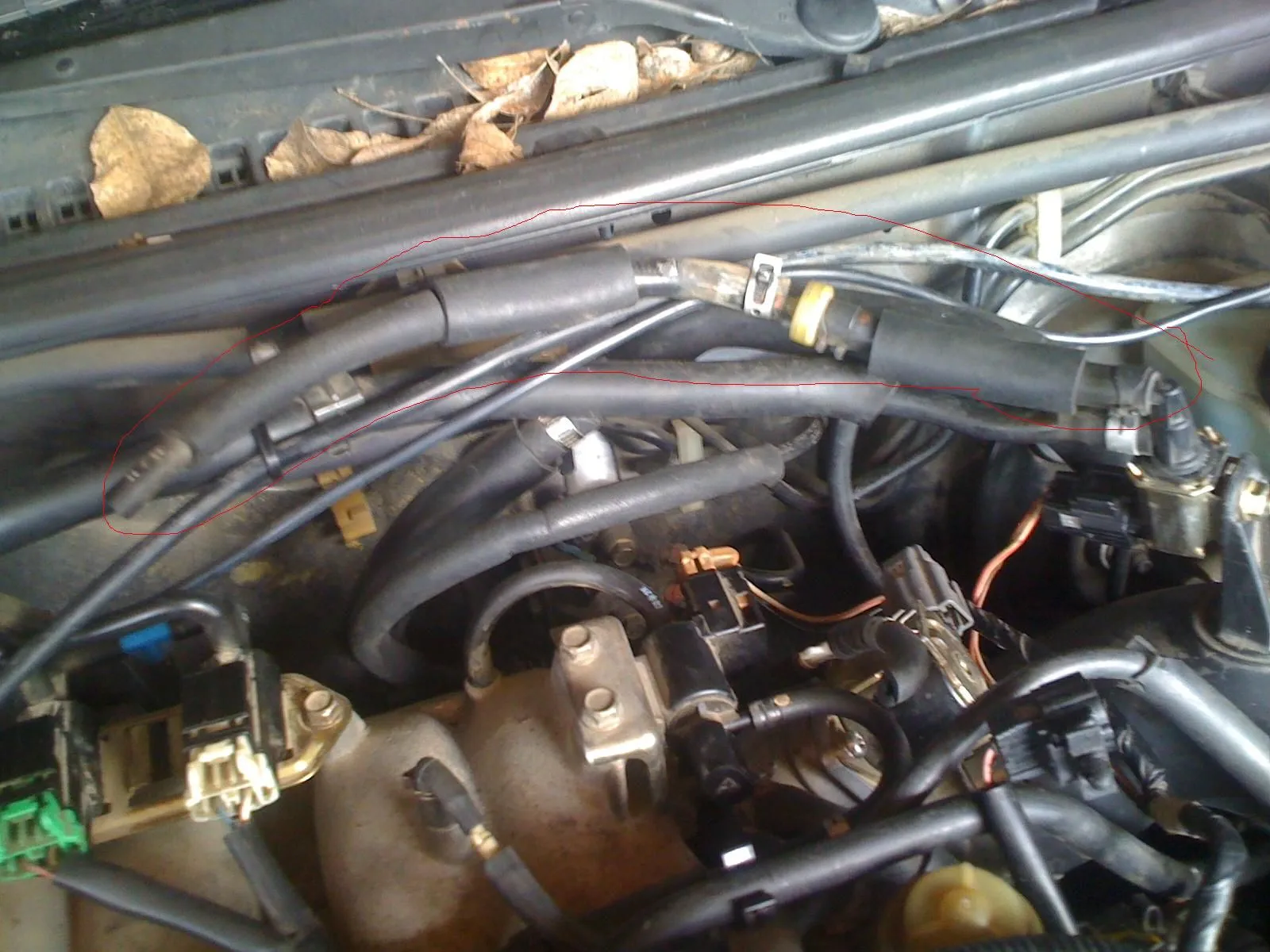

I did the motor swap and not sure where these vacuum hoses and connectors go to if anyone knows please help. The car starts up but the vacuum is around 5-10.

Vac lines run to the evap canister on the firewall and the plug may be for the EGR.
I may just have to unplug the connectors and redo them cuz I'm not sure why I'm missing some.

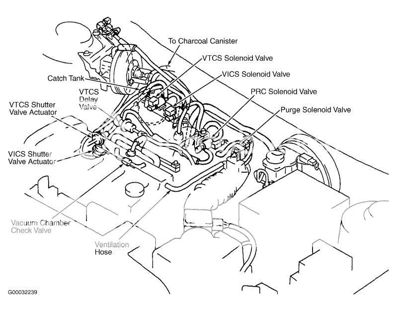

Does anyone have a msp vacuum hose diagram?
ok got the hose on pic# 4 figured out. Need to find the rest.

Vacuum diagram is on the underside of the hood. Pic 4 hose goes to the intake mani, the hose in pic 3 goes to the front port on the little black canister on the passenger side of the firewall. The hose that is in the canister may be from the brake booster and that should go on a port on the back of the intake mani in the center. The connector that bolts to the cold pipe by the throttle body is mounted upside down.
Hey, stupid question, but - is the PRC solenoid valve outlet that points to the front of the car simply capped off? Thanks for any input anyone can provide.
