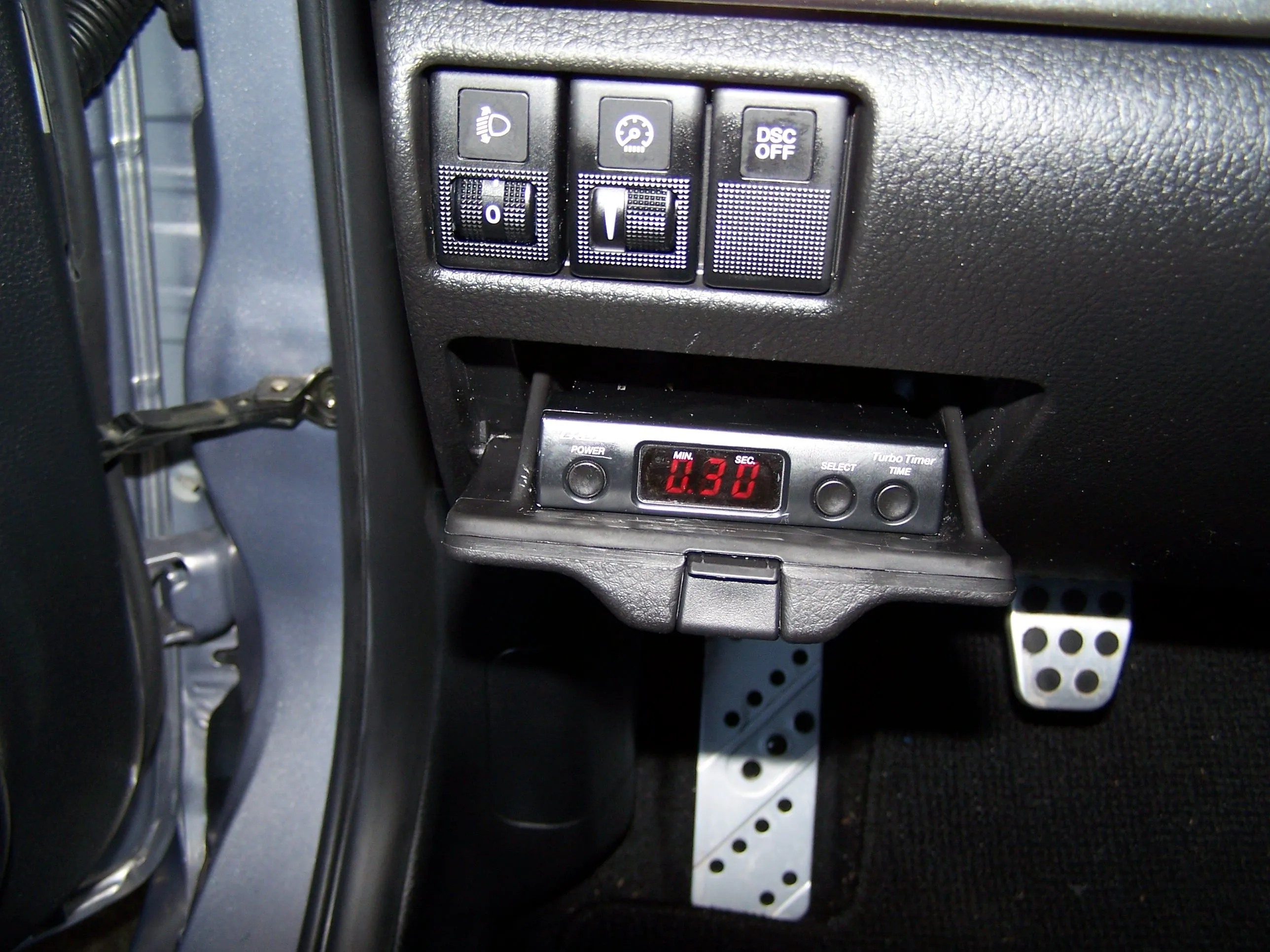

Hi everybody thanks to MS64meplease for the wiring instructions. I put the turbo timer on my car on monday and here is a photo. I tried to put it in the 12v drawer but I cant take out the hand brake console so I do it here.
That is where I have mine also LOL
