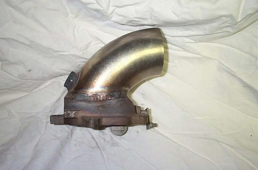

So as you said spend the 150 bones and add an O2 bung yourself. Now if your talking about a 'housing'--> that has to be added to the flange itself vs the bung itself that is something different.
IF their stock 5 bolt flange does not have a spot for an O2 all it takes is adding one. So show me a stock EVO or STI or one of the Speed6's stock flanges vs your titek piece. BTW the pictured flange is from 40bob.com and the stock 5 bolt flange is from an SVO he just adjusts them into a 3 inch. They do have the O2 spot in them.
