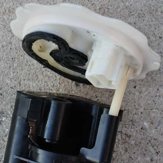

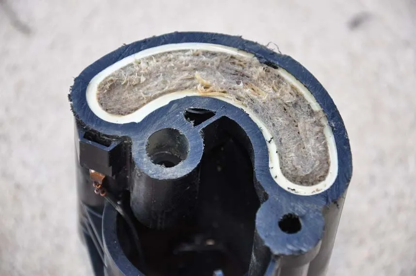

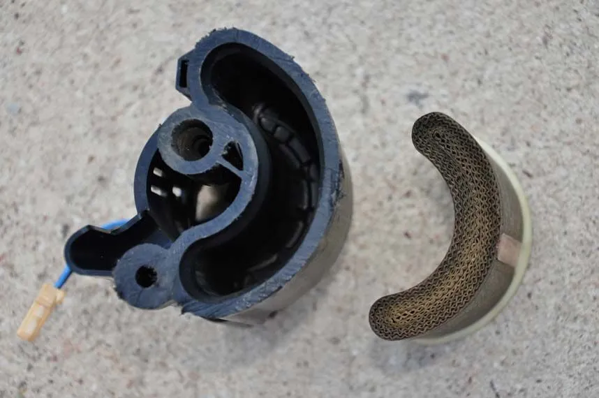

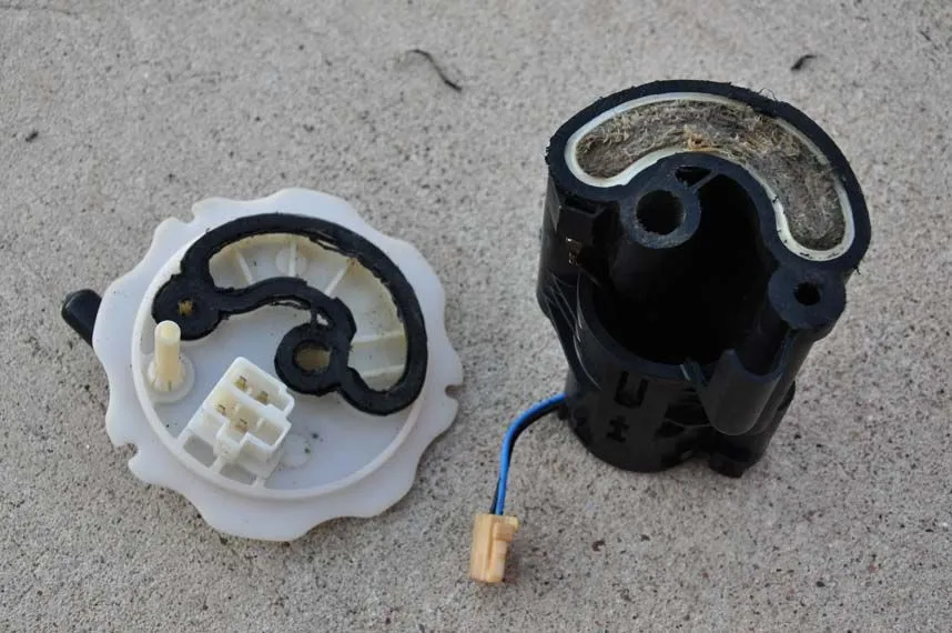

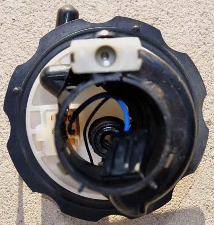

I just happened to have a bad fuel pump unit off an MSP with 180k on it... so I cut one up so I can prove to you n00bs that we do have a fuel filter and you can all stop spreading the myth that there isn't one
pictures are worth a thousand words

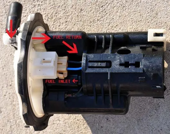

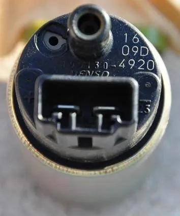

our fuel pumps are made by denso... the denso part number printed on it is 195130-4920... will be nice if someone figures out a higher performing denso pump that fits into the housing without going for a walbro... this same fuel pump is also used on the LW MPV (the 2nd gen) so it can flow plenty since the van has a big V6 engine in it!

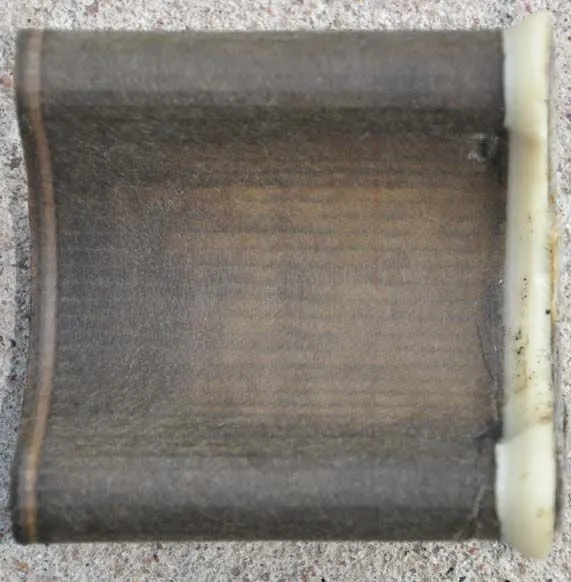

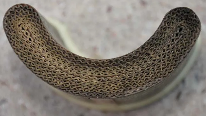

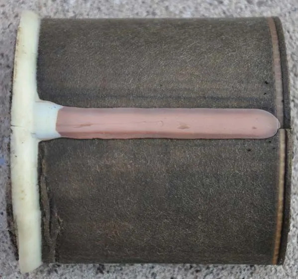

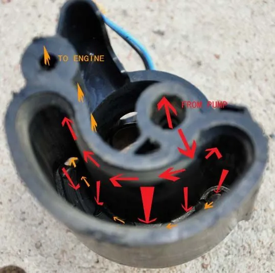

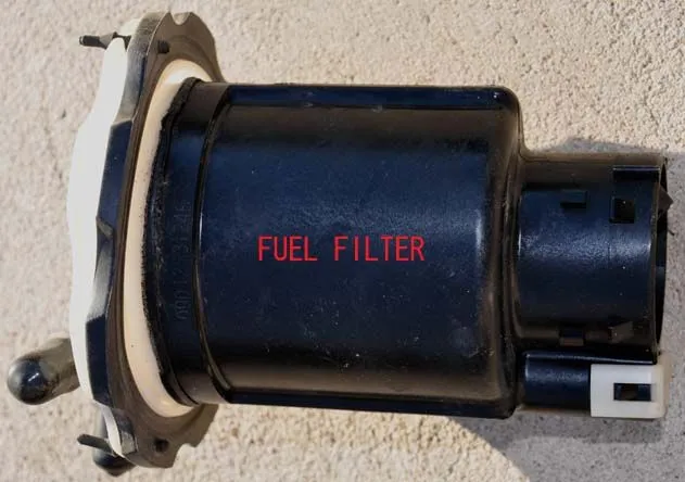

heres what the filter really looks like and how it flows
so if you DON'T replace this at 100k or when replacing any fuel pump, you WILL break the new pump and VOID the warranty

I don't suppose you have a part number for that filter do you? Or a way to replace it without cutting off the top of the fuel pump assembly? ;)
Where is the MSP Fuel filter / Fuel Pump Combo located?
Yup; you access it from a panel under the rear seat.
Having said that, how the heck would not replacing a "filter" aka "screen" break a fuel pump??
ah sh1t... lol.. yeah i was wondering about that... thx
