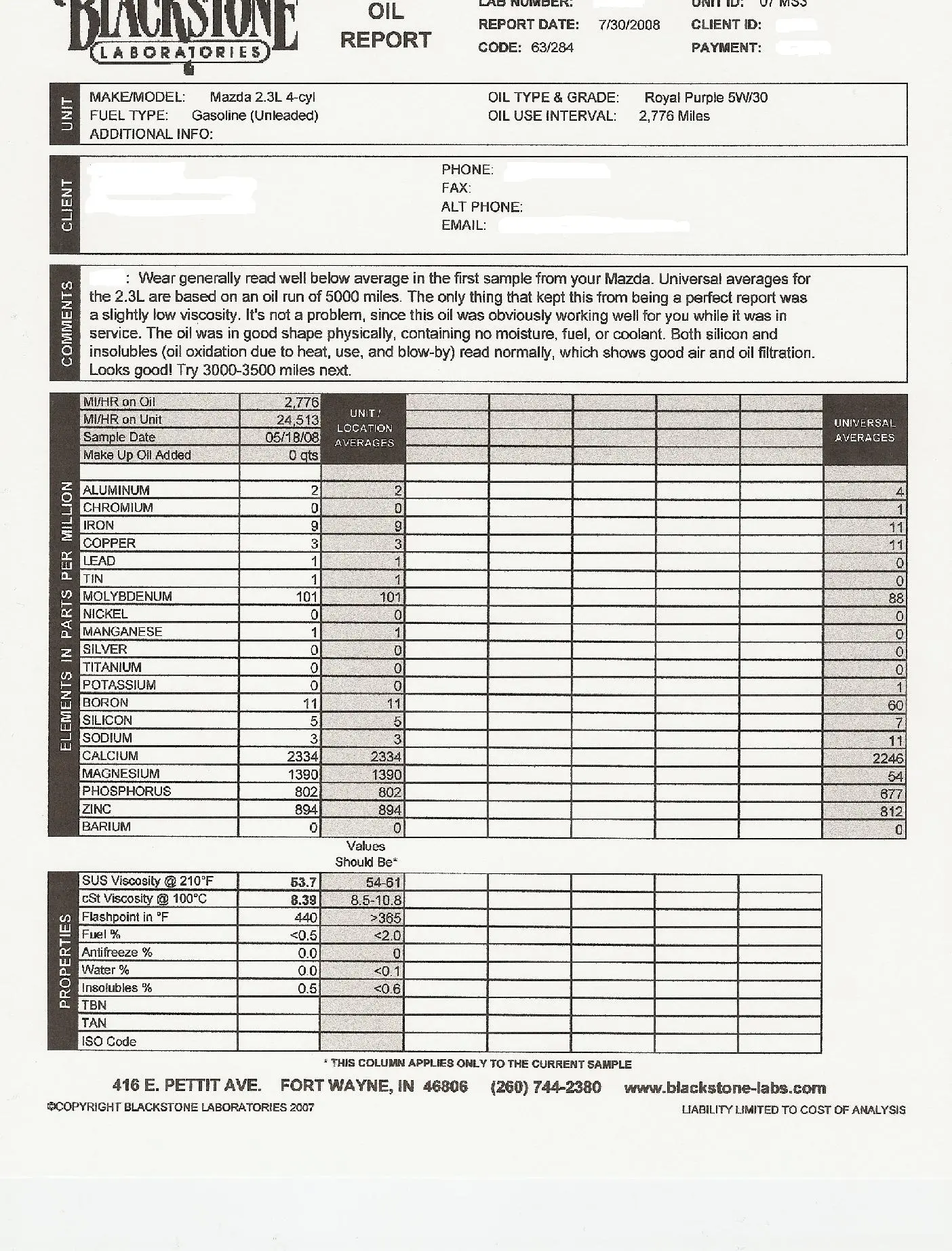

I use Royal Purple 5W30. I change my oil every 3000 miles, actually I always change it before so I don't go over. It's a little over the top, but I love my car, and if I have learned anything from being a helicopter mechanic it's that preventative maintenance is the key to keep something performing it's best for a long time. Here is a UOA I had done recently.
