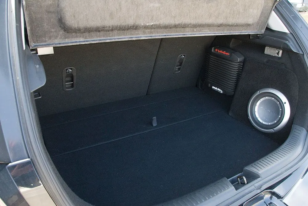

Here's a picture of mine. Rockford Fosgate Punch 60 amp w/8" RF Punch sub in a custom enclosure. Granted the amp just powers my sub but I imagine you could easily power the rest of your speakers. Mounting the amp on the side of the cargo area really doesn't take up any space, plus it really helps keeping it cool! I've never had problems shoving things in the back of the car and wishing that the amp wasn't there so I'd have more room. Just giving you more ideas...
