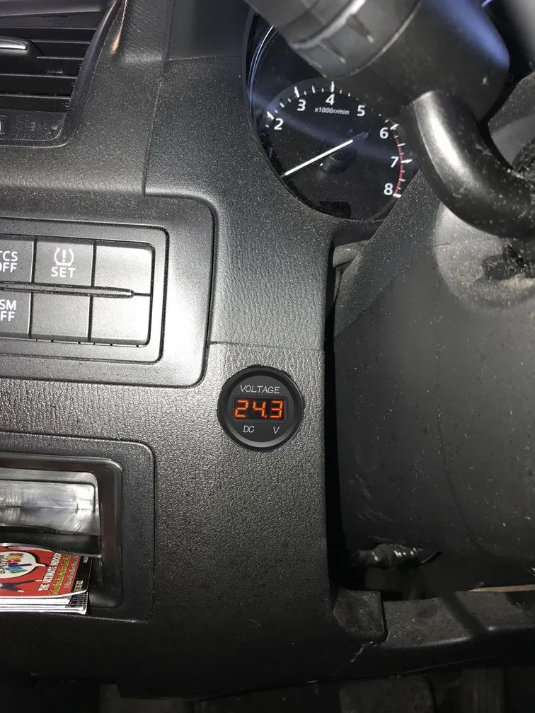

I think I’m going to mount it on the plastic piece below the steering wheel on the left side so it close to the fuse panel and kinda out of the way.

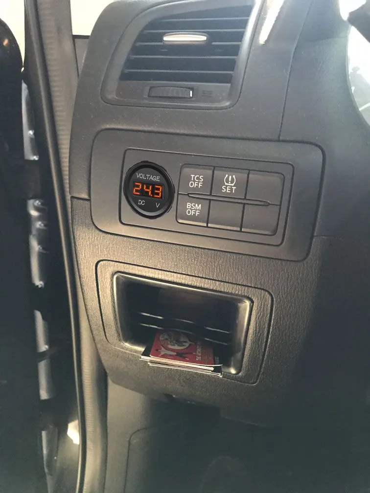

I haven't mounted it yet, here are two options I'm considering. Check out these mockups and let me know what you think. I like opition 1 best I just don't know whats behind that panel and if I can mount it there, but I know I can mount it in location 2 100%.

So I took the plunge and I install the voltmeter today I ended up installing it on the panel with the Blindspot monitoring and the tire pressure monitoring buttons like I showed in mock up option one earlier in this thread. Once I popped the modular out it was a little intimidating because it had a bunch of different pieces that I needed to take apart and there was a little computer board in there with buttons on there but I knew this is where I wanted to put it and wasn’t a hundred percent sure it was gonna pan out but I just dove in and did it. First I drilled a hole, then I used a Dremel to continuously dremel out the hole bigger and bigger and bigger testing the fit every step of the way I did have to Dremel out a lot of the little tabs and round off a lot of edges inside the module box but luckily because there’s no buttons on that side it was pretty much just empty space. Originally I used gonna use wire connectors to connect to the terminals on the voltmeter but they took up too much space inside that little module box so I had to just wire them directly to the tabs and put some electrical tape keep them secured. Tested to make sure everything works before I permanently put it into the module box. Then fish the wire through the dash snapped it in, ground it under the dash by the fuse panel wiretapped off the cigarette lighter fuse smooth sailing works great.
