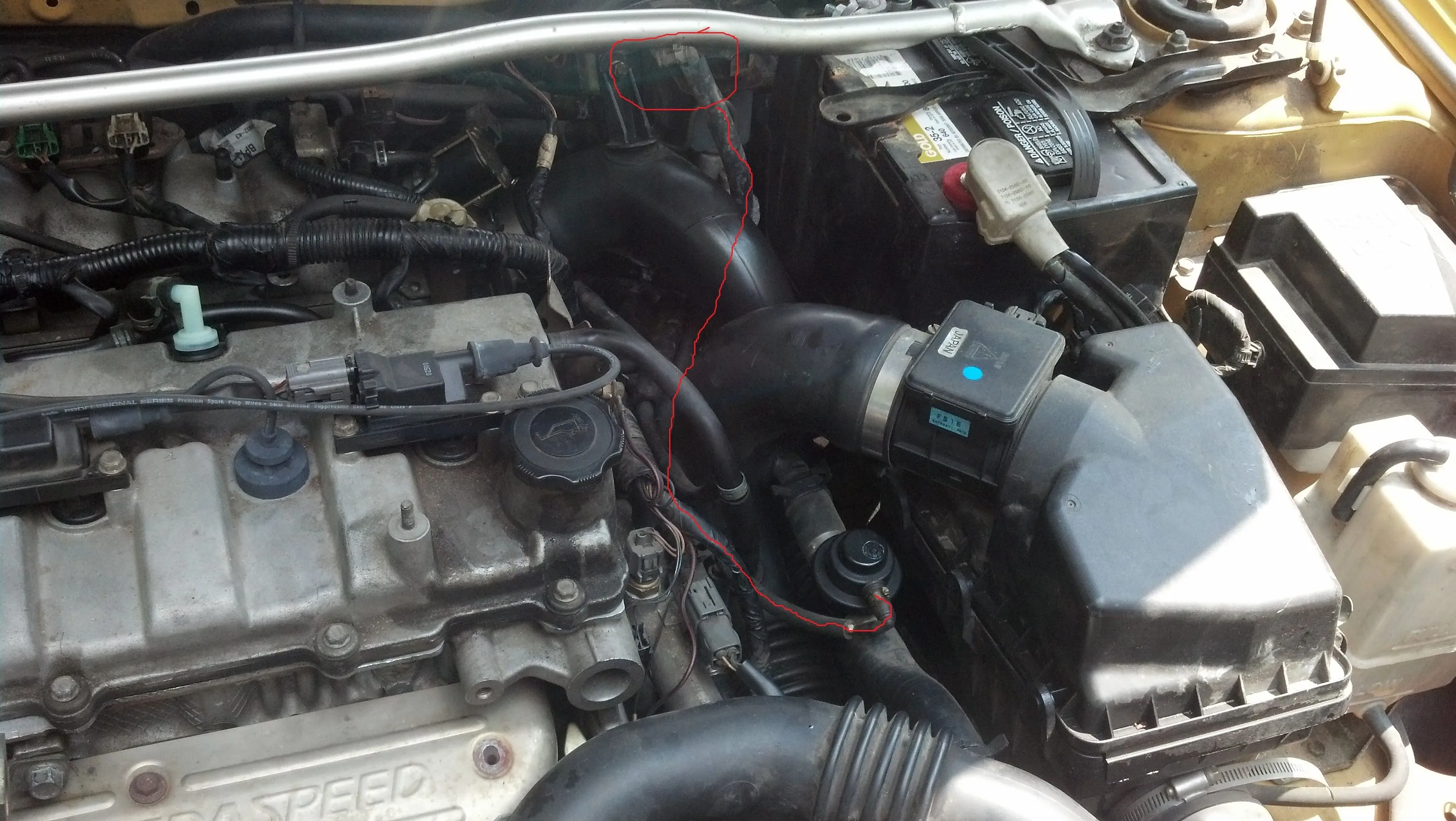

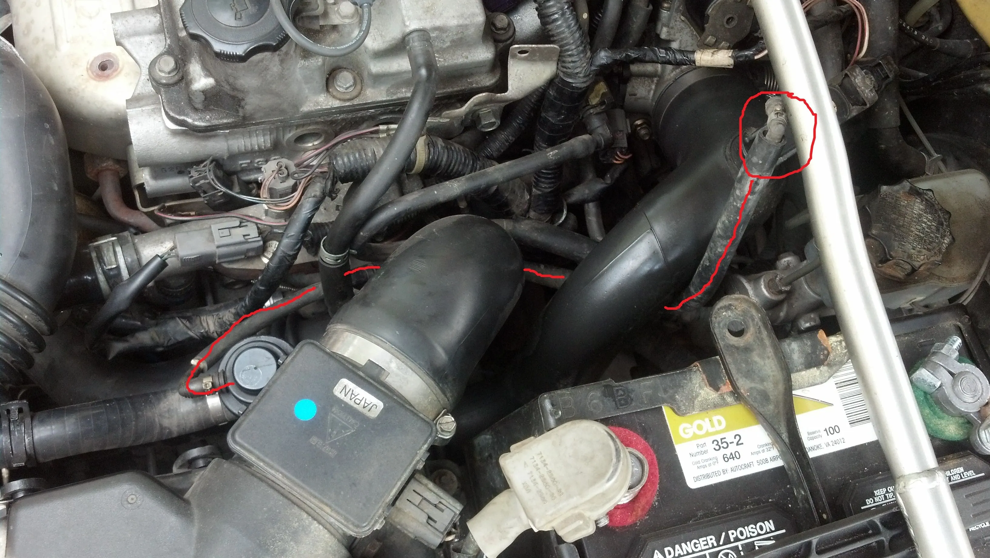

Hey guys, I've been tracking down what I had expected to be a vacuum leak for a couple weeks now. I've finally fond it but I don't know where it goes. I tried searching and looking at the shop manuals but couldn't find anything. Any help would be appreciated!

there should be a vacuum line that goes form the motor to the turbo that has a t fitting in itthat that plugs into. if not it needs to go to a vacuum source on the motor seeing how that goes to your bpv to relieve boost pressure.
From the picture it looks like you have a rubber cap on the port it connects to on the intake manifold.
