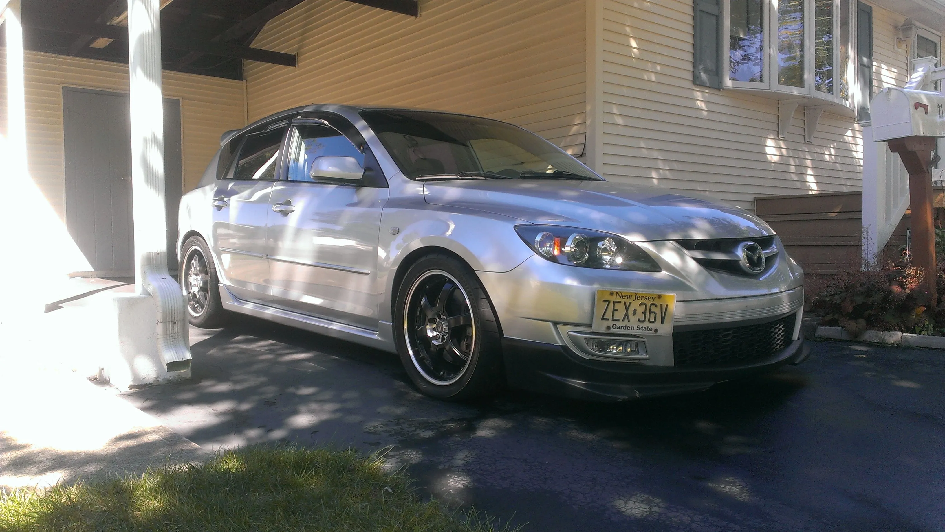

my ride while the six gets the new rear diff mounts installed
